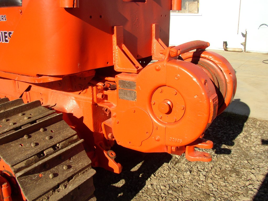

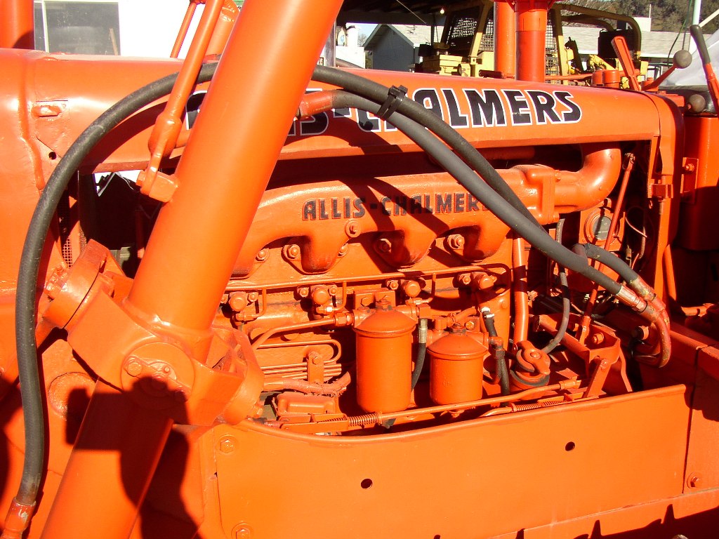

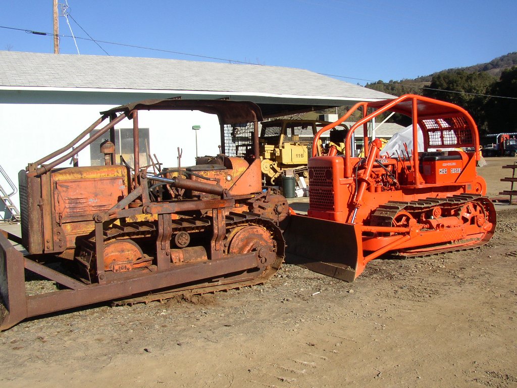

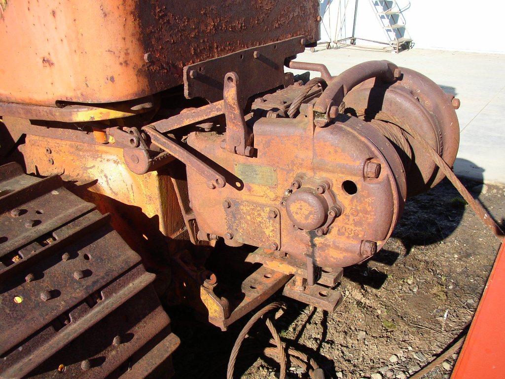

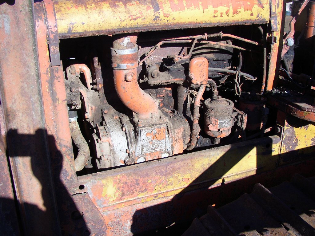

 Ok guys, Thought we should post up some pictures of the HD5 before it goes under the restoration wrenches. So the quiz is what are all the differences between the HD5 and 6??. Please feel free to post at will,early and often.

obvious differences in your photos and machines in general HD5 has detroit 2-71 and carco model E winch.  HD6 is a early one with Buda design HD344 engine and carco E24 winch. Winchs ccould be swapped early to late vice versa etc E24 was replacement for E and then later E30 winch replaced E24. HD6 has heavier and longer front chassis rails than a HD5 to accomodate the motor. Back ends are the same up until HD6 13390 when the steering clutch plates were changed to bronze from raybestos; and final drive shaft splines changed too. HD344 was replaced with the 6000 motor at 13322 also hydraulic pump, tank and valve were combined here and a oil master clutch became a option a bit later. Then wet backend E and EP models after 14484.

The radiator and radiator guard are different. The HD6 has a front bumper. Minor but different.

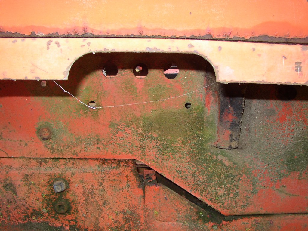

Great job guys, everyone who has taken the quiz certainly has A+. It looks like we can make copies and keep with service/parts manual for reference. This is better than some of the AC service bulletins that we have. So this picture is of the cutout in the HD5 fenders, they line up with 3 holes on each side, They are on fenders of both models,5, 5Gs, can't find anything in the parts or service manual as to there purpose, this is for extra quiz points. Anyone know? Coke you out there?

Those holes are to run fuel or oil hoses through if you want to fit or have factory fitted heavy duty AC oil and fuel filters.
My Dad's HD6E S/N12885 had both filters on it originally now just the engine oil filter. The big heavy duty filters were mounted on fender extenders and AC even made a bolt on guard to protect the hoses where they passed under the fender and into the filter.
I will try to attach pictures -- haven't done it before, might need some guidance.
Real early HD6's had fenders like on the 5's even with the cut out on the folded down edges.
