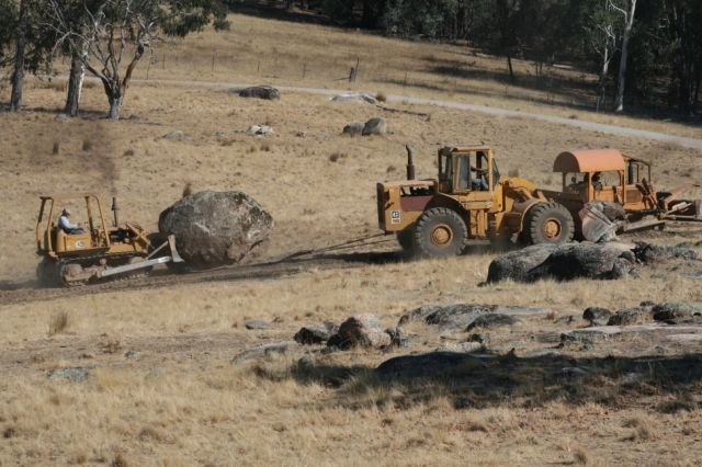

Here is my first forum picture, hope it comes out alright, this shot was taken in Feb' last year when we were dragging rocks in place for our new workshop retaining wall. The rock which we guess weighs over 30 tons is on a steel sled getting dragged by a 966C and a HD6EP plus getting some "push" help from another HD6EP.

Nice pic, AusHD6. That's a mighty big rock ya got there. Smile
