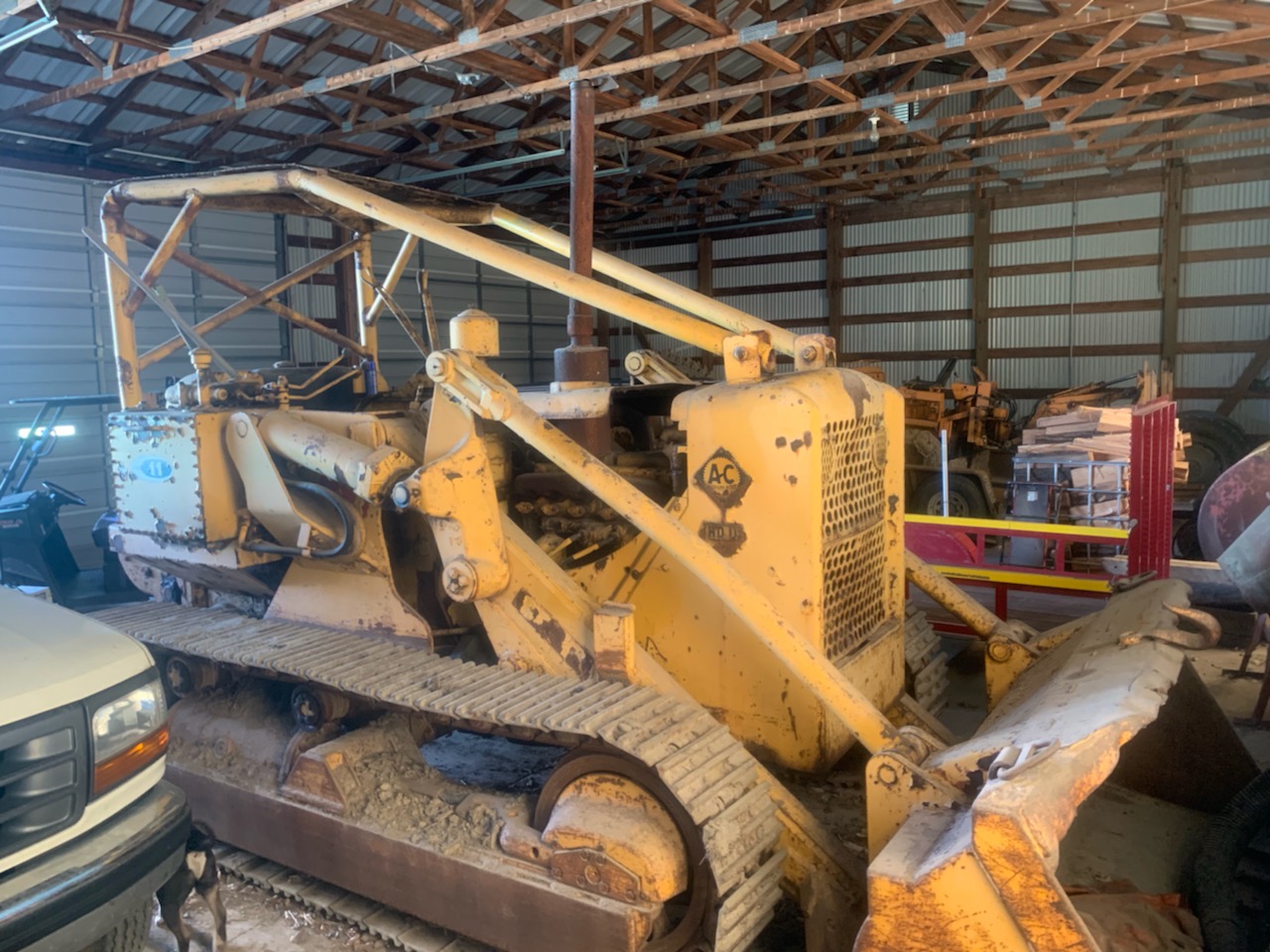

Going to look at one maybe. No rops or cage,winch, has the ovel 11 decal on the side of the operators station and on rear. Diamond AC emblem on radiator cover. Inside. Has ran this year.Undercarriage looks good from picture but. Is there anything to watch out for on these out of the ordinary?

For some reason your pics aren't showing up for me. I did go look at the machine today. The undercarriage is nice some bushing wear but far from shot. The rails also weren't bad,sprockets and so on. Loader pins all tight,controls were free and it was and has been inside. I looked closely at the area behind the sprockets an saw nothing goonied up,welded,wallowed out or out of the ordinary at all. Didn't see anything that looked like 15/16" bolt heads either. Winch was tidy. I dunno. It will do what I want it to. If it will stay together. It's the size I wanted.
