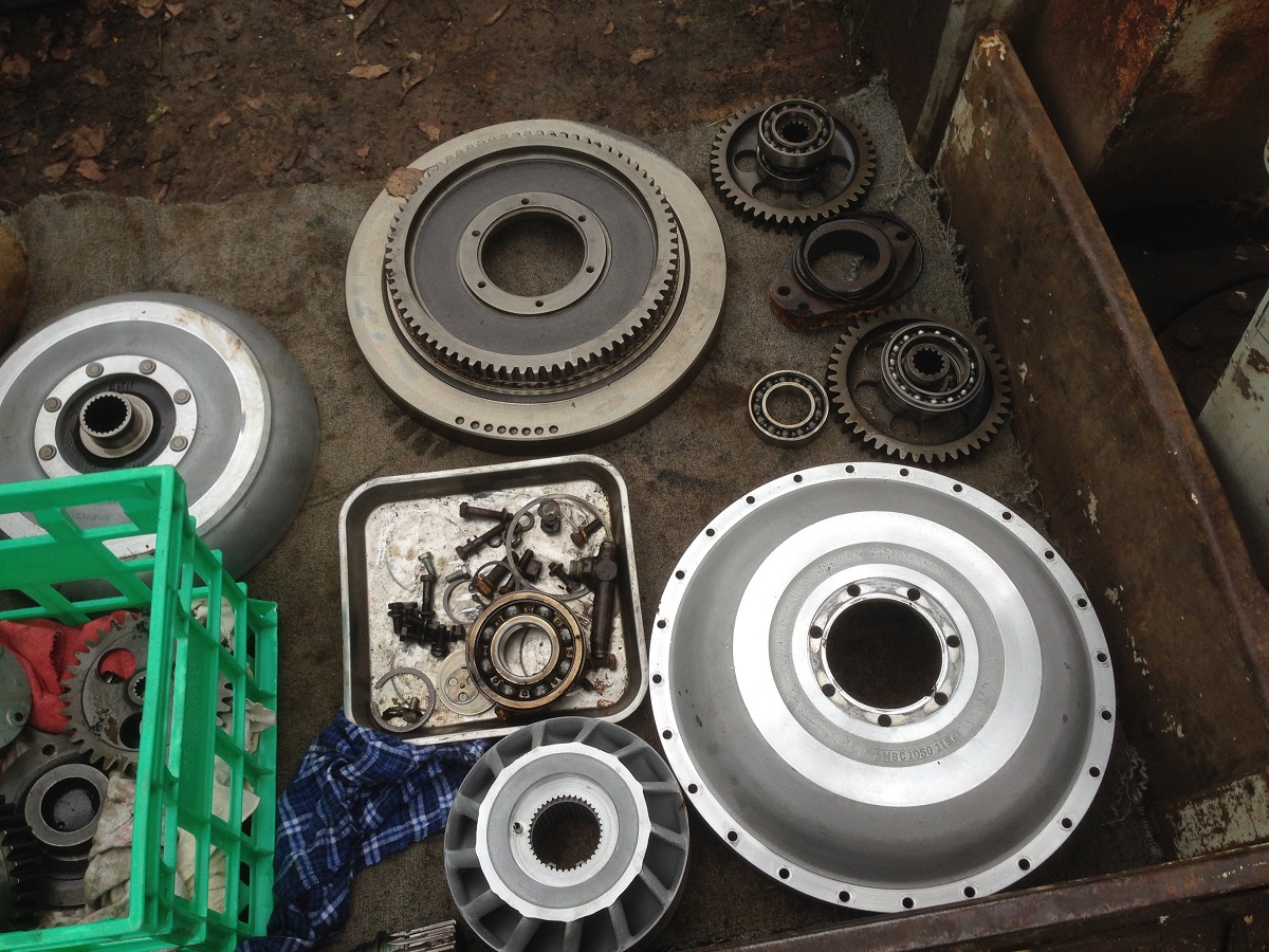

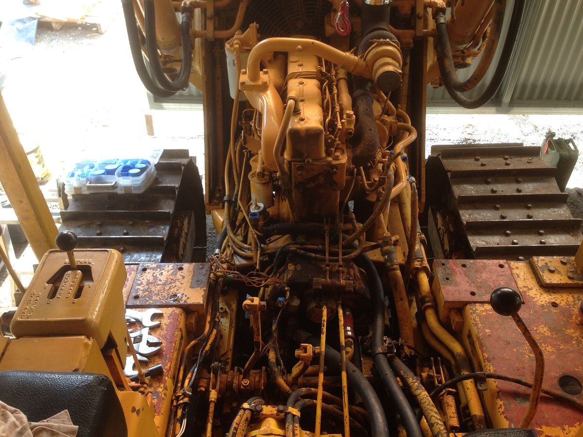

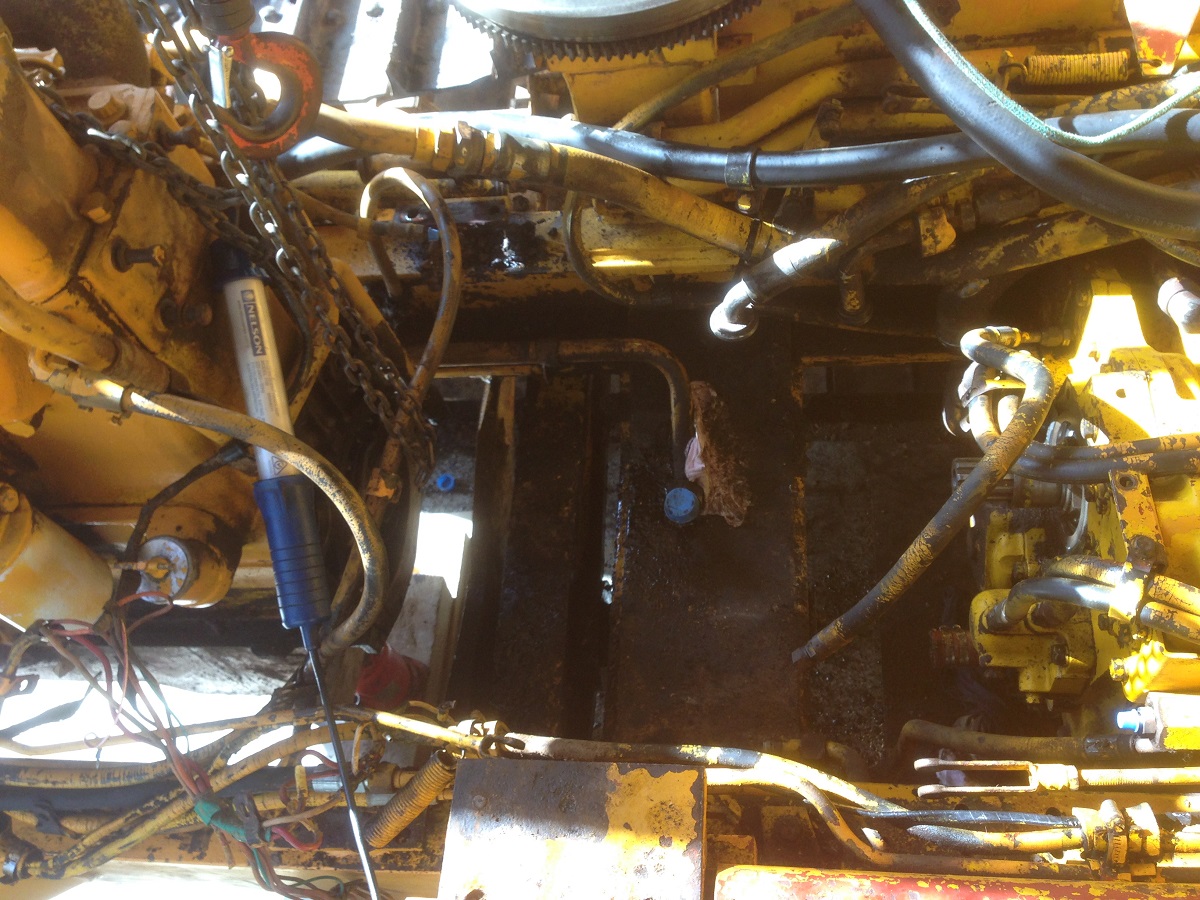

I have been pulling down the 11B for torque a convertor rebuild, four big days so far with lots of pipes and bits and pieces to remove now I have found out that the input shaft in the trans is shot so that will have to come out after hopefully finishing a job then bring it home and start pulling it all apart again to fix that.

G'day Lazyts the splines on the shaft on the convertor and the coupling were badly worn and it looks like the drive shaft has come out at some stage and smacked the hydraulic pump a few times before I bought it , I was worried it might happen again and when I had it apart I found that the top shaft in the trans has a lot of wear on the spline I took the plate off for the ground speed governor and I could feel the gear moving on the spline, I have put it back together and am hoping I can finish a windrow job I have then I will pull the whole thing down and go through it front to back
