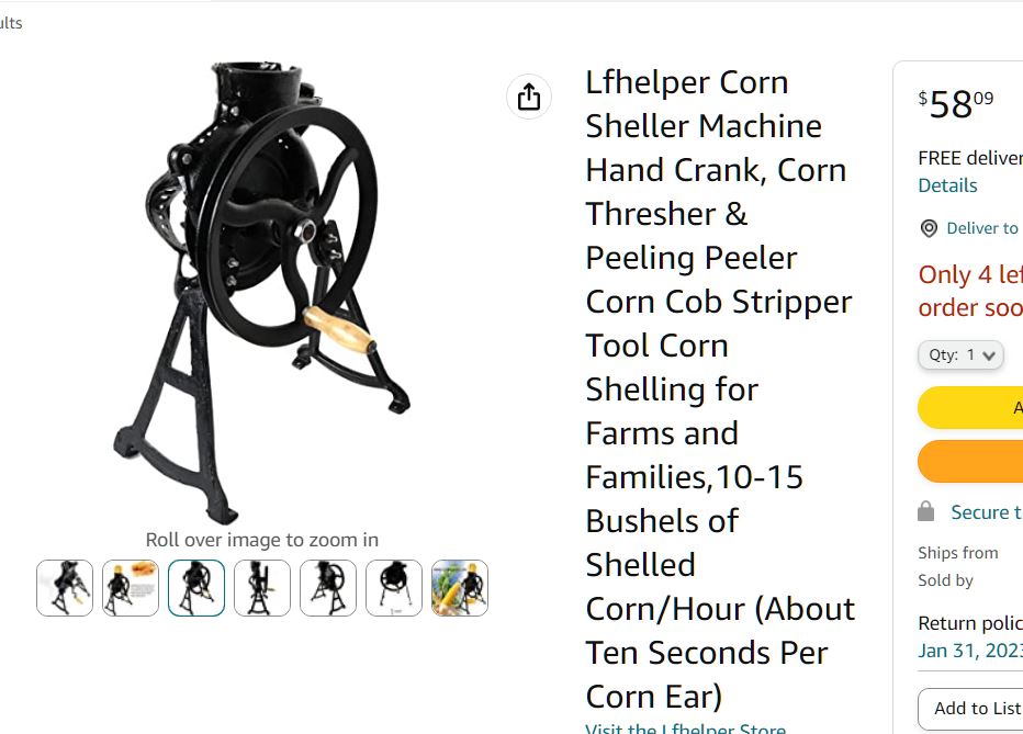

I know a guy that has to get rid of maybe 100 (??) bushels of corn on the cob every year starting now.   Rather than scrap it, he wondered if i want it.. I feed birds and squirrels all year round, so wonder what it would take to shell the corn. I see a small sheller on internet ( several venders, same sheller) for $60- 100.  It is manual crank, but says there is a pulley on the handle to use a small motor.  Im wondering if anyone has used on of these, or has a better idea for shelling.. Im not trying to make money or do it real quick.. He just needs to get rid of it and thought if it dont cost too much, i might make a small project of it.... dont see too many "antiques" for a reasonable price, and not sure if your buying something that is already worn out ?? ......... Ideas ?

Post Options Post Options   Thanks (0) Thanks(0)   Quote shameless dude Quote  Post ReplyReply Direct Link To This Post Posted: 27 Oct 2022 at 9:39pm
that's a tiny sucker, but should do what you want to do with it. if it has a pulley, then it should be easy, but I think I heard Thad say you needed the exercize!  the old ones bring $500-$1500 each on sales.

Post Options Post Options   Thanks (0) Thanks(0)   Quote steve(ill) Quote  Post ReplyReply Direct Link To This Post Posted: 27 Oct 2022 at 10:05pm
Well, its not my ARMS that need the exercise !!  Wink  ............ yea, i dont need an ANTIQUE Expensive one... just something that works. All of the "NEW" ones seem to be the same thing with 10 different names.. Probably all come from the same China factory.

Post Options Post Options   Thanks (0) Thanks(0)   Quote DiyDave Quote  Post ReplyReply Direct Link To This Post Posted: 28 Oct 2022 at 4:45am
They work pretty good, specially if they're free!.  It doesn't take much to find one in an old barn, or at a local auction, in farm country I see many going for $10 or less. Granted, you'd have to scrounge a pulley...  Then there's thisLOL!

Post Options Post Options   Thanks (0) Thanks(0)   Quote ac fleet Quote  Post ReplyReply Direct Link To This Post Posted: 28 Oct 2022 at 10:20am
That will work for your needs, just slow! I bought 2 old ones here for $17. and they are in excellent condition. The trick is finding them!

Post Options Post Options   Thanks (0) Thanks(0)   Quote steve(ill) Quote  Post ReplyReply Direct Link To This Post Posted: 16 Nov 2022 at 4:47pm
well, i bought one of the China units in the original post. Has a 10 inch pulley on it. I have a 1150 rpm motor with a 1.5 inch pulley so i connected it up to see how it works ( did not test manually, maybe i should have...
Figuring the  crank is turning 170 rpm or 3 revolutions per second.. Does not do as good as i expected... does not PULL the cob into the machine... tried to adjust the spring loaded side wall.... dont seem to help a lot... some ears only get 60% of the corn off.... I only tried 12 ears... not a long term test yet.... Corn has been stored in a 55 gallon drum with the husk on it. Just took off today on a dozen ears..
Problems would be caused by turning too fast, or corn being too wet ??   I looked on you- tube and try to count the "revolutions per second" on the videos.. Seems like most are turing 1-2 revolutions per second.. that would be 60 - 120 RPM .... ?? Ideas ?

Look at the size of the pulleys, in the videos...  Keeping the motor pulley as small as possible, as you increase the diameter of the driven pulley, the speed of the sheller will decrease...Wink

Post Options Post Options   Thanks (0) Thanks(0)   Quote steve(ill) Quote  Post ReplyReply Direct Link To This Post Posted: 16 Nov 2022 at 5:35pm
YEA... i just went out and tried it by hand cranking about 1 revolution per second.. 60 RPM.. Seems to work a little better... sometimes you have to PUSH the cob down with the second cob to get it to feed...
My 1.5 inch pulley might be 1.75 inch OD considering the belt width.. That puts me up around 200 RPM.... guess that might be a little fast...  Got another motor with a gear reduction, but it is too slow.. Might switch around pulleys and try to get around  60 - 100 rpm.

Post Options Post Options   Thanks (0) Thanks(0)   Quote DaveKamp Quote  Post ReplyReply Direct Link To This Post Posted: 16 Nov 2022 at 7:56pm
Yeah, those shellers want to run in the 'hand-operated' speed range, so you want it at about 45-80 rpm.  A jackshaft with second reduction stage 2:1 would do it.
