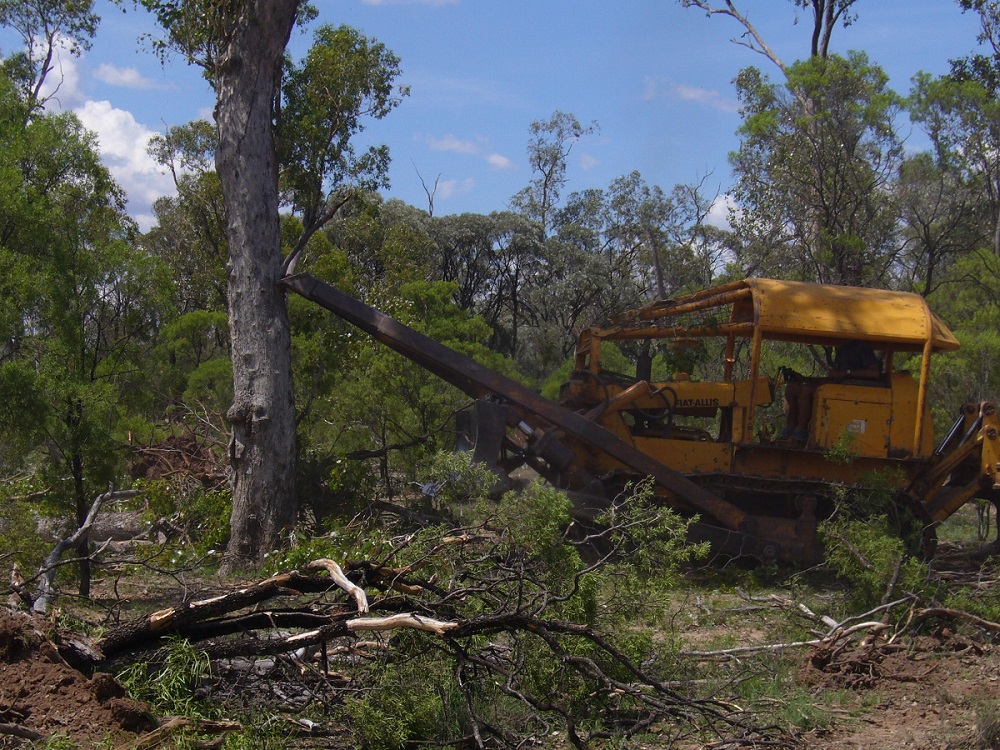

uploads/5937/FA_10_Treepusher.JPG
One iof these helps.
Just in case should have a photo of the tree pusher on our FA 10

Ian,
Thanks for the picture of the push bar.
The 6 is supposed to have one with it, just wasn't there with the dozer at the time.
I can make one as well if the one with it is too light. That picture gives me a lot of detail to pattern one.

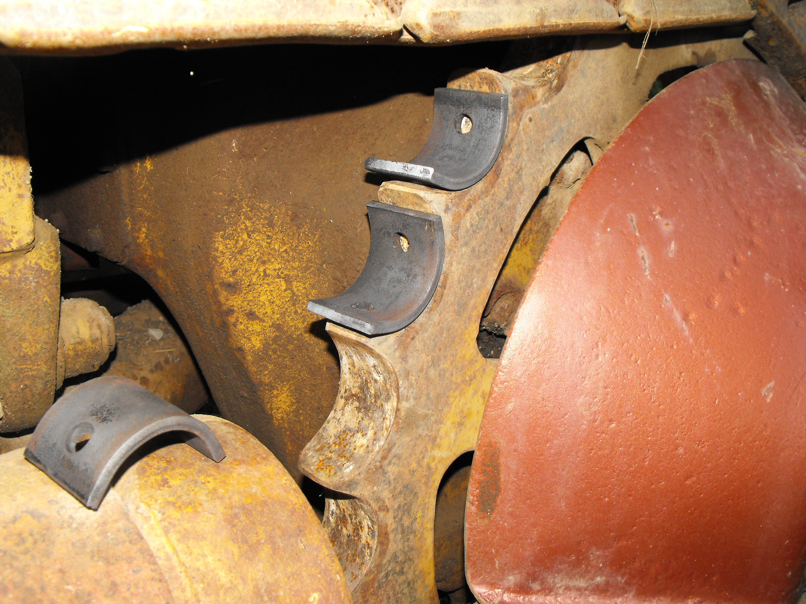

Thought this might be a good post to inquire on rather than start a new thread.
I've got a HD 6G with the 20 spline rear sprockets but they're pretty worn out.  I found a set of New Old Stock 6 spline sprockets for pretty much scrap price.  Anyone know if the shaft diameter was the same or if it's viable to have the 6 spline machined out to fit my 20 spline axle?  Any advice appreciated.

Probably not cost effective to have resplined but could have a weld shop remove the sprocket ring with a plasma cutter on both machines and use them for replacements. Seals are now non existent, bearings are still available.

Henderson Manufacturing Pittsburg, Texas (903) 856 3658
www.hendersonmfgco.com has AC sprocket rings and track adjusters.
I would purchase the used sprockets to have because they are difficult to find.
I would consider rebuilding the existing sprockets on the machine
Inserts can be purchased or made and welded on your sprocket.

Welding on sprocket rings is a normal part of repair - the rings can be installed without removing the sprocket by cutting a section out of ring - then rewelding it once slipped over old spokes .
 It's not worth trying to machine sprocket center or other such modification or changing axles to match sprockets .
