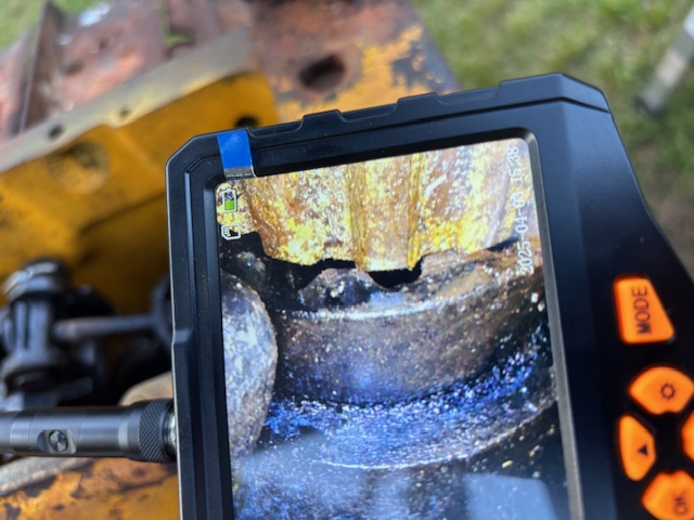

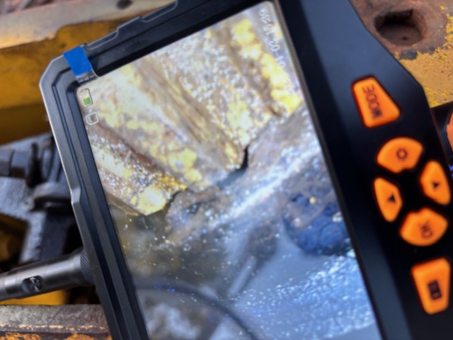

I rebuilt the steering clutches on my H3 and reassembling. Right side went together like a champ. The left side though is almost back together but the drive spline will not slip into the clutch. Using bore scope, it looks like the splines line up with the clutch on the top, but on the bottom, the splines are not lining up and won’t slip in…I am at a loss…any suggestions?

Do you have any way of posting pictures of the view through the bore scope?

Post Options Post Options   Thanks (0) Thanks(0)   Quote Pgriswd Quote  Post ReplyReply Direct Link To This Post Posted: 30 Apr 2025 at 2:57pm

Post Options Post Options   Thanks (0) Thanks(0)   Quote Pgriswd Quote  Post ReplyReply Direct Link To This Post Posted: 30 Apr 2025 at 2:58pm

Post Options Post Options   Thanks (0) Thanks(0)   Quote Pgriswd Quote  Post ReplyReply Direct Link To This Post Posted: 30 Apr 2025 at 3:00pm

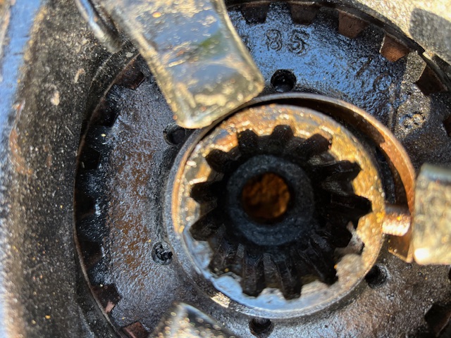

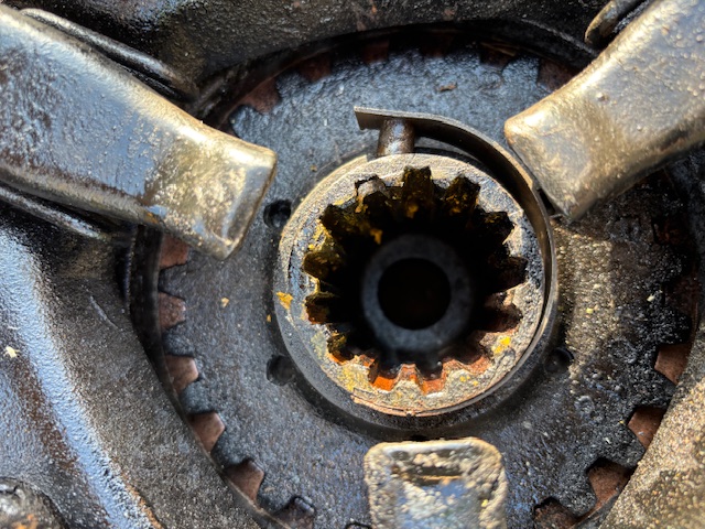

I removed both clutch packs and found the splines are different, so I guess there is a left and right side and I put them in backwards.  I haven't reinstalled but I think that is the issue - the drive spline and clutch packs are matched.

Post Options Post Options   Thanks (0) Thanks(0)   Quote Pgriswd Quote  Post ReplyReply Direct Link To This Post Posted: 30 Apr 2025 at 3:08pm

Post Options Post Options   Thanks (0) Thanks(0)   Quote Pgriswd Quote  Post ReplyReply Direct Link To This Post Posted: 30 Apr 2025 at 3:09pm

I think you can see the difference in the two packs

Post Options Post Options   Thanks (0) Thanks(0)   Quote Les Kerf Quote  Post ReplyReply Direct Link To This Post Posted: 02 May 2025 at 7:54am
The distortion of the photos makes it a bit difficult to tell for certain, but it appears that the the splines actually vary in width. Is this correct?

Post Options Post Options   Thanks (0) Thanks(0)   Quote Pgriswd Quote  Post ReplyReply Direct Link To This Post Posted: 03 May 2025 at 4:49pm
They are but it looks like wear
I swapped the left and right. The right went in and the left is still not fitting

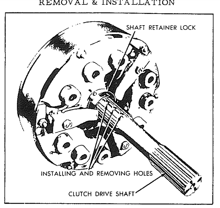

Post Options Post Options   Thanks (0) Thanks(0)   Quote Les Kerf Quote  Post ReplyReply Direct Link To This Post Posted: 07 May 2025 at 9:32am
Any progress?
I downloaded an H3 Service Manual, it isn't very clear; are the shafts reversible?
