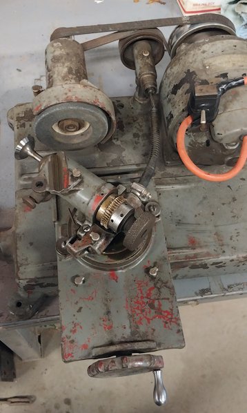

If you are going to work on old tractors, having old tooling with which to work makes for a more enjoyable experience.

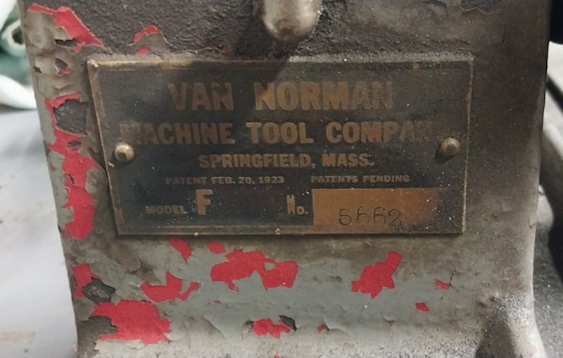

My 14 year old Grandson is grinding valves for my Allis-Chalmers Model C tractor engine using an antique Van Norman Model F valve grinder. This particular valve grinder was in the old Careywood Garage at Careywood, Idaho which was owned by the late Chas Wallace and later purchased by my Father-in-law, Ronald Hoffman.
This valve grinder has a Patent Date of Feb. 20, 1923. This does not mean that the machine is that old, but I have reason to believe that it could easily date to the 1930‘s because a photograph of the Wallace Brother’s Garage is shown in the Bonner County Historical Society book in the Careywood section.
Chas Wallace sold the property in the mid-1960‘s when he retired, and it appears that the valve grinder was not functional at that time due to a broken drive cable. It sat unused and covered with dust until last year when I fabricated a new drive cable (parts availability being a bit problematic) and installed some new wiring.
The spindle head seems to be in serviceable condition and the valves are acceptable after grinding. I wouldn’t want to try to earn a living with this machine, but for my limited needs it suits me just fine.
