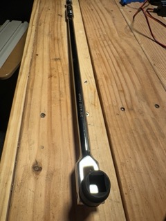

Re the clunk, before tearing down the final, double check the PA wheel clamps...Wink
After tightening up the final drive with repairs on the hand clutch, it was better, but there was still a clanking when on the road. Thus, as DiyDave mentioned, the "Eccentric Pins" that hold the rim tight keep coming loose.
The shop manual, "...each eccentric pin must be fully turned to the right to be tight." I was not getting them turned fully to the right, thus would keep coming loose quickly when used.
I finally was able get the job done with a 24' cheater bar and a 9/16" Female Plug Socket
Edited by CA13414 - Yesterday at 6:28pm
