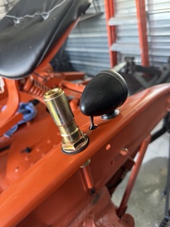

Finally installed the original tail light. I looks awesome and works well with the push pull light switch that we put together last summer.

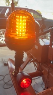

I have wanted to install an Emergency rotating strobe light for road travel. There was already an extra hole in the fender, in front of original tail light. Thus, I drilled that out and put on the bracket for a rotating strobe light.. Can simply slip the light on or off the bracket as needed.
My goal is to make sure I am noticeable, when on the road, to iPhone distracted drivers!!!

Post Options Post Options   Thanks (0) Thanks(0)   Quote CA13414 Quote  Post ReplyReply Direct Link To This Post Posted: 26 Jul 2025 at 2:08pm
Works awesome, with the push-pull light switch.

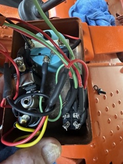

Finally, opened up the “key and switch box” and moved the "Magneto ground wire" to the 12V toggle contact to supply power to the distributor that Steve at B&B sent.
Now when the key switch is on and the toggle is switched on, the distributor coil will be powered.

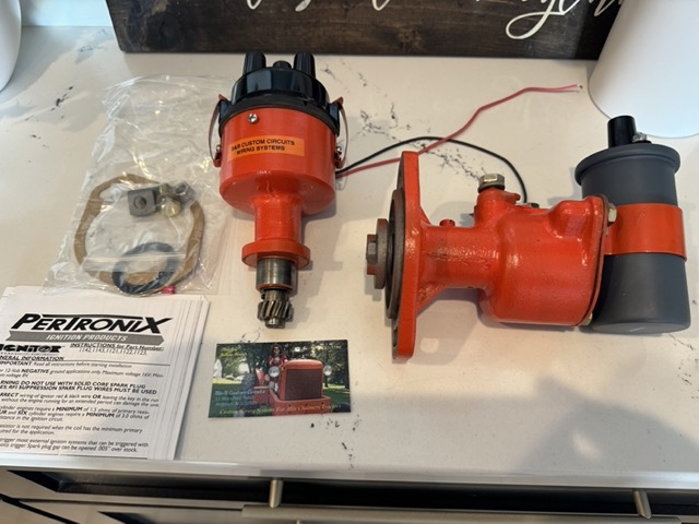

Drive unit and distributor arrived last evening. Looks spectacular and excited to install this weekend. Thanks Steve!
I marked the exact spot the rotor was pointing before taking off the Magneto. With firing order of 1,2,4,3, the magneto rotor was pointing directly to the cylinder # 3 cap terminal. Hope it is an easy install without needing to find #1 TDC.
