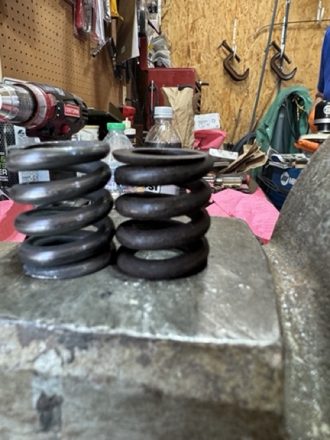

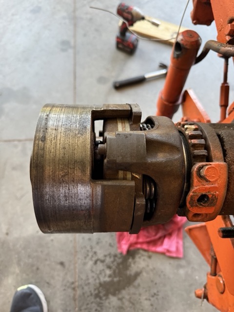

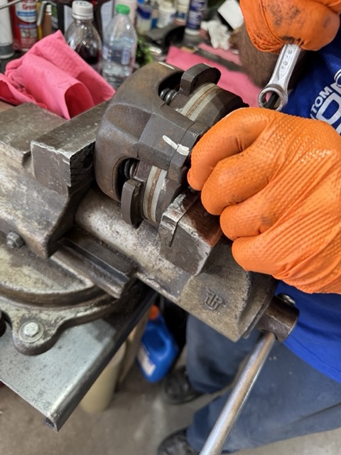

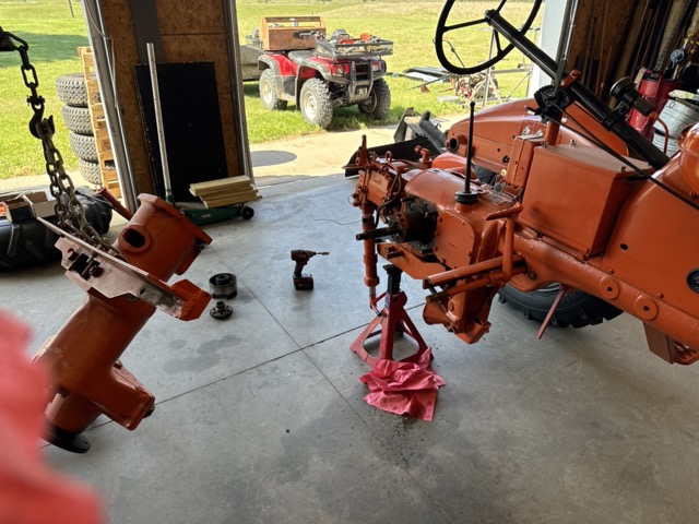

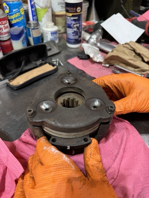

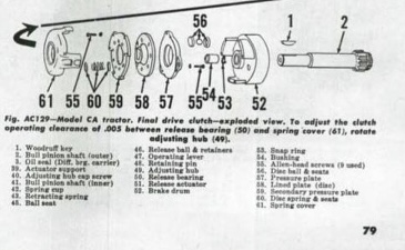

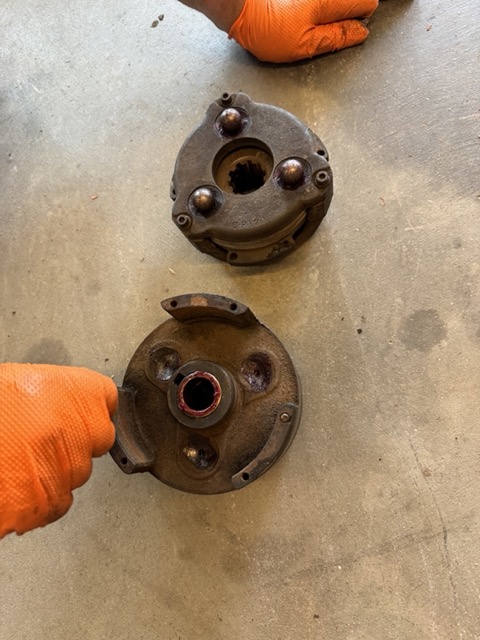

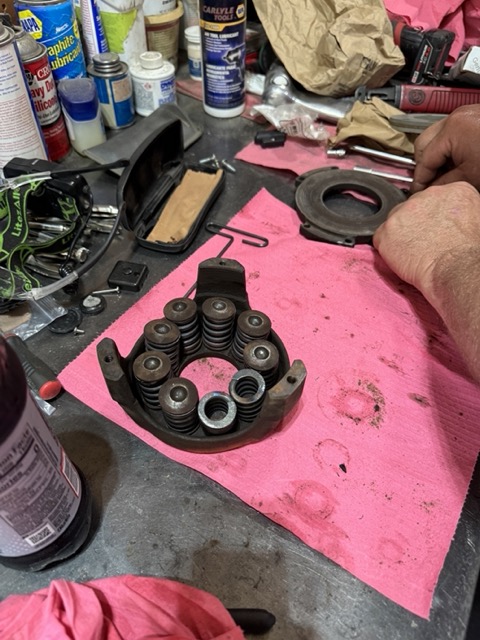

This past week, we took the CA to my friends Dads shop to take the CA apart to replace the final drive clutch. As well to work on his C10 Chevy as noted below. All went well. The rebuild clutch plate and springs from Sandy Lake were installed after cleaning up the pieces. It was clear the disk was slipping with wear on the pad.
Two issues we noted. First the springs were worn and/or lost some of their compression. Here you can see the new spring on the left which has almost a 1/4" greater length.
As well, the spring cover, secondary pressure plate with the springs, lined plate and pressure plate was intact and the surfaces looked great. However this as a unit was not bolted to the brake drum with 5 of the 6 bolts missing and one sheered off.
Figure AC129 of the shop manual has a great exploded figure which details this.
In retrospect, this was like this when we replaced the final drive seals last summer. I just did not recognize this as an issue until we noticed the slack upon reassembly last week. My friends Dad, said that doesn't look right and he was correct.
Regardless, we pulled it back apart and removed the sheered bolt, tapped out the threaded brake drum and put it back together with LockTight (as previously suggested). We used the vice in combination with tightening each Allen bolt. This made a huge difference in the slack.
All said and done, the hand clutch for the final drive worked awesome when reassembled. There is no slipping of the engine clutch or final drive hand clutch. Could feel the hand clutch "pull-over-the-top" as it disengaged and engaged. With reengaging I will need to be careful since it has quite a "grab." I expect if I do not let it slip a bit, I will shear off the bolts again.
It took about 4.5 hours in total, we drove it up on the trailer and headed home after working in the shop getting ready to rebuild the Chevy C10. Was an awesome day.
Edited by CA13414 - 17 Jun 2025 at 6:28pm

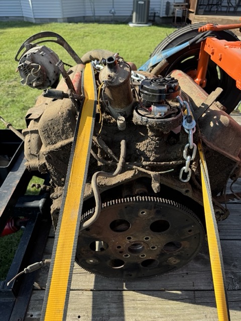

Here is our next project. From the farm we have two Chevy pickups my Dad used over the years that have been in the trees for over 20-30 years.
My bother is rebuilding Dad's 1970 Chevy 1500 Short Box fleet side. We have a 350, 4 bolt main, engine which after taking off the pan, all is well and turns without an issue.
We will tear this down and plan for a 0.030 overbore, a stroker crank shaft with new rods and pistons, and double hump heads. With this he will have a great engine for pulling his camper, trailer or anything.
Would love fuel injection to add efficiency, but wow that is about 2K+
The other Chevy is a 1972 C10 that my friend is rebuilding..... will post a few pictures as it happens.
Edited by CA13414 - 17 Jun 2025 at 6:05am
