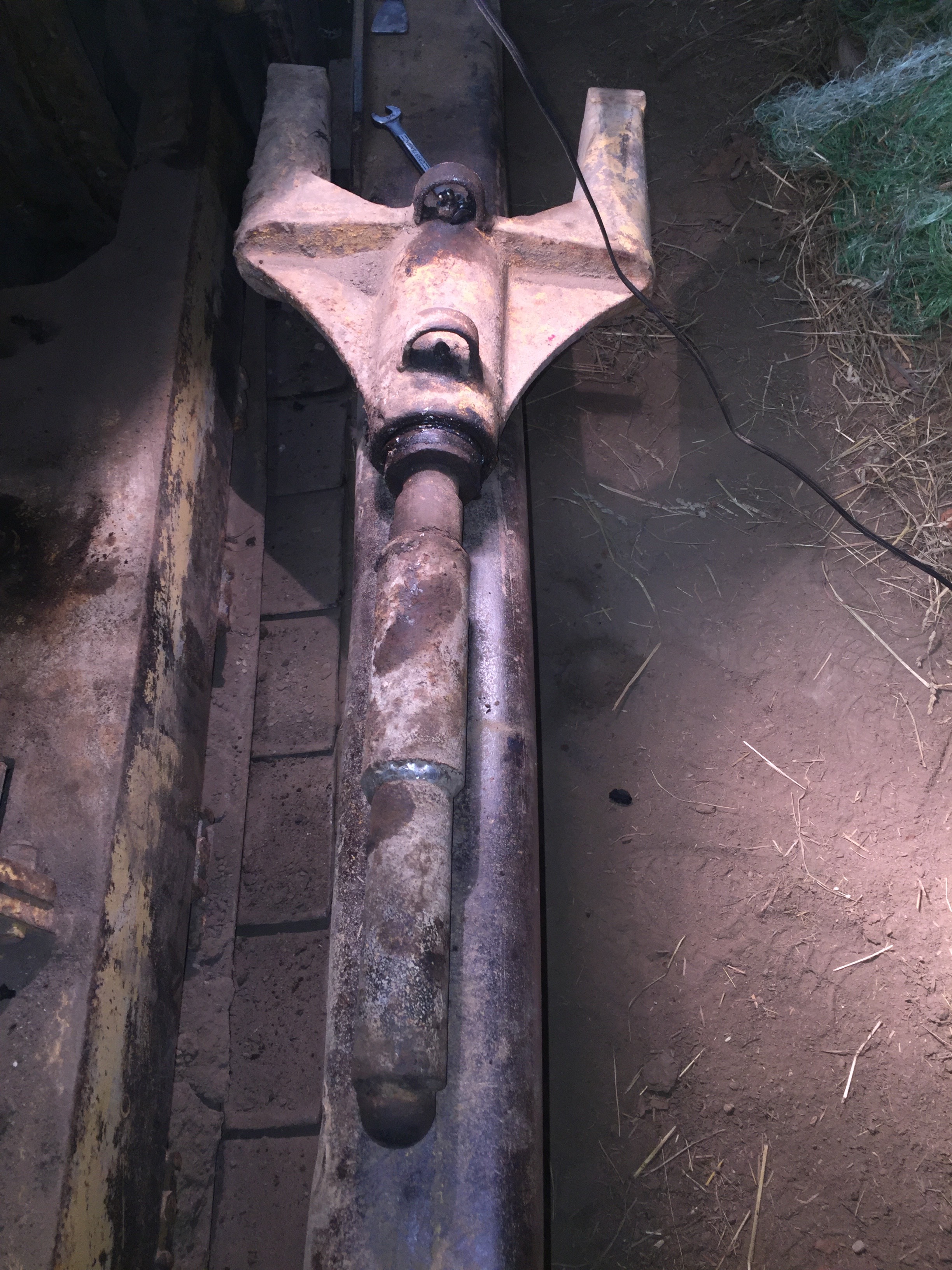

Hello AC friends
More follow up with a pic and a question. The parts book for my 16 says on the hydraulic adjusters, the adjuster rod is 20.5" end to end. Both my rods are that size so no length added which I think is a good thing. The repair I am showing on this rod now appears a case where they adjuster rod was cut to get at the adjuster to get it out. Just guessing and trying to verify with the owner.
My question is this. Does the adjustment or push rod come out of the hydraulic ram side as well so you can pull the piston? Mine is jammed on it but I have been soaking it and hope to break it lose. the parts book doesn't show it well. My guess is that it comes out to in fact service the ram and seal.
Another question is, how hard to get seal out and piston. I can turn the piston 360 now but to replace the seal the piston have to come out and I will then hone the inside of the piston housing and the piston itself.

Post Options Post Options   Thanks (0) Thanks(0)   Quote jerbob Quote  Post ReplyReply Direct Link To This Post Posted: 11 Sep 2017 at 8:28am
Sorry for the size of the pic. I am toning it down to hopefully get a better look at it.

Post Options Post Options   Thanks (0) Thanks(0)   Quote DMiller Quote  Post ReplyReply Direct Link To This Post Posted: 11 Sep 2017 at 8:37am
Looks to have been sleeve repaired at some point, the other side similar?

Post Options Post Options   Thanks (0) Thanks(0)   Quote jerbob Quote  Post ReplyReply Direct Link To This Post Posted: 11 Sep 2017 at 11:46am
No DMiller. Other side is clean and original. Overall length on both sides however is stock so they didn't extend it for more adjustment.
Was kinda shocked that it came out as that was not my intent. Now I want to get that piston out and replace the seal.
