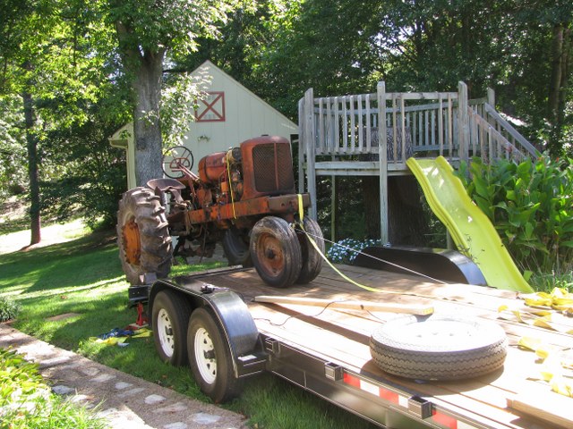

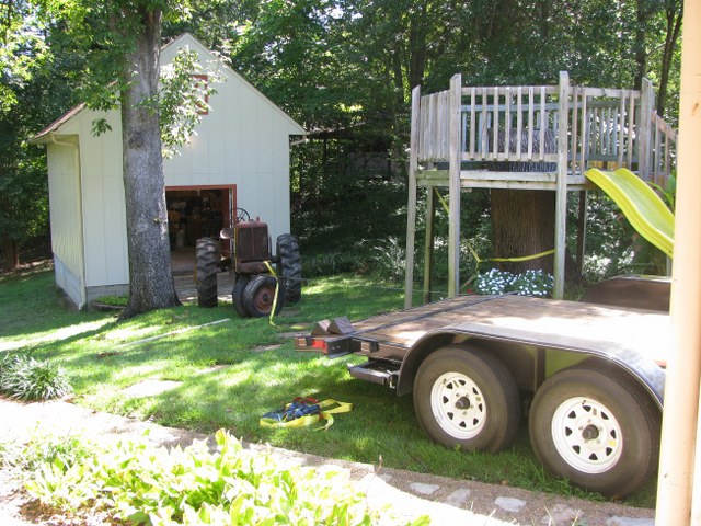

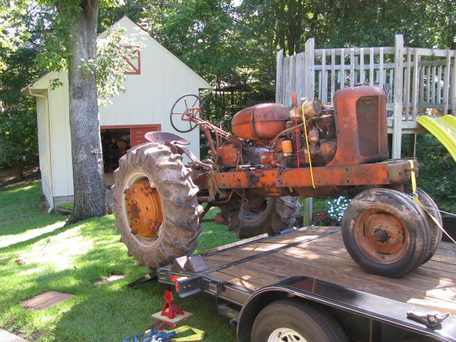

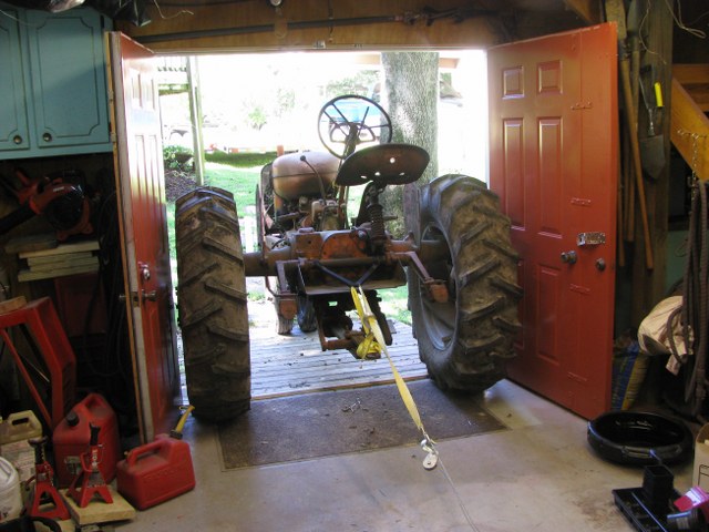

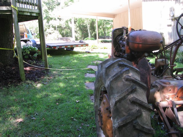

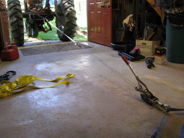

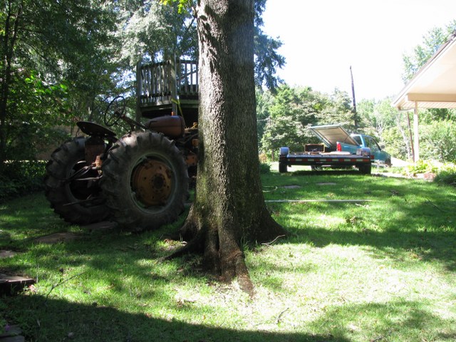

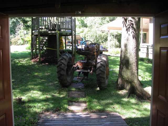

The fun can now start. Got the tractor back to the house from the farm. I was lucky that my shop is downhill so gravity helped most of the way into the shop with the help of a come-along the last 10 feet or so. Here's a few pictures.

The rear rubber is good to go.

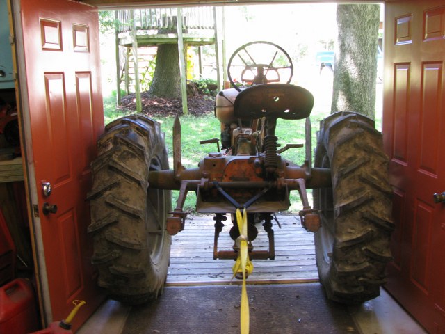

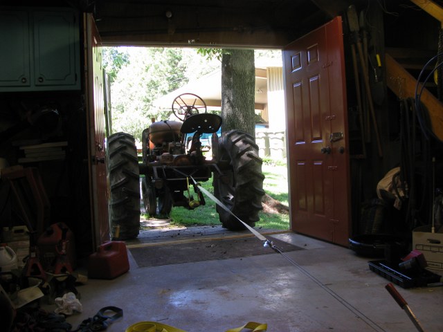

Looks like it just fits thru the doors!

Post Options Post Options   Thanks (0) Thanks(0)   Quote Stan IL&TN Quote  Post ReplyReply Direct Link To This Post Posted: 16 Sep 2012 at 8:50pm
Greg it did just fit.  For the Ferguson I had to remove the doors to get it in and the WD45 was 5 inches wider even with the rims spun all the way in.  That meant that the WD45 sat on the trailer in the barn @ the farm since May to allow me time to widen the doors.  If you look close you can see the 9 inch spacer panel bolted to the one door.  It was a whole bunch of work to remove the door frame and rebuild it 9 inches wider and then make the filler panel and get it to not look like crud.  Two 36 inch doors plus the 9 inches gives me 81 inches now.  I didn't even need to pull the doors to get her in.

The tires have air in them, and it looks (from the pix anyway) that the air actually stays IN them... that's a good sign.
Engine still turn, or is it stuck?

Post Options Post Options   Thanks (0) Thanks(0)   Quote Jim Lindemood Quote  Post ReplyReply Direct Link To This Post Posted: 17 Sep 2012 at 7:00am

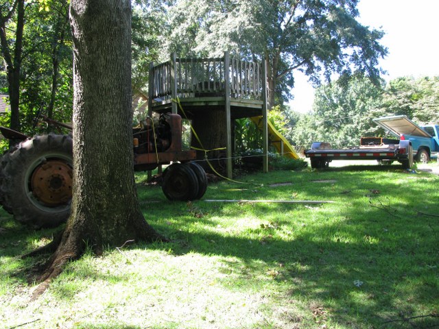

Looks like working it down thu the yard. arouned tree and through the door took a little thought and engineering -- have fun working on her.

Post Options Post Options   Thanks (0) Thanks(0)   Quote Stan IL&TN Quote  Post ReplyReply Direct Link To This Post Posted: 17 Sep 2012 at 8:34am
The rear tires thou dirty are new.  Still has the little tit's on them.
The engine is stuck.  All summer long on each visit to the farm I would add a mixture of ATF, acetone, ATF, Deep Creep, Liquid Wrench, MMO and PB Blaster.  She's still stuck.
Getting it around the tree and aligned with the shop door was fun as the steering is disconnected so I used a 2X4 between the front tires to turn her.  It has factory power steering but it's locked up also so I removed it in order to get the wheels to steer with the  2X4.
