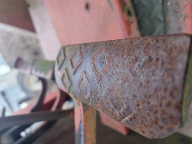

As a comparison on the clutch pedal and drawbar, I am showing my 67 and 68 pics.  Here is the clutch pedal on my 67.  Unknown hours but most likely 10,000+ hours.  Completely missing the diamond on the outside of the clutch pedal.

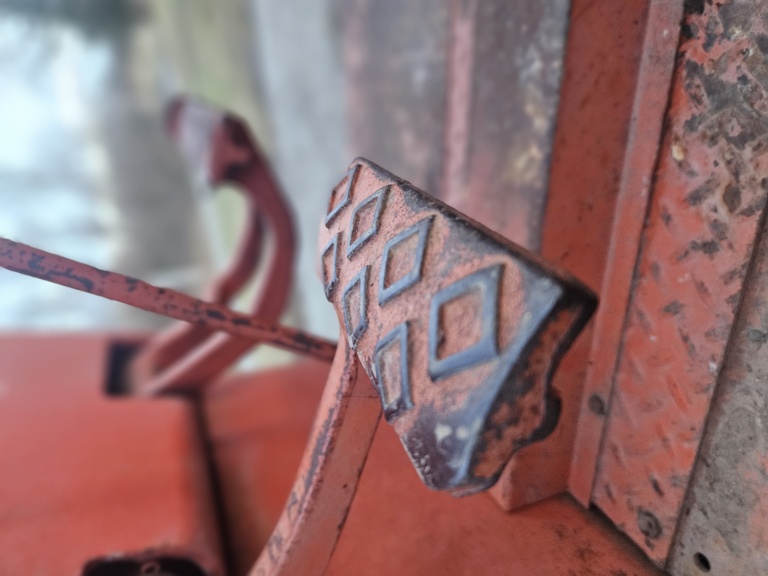

Here is the 68 clutch pedal.  Plenty of diamond left.

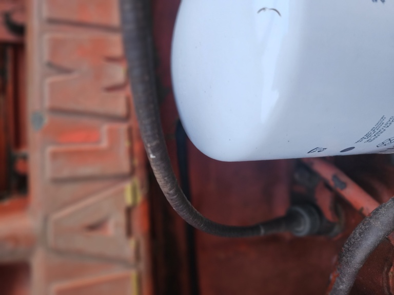

This is the 68 tach cable.  I think it is original, rusted metallic spiral wrap instead of plastic like on my 67.  Tach says 3880.  It does work.

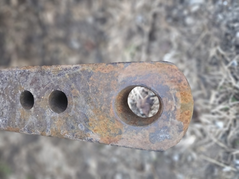

My drawbar from the 67.  Lots of abuse.
1968 Drawbar has lots less abuse.

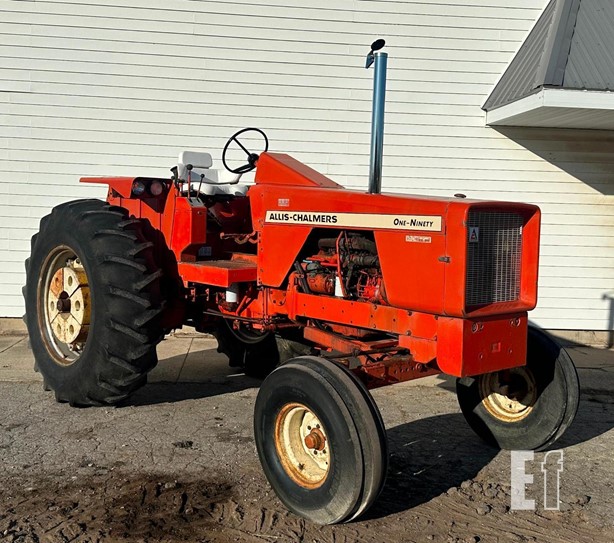

Here is a full picture of the 1968 190XT I bought.  No surprise to anyone on the forum that the wife got notified about 5 hours before it showed up and didn't go over well. :-)
It has been repainted but I think it was a long time ago. I don't think the decals are correct after repaint.  There are no leaks on the engine or hydraulics.  The clutch is tight, brakes are good.  Not a lot of blowby but some.  Everything works, pto, 3 point.  Nice new seat and a new steering wheel with the AC medallion in the middle.  Tires are worn but not horrible.  Tin is good, nose grill good.  The electrical wasn't good but I am fixing it.  Turns out the key switch is bad so it wouldn't start.  Positive cable from starter was rigged and bad.  Key switch ran down the batteries so replaced it.  Didn't have a block heater but I am adding one.  It showed up in 20 degree weather so we drug it off of the trailer.  It did get to 60 degrees, I removed the tiny car battery and added two tractor batteries and started first turn.  Sounds good and runs strong.  Lights work.  Injection pump is a Standayne unlike my Roosa on the 1967 but seems good.  Wheel weights are a plus, although it does not have the spinout rail system.  There is still an oddity to how body panels are arranged.  There are some gaps in the top hood so it is like it is out of alignment, but not sure how it happened?  The side console aluminum plate is faded and not legible.  it does have all of the knobs on all levers though, unlike my 67.
I haven't seen a 68 nice one like this in a long time and I got outbid last time.  So hey, I got a 1968 190xt to match my forum id finally after 8 years on the forum!  How crazy is that!  Going to be hay raking tractor this summer.  Is it a 3880 hour tractor?   No way to know for sure but doubtful that a tractor that is 57 years old has that few hours but it could be.  The older tach cable is encouraging.  Someone took care of it though regardless  all along the way.  Curious if anyone knows the history on it?  Came from Brillion, WI and the Tesch Auction in case anyone knows the history.  Dealer sticker is Villard, MN and they are still in business as an Agco dealer.   Sticker looks older style though so they could have resold it years ago and not the original dealer.  Might send them a picture to see if they can date the sticker.
