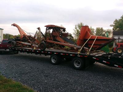

one like neighbor has---hyd. tail ,---dual wheel tandem.

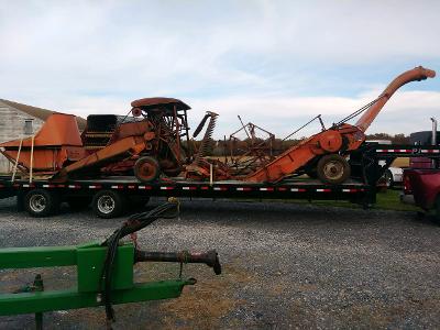

F350? Looks like should be hooked to a semi?
Points: 35666
