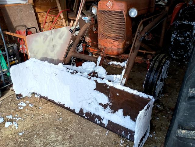

Allis folks,
 I have the wing design layed out for the ends of the push blade. Need to go to town to get oxygen to cut out the shapes. This will make it into a poor mans box blade. The end pieces may just be welded in place direct to the blade or may be bolted on so that they could be removed?? We will see how the end pieces fit when cut out and cleaned up. They are about 21 inches high, the height of the blade, about a 1/2 inch off the ground on the bottom. (room for a shoe if needed). The distance out from the blade is about 16 inches. (that's all the material that I had to make these two box ends).

Steve A, folks,
I touched these end plates out this morning. Was good to do some oxy/act cutting.
Yes I plan to bolt these wings on to the ends of the blade. Good suggestion. We don't have any snow yet. Maybe wont need this plow tractor this year??
I drilled 4 holes in each side for 3/8 bolts.

Post Options Post Options   Thanks (0) Thanks(0)   Quote Steve A Quote  Post ReplyReply Direct Link To This Post Posted: 24 Nov 2025 at 11:04pm
I did that on a snowplow blade for a Farmall A to prevent trail off. I also had to add a piece of angle iron at a 45 deg from about the midpoint in the "wing" to the blade so that the wing wouldn't bend.
Points: 8606
Post Options Post Options   Thanks (0) Thanks(0)   Quote Sugarmaker Quote  Post ReplyReply Direct Link To This Post Posted: 25 Nov 2025 at 7:32pm
Steve, Folks,
 Thanks for the tip on stiffening the wings on the snow plow. We may get a chance to try it out as the weather guys are predicting some snow after Thanksgiving.

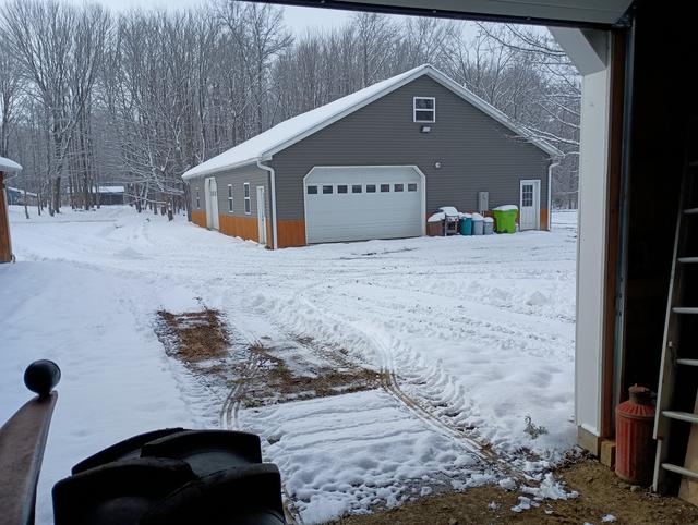

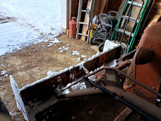

Allis Folks,
 We have had about 6 inches of snow. Enough to try the D14 and the snow plow with wings. The plow worked great! The snow was very stiff and packed and pushed well. I still have several issues to still resolve:
1. It still starts much harder than the fresh CA.
- Ok so the D14 is still 6 volt, CA is 12 volt.
- It doesn't crank smooth and evenly and for sure doesn't start on the first roll over.
- it just barely started in the cold 30 degree tractor shed.
- not sure if it might be starter, carb may need rebuilt, or valves may need adjusted?

Points: 5280
Post Options Post Options   Thanks (0) Thanks(0)   Quote AC720Man Quote  Post ReplyReply Direct Link To This Post Posted: 22 hours 27 minutes ago at 7:12pm
Chris, as you know, 6V rolls over slower especially when the temps are cold. Let me say this, my WD is still 6V. I put a new battery in it 4 years ago, cleaned up my grounds, new 00 size welding cable for both ground and to the starter. It spins over close to 12v systems. It made a huge difference!! This tractor doesn’t get run often anymore, but I just started it last week in 40 degree temp and it fired right up. I’m selling it so I moved it to the shop to swap it out to a wide front at the request of the new owner. I can’t express the importance of clean grounds and proper gauge wire for these ole girls to spin them over fast enough. Crimp style connectors are a must as are the proper size battery connectors. I’m sure you know there is a difference in the size connector for + post and - post. Most parts stores sell one size fits all. I went to a true battery store to get the correct size as well as the crimp connectors. I have the tool to crimp different sizes of crimps but the battery store will make them up for you. I’ve tried pre made cables from parts stores before and they don’t work well. So I make my own. D14’s are neat tractors, although 12v works better, a properly grounded and healthy wired 6V should start well. Our dads 6V D14 always started well even in the cold temps, but I am glad my 59 is 12v which does spin over a little faster.
Points: 8606
Post Options Post Options   Thanks (0) Thanks(0)   Quote Sugarmaker Quote  Post ReplyReply Direct Link To This Post Posted: 1 hour 12 minutes ago at 4:27pm
AC720man, Allis folks,
 Thanks for the support! This old D14 started well this morning. While in initial starting cycle I choked it quickly one time and it fired right up. I may just need to get the sequence correct? I have thought about new cables for the battery also. These can get corrosion on the inside but look fine on the outside. Your right on the mark about clean connections and correct size wires.
I plowed the drive again today. Not a big snow fall but a good test for the D14. It performed well. Like a lot of things, it helps to do a little maintenance and have equipment ready when needed.
