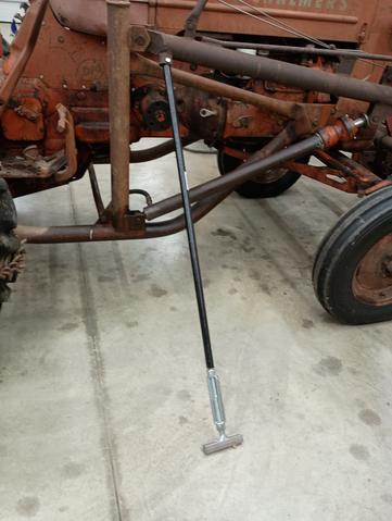

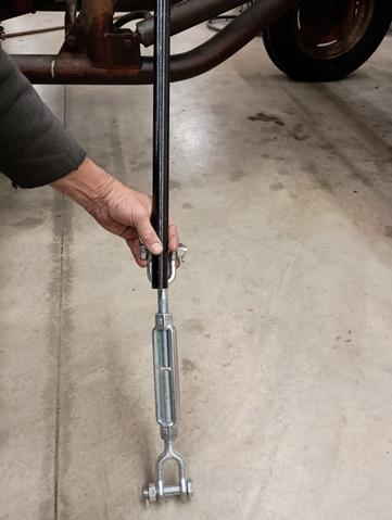

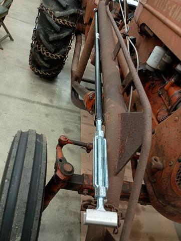

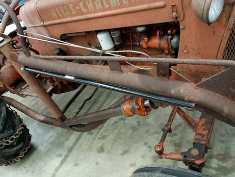

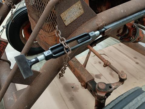

One of my 4 projects for the day. Noodling out the high lift support arms on this loader.
So first they were missing. Not surprising. I got some black pipe that fits the socket well. drilled a hole for the pivot. I ordered a couple 3/4 inch dia turn buckles. The idea is to weld one end of the turnbuckle on to this pipe and have some adjustment when its time to remount the loader to the tractor. The other end of the turn buckles would have a short piece of angle iron welded on to set in the dirt. Ok I don't take this off very often but maybe I would if these work. I really have only been using the D14 as the snow plow unit for last year. But we did take it to a plow day and had fun with it and the Allis 2 bottom mounted plows.
So we will see if this works?? Concept:Extend turn buckle and raise the lift arms to get it attached.
 Also making them a little longer to drive the front through. Was very tight fit before when propped up with boards.
I am also going to try to fab some ends for the blade to make it hold snow a little better?? These ends would be the height of the blade and stick out about 14 inches in front of the blade. All sounds good on paper. My plans usually go south pretty quick!:)

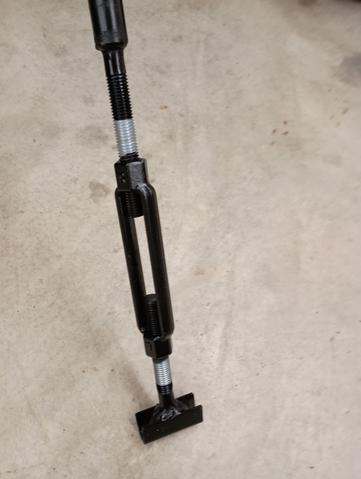

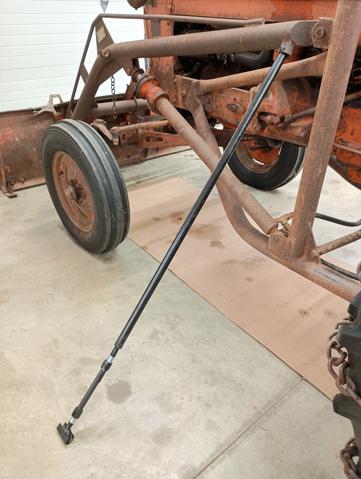

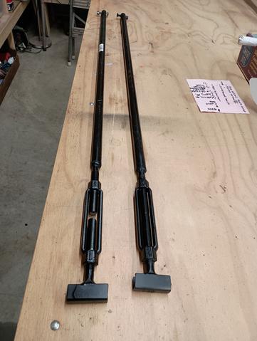

Post Options Post Options   Thanks (0) Thanks(0)   Quote Sugarmaker Quote  Post ReplyReply Direct Link To This Post Posted: 04 Nov 2025 at 6:54pm
Guys,
 I got the turn buckles today this might work?
Some fab required.
 Chris and Cheryl

Points: 8577
Post Options Post Options   Thanks (0) Thanks(0)   Quote Sugarmaker Quote  Post ReplyReply Direct Link To This Post Posted: 16 hours 59 minutes ago at 4:59pm
GG, folks,
 This was a concept then a prototype. The supports may or may not work. They would just splay out on the concrete floor so your dirt might have an advantage? :)
Almost ready for the snow!
