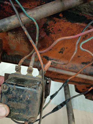

I ordered a new Voltage regulator from Sandy Lake Implement today. Still did not have any improvement in the charging system after testing the generator. It motored and the field test was ok.
So we are still at 6 volt on this system. It has a almost new battery. I have thought about changing to 12 volt. That would be another $400 at least, and sometime rewiring it also. We will see if this new voltage regulator gets us charging again. I am going to clean up the contacts on the old regulator and test it again too.

Chris, the regulator and battery work together to hold the CHARGE down to about 7 volts... If you take the wires off the generator and then start the engine and spin, the GENERATOR will put out about  15v on a 6 v generator and about 30v on a 12 v generator.. Its the BATTERY that drags it back down to 7v... with the help of the regulator.. you can test this way to see if the generator is in good shape.. or the regulator is the problem..

Thanks, yes I am going to do some more checking on the existing 6 volt voltage regulator. The grounding areas (mounting bracket) and all the contacts on the regulator were very corroded. So the bracket and grounding needed cleaned up even if this regulator is not good. Some good info on testing the generator and the regulators on line. I get an hour or so each day to play with the D14 in the shop. No snow here yet but we have had several good frosts.
