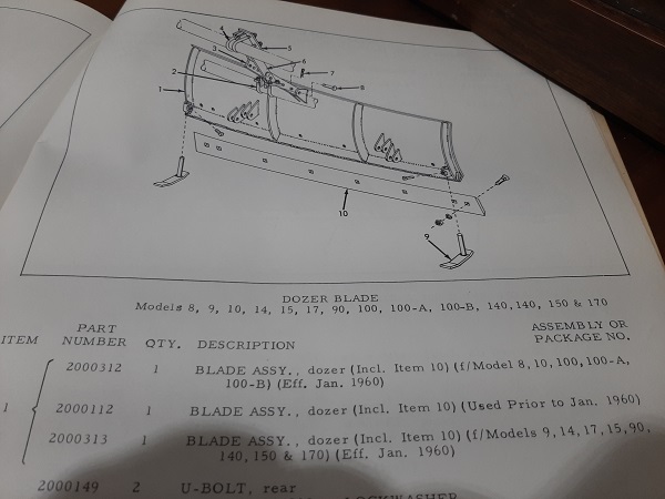

Ted, I will get some shots of the blade mount. Not sure if this is a Allis attachment? But it does have orange paint on it.
Do you mean the Ford Barn site?
Was this a Allis blade or just painted orange??

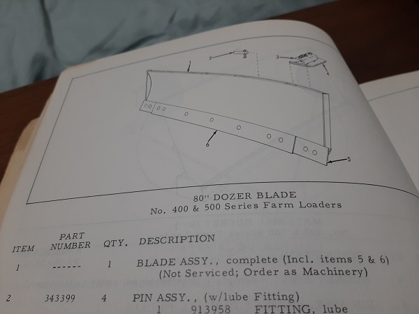

Ted J said (Thanks for the pics of the front plow.  That gives me some ideas.  No, I don't think that was ever made by Allis) Ted there is pictures of one in the loader parts manual for the 400&500 series loader and the models 8,9,10,14,15,17,90,100,100A.100B,140,150&170. Also I've not seen one either

Kenny, Ted, Allis Folks,
 Thanks! So it is a Allis dozer blade. I am not familiar with the 400-500 series loaders. But the pictures you show really looks like you nailed it.
That helps with the back story on the tractor and equipment too.
Having a loader tractor in the family was one of my attractions to this unit. Second was the fact that I might be able to use it to plow the drive next winter, maybe easier than with the Ford Jubilee and back blade. Ok we had snow the last two days but not enough to plow.

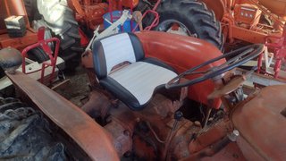

A week ago I was so happy with this tractor starting I thought it should have the seat re-done. We removed the cushions. Then had to cut the 1/2 inch dia seat pin to get the pan off the tractor. Cleaned the seat pan in the Electrolysis tank for several days. Today I removed it from the tank, wire brushed it, sanded, sandblasted and primed it. The upholstery shop has some white pleated vinyl for the center portions of the seat.  A pretty good match.
I hope to have this seat done in a couple weeks. I can still move the tractor setting on the seat frame.

 I did get the two cushion supports back from the upholstery shop. Put one through the E tank and the big one is in there now. A little welding and sandblasting and they should look and work almost as good as new.

Folks,
I did get back the D14 seat:
I think it looks very good.

Seat looks good!!

A better seat picture:

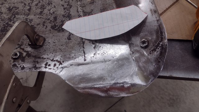

Had to add a picture since I got a new wireless router and my speed went way up and pictures loaded way way quicker!
This was where I had to repair the steel liner that the upholstery was glued to.
 Chris and Cheryl

Maybe I'm the only guy that actually likes the seating position on a 45?
Chris, that must be it, the old shoe thing. Grew up on a WD, learned to drive on that old tractor. They are just second nature to me I guess.
I hear a lot of drivers of other color tractors complain about getting on/off of WD's and 45's and saying that they are hard on the back. I must be impervious to that. I've put in some pretty long days plowing with my 45's and my back never seemed to suffer.
Mike you're not the only guy, I'm with ya!  I don't really like how my D17 seat is.  If the seat is down, it is just plain uncomfortable!  If it's up, it's just a little too far for me.  Just plain awkward for me.
Sat in the 45 from sunup til sundown during the spring and summer months.  Just time out for dinner.  I would get out of milking too if I was out in the field! Big smile

That seat looks GREAT Chris!
