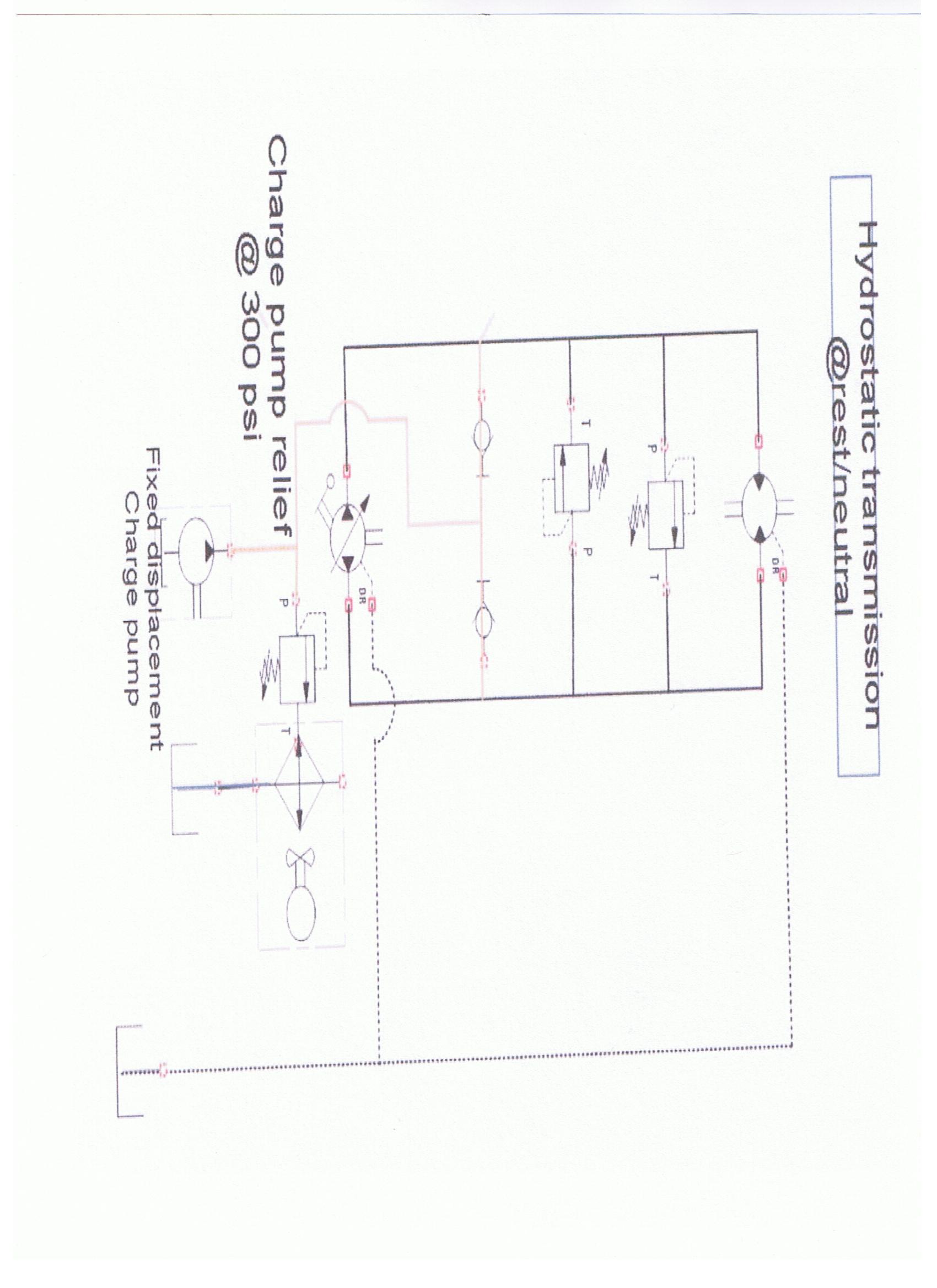

Don't know whether I've been sucessful but have tried to upload a schematic of a typical hydrostatic transmission-maybe this will help.
Tom

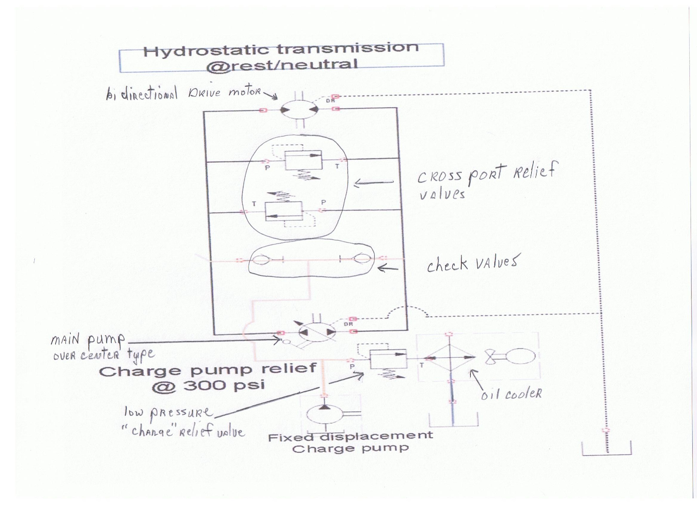

Post Options Post Options   Thanks (0) Thanks(0)   Quote maytag Quote  Post ReplyReply Direct Link To This Post Posted: 13 Jul 2010 at 3:59pm
Maybe this will work better.
Tom

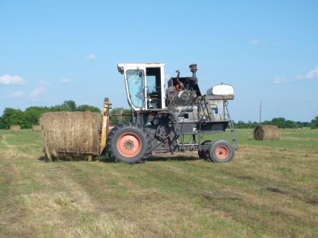

I don't know anything about hydraulics, or Gleaners for that matter, but I would love to see a picture of this "forkbine". I understand it's not your priority right now, but maybe later.

 Here is a picture of my modified machine.  When working, it is great.  Lots of visibility, cheap, and has weight on load bearing axle. Have added extra pump and reservoir from L2 for mast lift for speed and oil volume.

Can it pick up more than one bale at a time?

Machine is only set up for one bale at this time.
