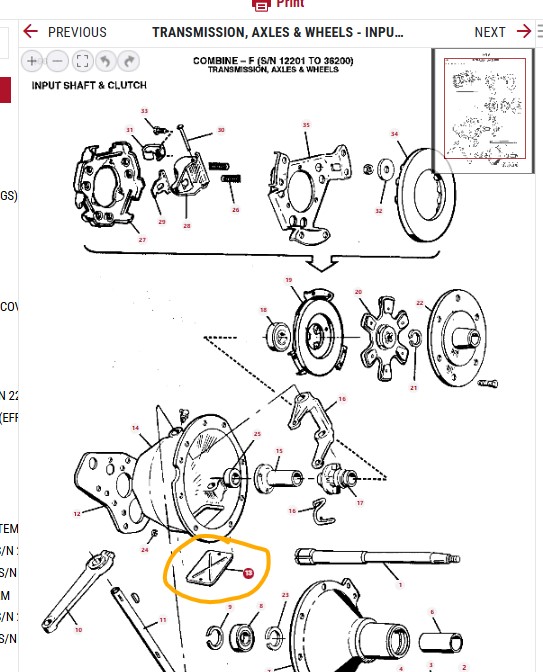

My other concern is the clutch: After sitting for 20 years, I suspect there's at least some chance it's stuck/frozen. I'm thinking (/hoping) I can access the cover (circled in pic below), to get in there with a pry bar and make sure the friction disc can break free of the flywheel and pressure plate? It's tucked in the previous owner's shed pretty tightly and awkwardly: I wouldn't want to fire it up for the first time and inadvertently drive through the wall of his shed because the clutch was stuck.
Edited by DanielW - 05 Sep 2025 at 8:53am
Points: 21932
Post Options Post Options   Thanks (0) Thanks(0)   Quote DrAllis Quote  Post ReplyReply Direct Link To This Post Posted: 05 Sep 2025 at 10:00am
Clutch is the pad style. They don't stick. Start with trans in neutral and if you can shift it into gear when you depress the clutch pedal, you are good.

Post Options Post Options   Thanks (0) Thanks(0)   Quote DanielW Quote  Post ReplyReply Direct Link To This Post Posted: 05 Sep 2025 at 10:22am
Thanks Dr., I'd never thought of the pad style not sticking. Hopefully I'll be good to go once I get the carb/pump/tank back on and lube up everything.
