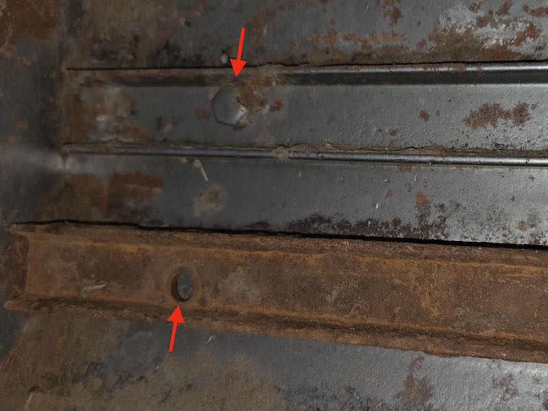

On the older gleaners with the bolt-in channel style concave bars, does it matter which direction they're installed? The holes are offset to one side.
The concave on the door looks like it only clears some nearby screw heads by flipping it one direction, so I am planning on carrying that over to the other concaves. My CII manual says nothing about it so it must not be important?
Picture of one concave one direction, and the other concave with the holes opposite.

Short side forward so the channel doesn't get lifted up off the floor.

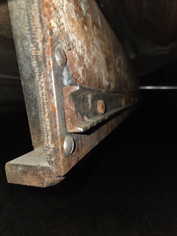

That logic makes sense. I can't do that with the one on the rock door though due to clearance to the nearby screws (picture below). I will flip the other ones on the concave door the way you describe.

Cut off the concave ends just enough so you can. You do not want to run them backwards

Interesting and thanks for the insights. I can probably take just enough off of the corner with a grinder to clear the screw heads.
