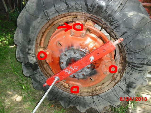

Didja try loosening the clamp bolts?  They are the 4 -3/4" wrench size bolts, with stop ear attached.  Even if you can only get 1 to move, it will take the pressure offa the whole wheel...Wink

Coke,
 I used a thick hitch cross bar from a Ford Jubille or equivelent. put it across the heads of two wheel bolts installed back in the rim but loose.
Then I bolted the rim to the bar in two places with bolts through two of the square holes in the wheel.
Heated the area around 6 inch wheel. applied pressure to the cross bar by screwing the two bolts back out of the hub. Applying pressure to pull the rim off the hub.
I have done a least two or three this way.
I may have a picture of the set up?

DiyDave, are the clamp bolts the four on the rim, one on each of those 3 bolt clamps as pictured?
I looked at them and tried to move them, if I take all 4 out, will the rim just come off without the hub?  What pressure are they exerting on the wheel? I'm thinking about hitting Harbor Freight for an impact wrench later, I soaked them all in WD-40 before coming in last night.
I just need to be able to get the rim to a tire shop, with or without the central part I suspect.

The 4 eccentrics you have circled are cams that are exerting outward tightening force on the rim. They usually dont come off easy. Most of the ones I take apart I have the entire wheel assembly off. layed on the ground. remove the 8 bolts holding the eccentric brackets on. And gently tap the wheel center out with a 10 lb sledge.
You can try to turn those eccentrics back countercloclk wise but my guess is that you wont budge them. Your mileage may vary!:)
Yes the tire guys would want this left on the tractor to change it tire and or tube.
Hopefully your rim is in good shape. Some calcium filled tires can be pretty bad with rust.
The method I show in these pictures will work and is safe. Just not for the weak of heart working on these old girls.

 You may have done the right thing. Just keep in mind if you do ever have to take the wheel assembly off the tractor you still have to go through the work!
When I start on one of these and get to the point I am ready to gently tap it with the 10 lb sledge. All bets are off. This is going to happen NOW!
It may not be clear in my write up or picture/s, but I am using the two wheel bolts to jack the wheel center off the stuck 6 inch dia.. The one in the picture sounded like a 06 rifle when it broke free.
The guy with the torch always wins! And you can fix almost anything with a torch and a 10 lb hammer!
Some of these old tractor projects are just not easy. Having some basic tools helps. But calling in help to get the tractor going again may have been your best move.
Add blaster to the 6 inch dia joint over the next several months wont hurt a thing! Take the wheel bolts out and squirt blaster in the joint from there too. Next time you try it may fall off.

Now that I see a picture, it clears things up.  Were it mine, I'd take off the 8 bolts, below the clamp cams, assuming you can't get the cams moving. Generally, once these bolts are out, a few love taps with a 10 lb sledge, from the rear side, inside, and the whole mess kinda collapses...
As for the stuck cams, as others have said, these are cams, not bolts, and there is an additional 4 parts, that need to be accounted for (don't lose them):  Don't know what the correct name for them is, but I call them cam sliders, they ride between the cam, and the rail, and generally fall out, when removing the cam assembly.
Lets see if I can find the video....
