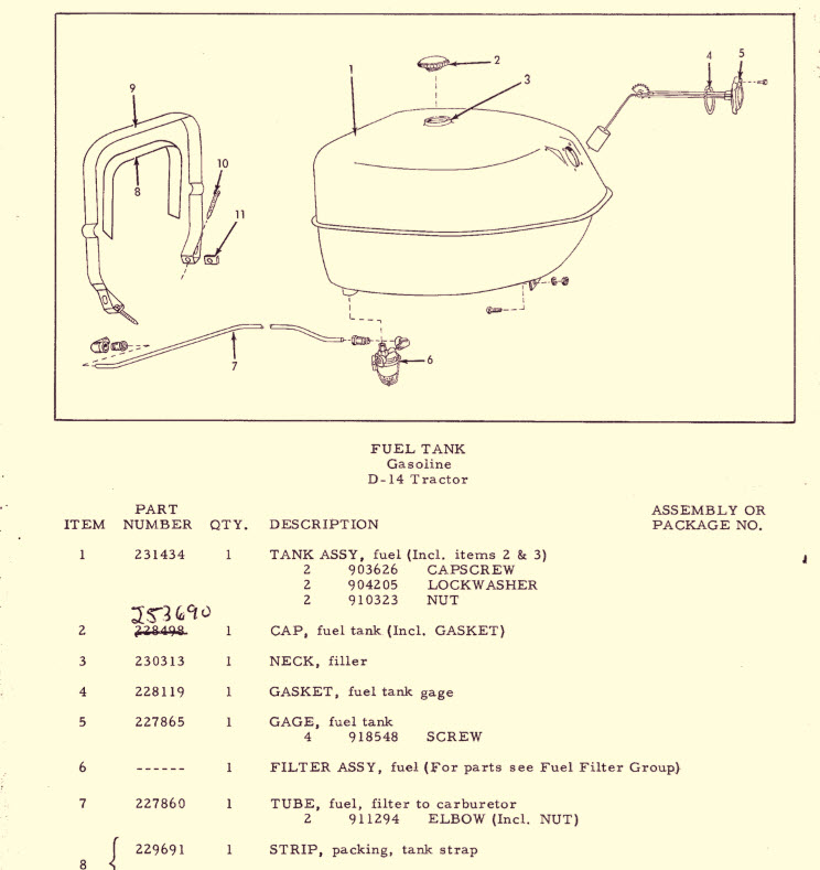

Does anyone know the size or MOSTLY sure of 1958 D14 fuel line????? Someone thought maybe 5/16??? Seems like a lot of break line is 3/16 or 1/4.
It is part number 227860 in the parts diagram for this D14.
I'm not lazy, the tractor is stored in the barn for winter 250 miles away and I want to guess my best guess of parts to haul down some warm winter day to work on it. If it's wrong I will of course just bring the parts home to take to the auto store but this would save me a 500 mile round trip  if I can get it right to take down the first time.

Post Options Post Options   Thanks (0) Thanks(0)   Quote Kevin in WA Quote  Post ReplyReply Direct Link To This Post Posted: 18 Nov 2016 at 9:51pm
1/4 inch
