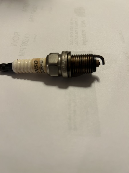

Well, I finally got back to bailing the Sequoia out for some service req'd as per Toyota and glad I did,!! I do believe I got my money's worth on these spark plugs,,,,Wink The gaps as pulled were .080 and were susspossed to be .032,,!! Got one 16 oz can of Seafoam in  tank with 18 gallons of fuel, so we'll see how it works out. Many Thanks for all the help, Guys.Clap

Points: 5279
Post Options Post Options   Thanks (0) Thanks(0)   Quote PaulB Quote  Post ReplyReply Direct Link To This Post Posted: 28 Apr 2023 at 2:03pm
I noticed those plugs you pulled out were "DENSO". I'll bet you'd never get that long of service beyond burning the electrode back from Crapions.

Post Options Post Options   Thanks (0) Thanks(0)   Quote desertjoe Quote  Post ReplyReply Direct Link To This Post Posted: 28 Apr 2023 at 4:22pm
  Hey Thad,,I got a quart of the MMO coming as nobody in this little ole burg had any,,,but just putting new plugs made a heck of a difference in the way engine sounds as well as the get up and go at stop signsLOLLOL chirped the caissons a time or two already,,,,WinkWink
