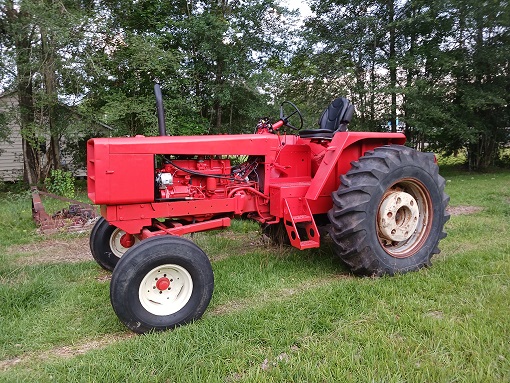

All, got a 65' AC 190xt with D2900 motor. Just finished mods on the old tractor that's been sitting for many years.  Got tractor up and running initially with few problems. I did however have to have the injector pump rebuilt do to the cage "plastic" parts coming apart and plugging up the whole pump and return line/valve. The tractor engine came less a turbo so I added one. Post the tubo install I now have a smoking tractor which fills my oil pan with fuel. This is something it did NOT do until I had the injector pump rebuilt and added the turbo. Does anyone have any ideas as to how I can tell where the fuel is coming from and how the fuel is getting into the oil? Also, its not just some fuel, when I pull the stick its like the whole case is full and when I run the tractor its now coming out of the front main seal..   Your thoughts are appreciated, I need to get mowing with this old tractor.

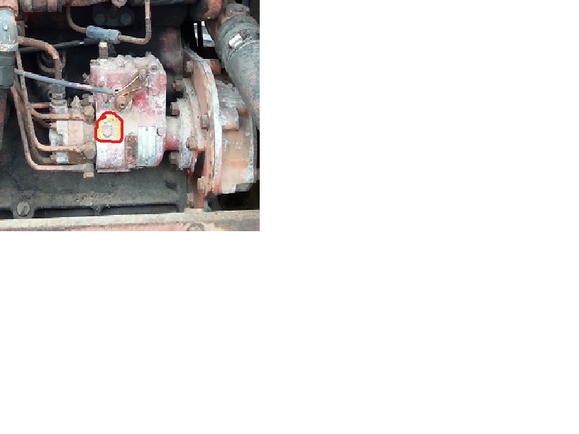

Just a sideline question for you pump SME's.  My tractor will not stay running unless the bolt circled in the picture is loosened to allow fuel to run out. If I tighten or stop the fuel from running out from it the engine dies. Any ideas as to why that may happen? Thanks much.

I'm not an injection pump expert by any means, but I suspect the flex ring in the pump is disintegrating and has plugged up the fuel return on the top of the pump. A temporary fix is to replace the fuel return fitting with a hose barb, but the pump will need to be rebuilt soon.
Edit:
A few things I thought I should add.
These pumps were built long before low sulfur fuel. When low sulfur fuel came along, it tended to disintegrate the flex ring. The newer rebuild kits are designed to work better with low sulfur fuel.
We used to say to knock the ball out of the return fitting so the fitting did not plug up with debris from the flex ring. The fittings are quite pricey (last I heard was about $75 or more). Chances are good that a reputable rebuilder is probably going to replace it during the rebuild anyway, but I just don't have the heart to intentionally ruin an expensive fitting when I can go to the hardware store and get a hose barb for a few dollars.
Removing the obstruction will probably allow the tractor to run for a short period, maybe a few weeks, but the pump needs to be rebuilt. it is a very temporary solution. Make plans to have the pump rebuilt soon.
SECOND EDIT:
I just read that the injection pump was just rebuilt. I guess I would be chatting with the guy that rebuilt the pump.
Edited by WF owner - 26 Jun 2023 at 6:17am

The same tractor that's putting fuel into the motor oil ??  Sounds like the fitting directly under the TEE on the top of the pump is plugged.

Is the picture of pump the one you’re talking about. That doesn’t look rebuilt or even ever off tractor

Yep, same tractor and pump. Pic was before the tractor and pump were rebuilt.

Shouldn't be failing already. He probably didn't clean or replace the old fitting and it's plugged.
