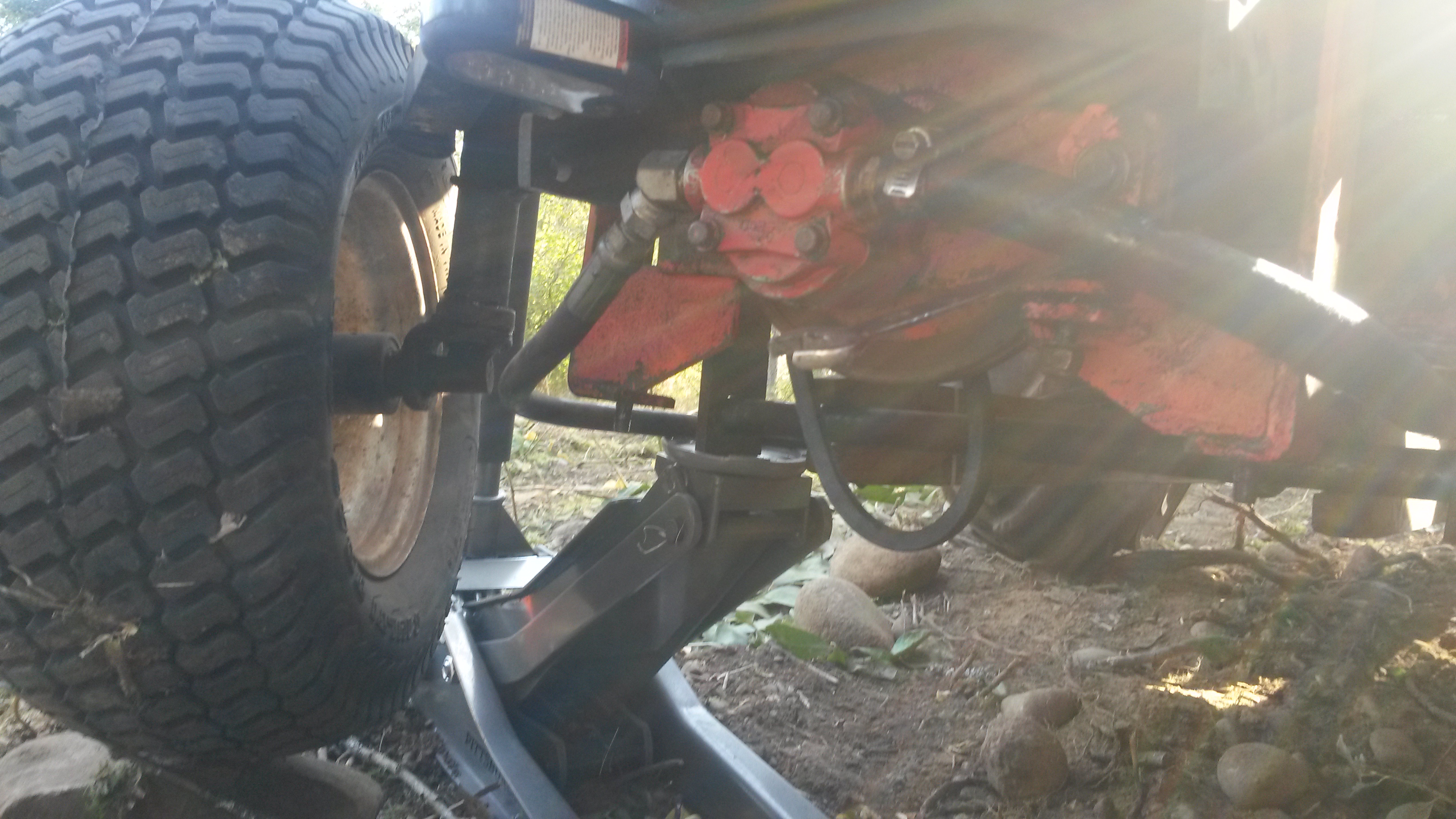

From research I found out that the FEL has a separate hydraulic pump that attached to the front of the engine or possibly driven via the belt your looking to replace.
Since I'm unable to give pictures or instruction by looking at my tractor directly I'm going to assume that the Simplicity engineers of the time used the same technique to tighten the belt as they used for the snow blower jack shaft.
The pulley underneath the front of the tractor rests on a pivot that allows the pulley to swing up or down, on this pivot bracket there;s a long threaded rod with a spring sleeved over it.
There;s a pair of nuts on the treaded rod you loosen and have to back off to gain enough slack to put the new belt on.
I suspect the hydraulic pump used fro the FEL would be of a similar arrangement.
Nothing special has to be done to slip the new belt over the electric clutch pulley at the front of the engine, that pulley sits forward of the magnet.
While you changing the belt it might be a good time to adjust the air gap on that front electric magnet pto clutch.
If your AC 720 has not been re-powered and still has the original Onan engine the front pto clutch has four studs each with a spring that sit behind the face plate.
The faceplate has  four slots this is where the you place the .010 feeler gauge to set the air gap. Do not insert the feeler gauge more than 3/16" . You make the adjustment by either tightening or loosening the four nuts on the outside of the faceplate.

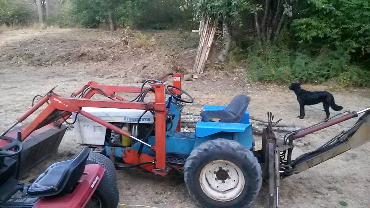

Here is a photo of the machine and the second one is from the front with the guard removed looking at the hydro pump. I am almost done getting the belt on there.

More pix.
Sorry for my MTD being in the way on the last pic, but I was way to lazy after working all day to move it.
I know it needs a bath and some paint, but I am busy using it right now. LOL.
