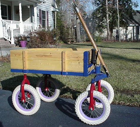

I thought everyone would appreciate seeing my recycled bicycle and bed angle iron wagons.  The bigger one is about 8 years old and has had a lot of use.  I've changed the wheels many times since these bicycle wheels were not intended to carry the amount of weight put into this wagon.  There is usually somebody thowing away an old bike or I could buy one real cheap for one dollar or two at a yard sale which would give me some more wheels.  I only recently learned how to utilize the back wheels of the bike by removing the sprocket and brakes.  It takes two back wheels to make one wheel.
The smaller wagon as well as the older one I utilized the crank bearing for the steering.  I used a very old snow shovel handle as the pull handle.  I forgot to mention on the first one I made I didn't have any brakes, we were shopping at a flea market and on several occasions it rolled away so I outfitted it with a parking brake which came from a three wheel baby stroller that ladys jog with.  The new wagon is going on two years old and hasn't been used yet.  My wife says it's too nice to use.  Boy, if there were more people like her you could go around the country and find a bunch of old "brand new"  Allis Chalmers which were too nice to be use!
I'm thinking of making another soon with automotive steering.

Now that's cool! I'll bet you could sell them at the flea markets.

Do I detect brakes?
That means we can "ride down hill" with them; right?? LOL

Nice work Sir.  Kinda classy looking too with the white wheels.

Those are neat. I like that they are high enough that you don't have to bend over too far to reach in them. they look nice too.  Great job!
