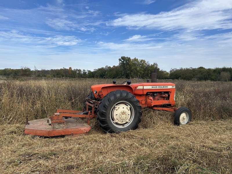

Post Options Post Options   Thanks (0) Thanks(0)   Quote Allis dave Quote  Post ReplyReply Direct Link To This Post Posted: 2 hours 33 minutes ago at 9:22am
I finished up this mower last summer. I ended up purchasing a new Vevor PTO shaft with slip clutch. I mowed a couple acres with it last fall and it worked well. It had a homemade tail wheel I'd like to repair and put back on it. It tends to scalp bad on slopes with no tailsheel.
I just wish it was 6' instead of 5'
