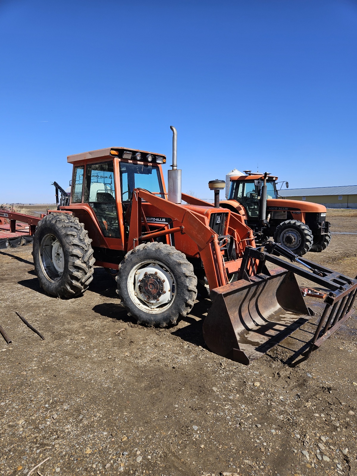

Well we finally got one. Late model (deutz-allis stickers) with fwa cab and loader. Everything seems to work and it looks pretty good for a 40 year old tractor with 8000 hours on it. But I do have a question about the hydraulics. It has a homebuilt grapple on the loader controlled by what looks like a third factory hydraulic lever. Located on the right side of the seat and operated by pulling up or pushing down on it. Only 2 sets of couplers at the rear of the tractor, this is plumbed in somewhere under the cab. Is that factory or a dealer installed option or is it a custom deal?

6080 had a third remote option. maybe they just ran the hoses forward

Even though it is a late model - I would check the fore/aft play on the crankshaft. The late 4.33 motors had a double wide thrust - BUT, at high hours I would still check it. The front bearing set up can still be added. Congrats and just my 2 cents worth.

Thanks for that. I looked it up on tractor data and it said 2 remotes. I have never seen one with a third remote before so I would guess it isn't very common?

I did a quick redneck check for play using a manure tine as a pry bar before buying it. Couldn't feel any play and no leaks from the front seal so figured it should be okay. Anyone know the allowed amount of movement? We had one of these that we sold to an uncle probably 35 years ago that had 6500 hours or so on it at that time. He put another I think 10 or 15k hours on it before he scrambled the transmission and junked it. Other than a head gasket it had never been touched. So hopefully that is an indication of how long they can go without much work.

End play about .004 - .010  - Think I remember if it is .1 the thrust brg lips are laying in the bottom of the oil pan.

Between uncle and I got 6 6080’s all with 2 sets of remotes.  Never heard of a 3rd remote.  After spending a pile of hours battling the hydraulics on one I think I got it figured out how to feed a joystick for the hydraulics.  Or simpler yet buy the Summit hydraulics version of a Fasse valve.

End play is good. Just got the tractor home a couple days ago and started going through it today. No major surprises yet! Only hiccup so far is that I don't have a 1000 rpm pto stubshaft. Have 2 540s though!
