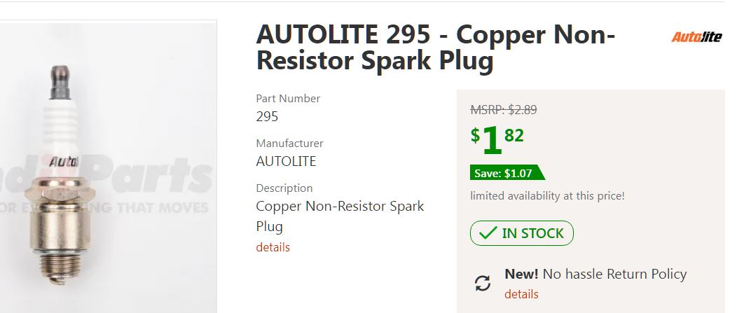

Have to ask a silly question:  Would those autolite 295 spark plugs be "non-resistor"?  I'm looking at a set of 8 AC-45 and my they are high priced.  If the autolite 295 is just as good, that would sure be the most economical way to go.   Thanks in advance!

The 295 is a copper core (non resistor) plug... so in conjunction with solid-core wires, an appropriate choice for magneto applications.
Regarding price, quantify 'high priced'... I'm seeing them falling in the $3/plug range... up to $20 for a box of four (so $5.00 a plug)... I don't see that as being far out... if you're seeing a box of 8 for $40, then you've got enough to do TWO tractors...
