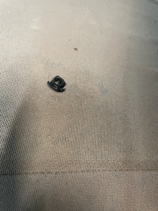

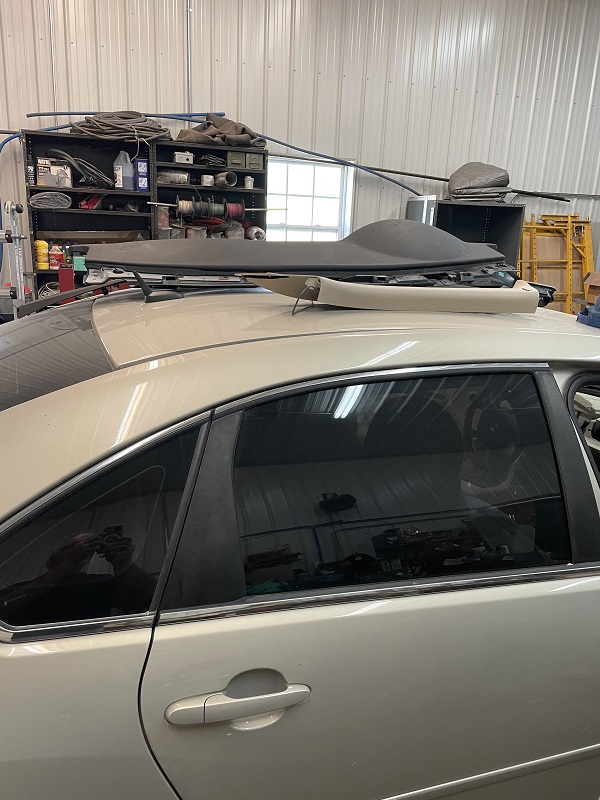

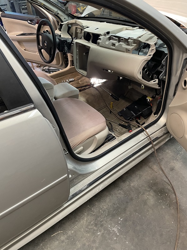

GM has its own issues.  Just 'Started' replacing seeping Heater Core 2010 Impala.  Good Lord what a nightmare.
According to friends that still have book time guides, the replacement time for this heater core is EIGHT HOURS.  First and foremost(I Did Not and regret it) REMOVE Both Front Seats, next disassemble ENTIRE Dash, is actually better to Remove Steer Column as the MFR did NOT make allowance to remove dash around that.  Next up remove CARPET(again I REFUSED to and somewhat regret) then can access the minimal screws to remove access panels and discharge plenum of HVAC Box, or so I thought.
GM Engineers saved PENNIES, by installing the Discharge Plenum and the Heater Core retainer cover with Three instead of seven or eight screws, the Remaining retainer bosses were enlarged during plastic casting and used as Heat Mushroomed Retention Heads, that require using a Wood Chisel(Make certain is SHARP)to cut them away.  Is on No Way any way to add retainer screws to where these bosses were once hacked away.
To call this a royal PITA is one thing, to have put such a conflagration of crap on the public is worse value.
That little Black Button is one of TEN Heat Upset Buttons, most importantly the Engineers set these up in the most INACCESSIBLE positions, where would almost be easier to remove the Entire HVAC Box from the car to replace the core, other than retainer bolts thru firewall are blocked by heat blanket.  Dash Panel should have been Three Panels, not a Huge PITA Single unit, more cost savings by enganears.

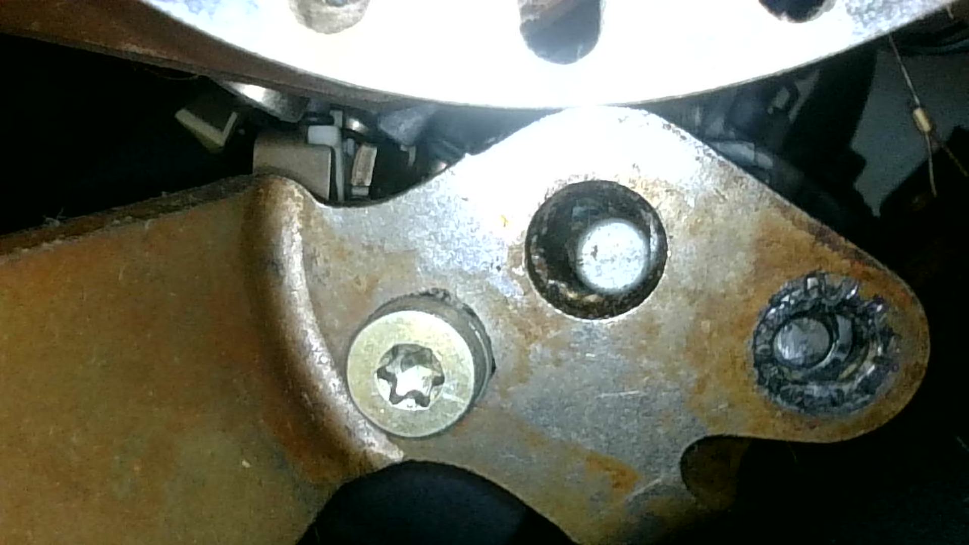

Post Options Post Options   Thanks (0) Thanks(0)   Quote jaybmiller Quote  Post ReplyReply Direct Link To This Post Posted: 02 Jul 2025 at 7:58am
Seems back in '97ish Ford decided to save 2 cents per truck and NOT locktite 2 bolts. The bolts that hold connect the shift lever to the cable that goes to the tranny. Seems after awhile, they get loose. The warning signs are wonky shifting and won't-start-in-park. In my case it was the 'wonder where this T30 Torx bolt head came from' ?? Turns out it's the head from the right side bolt that has been sheared off from using the shift lever for the past 1/4 century.......
Going to be 'fun' getting the  'headless bolt' out of the hole, cause if you remove the left bolt, there's a spring under that plate that'll fall out.
This would be a 10 minute job IF I didn't have to crawl under the dash, bend arms into unnatural positions , try to see with bifocals and best of all ,tossed my back out big time.More 'fun', the left side has a fishing line attached that goes to the PRNDL on the dash !
I did manage to tighten the left bolt, shifts great, starts in park ! so I figure I've bought myself some time.
