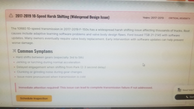

Buddy of mine has a 2019 F-150 w/Eco-Boost 3.5ltr engine and 10 spd trans that is beginning to give him fits. Shaking, binding, sluggish action more frequently than in the past. Engine oil changes every 5K, transmission oil and filter Bi-annually with both services performed at the local Ford dealer. He asked me to look at it and I've read enough, and know enough people with this transmission and it's characteristics to know what he's in for.
There are product redesigns, software revisions, driver adaptability algorithms updates, (software) and Ford is involved in class action lawsuits over this transmission.
Here is a small blurb I found on the internet that explains just a few flaws folks are experiencing with this transmission series:
That's All Folks!

   Same tranny as GM but the valve bodies are different, both have issues with valve bodies.
    Next Gen Drivetrain makes kits and rebuilt valve bodies.

It is the same basic trans as the gm.  They are junk.  Being run in school buses as well and failing with less than 10k on them.

That same site had a writeup on that trans also. Less problematic than the 10spd and IIRC the valve body was the largest culprit.
