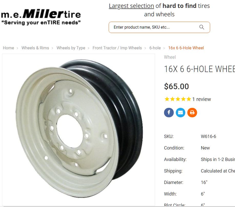

 Anyway, I got the block welded up with that Sooper Dooper aluminum rod and it came out Many wonderfuls!! I am now to the point of re-assembling the lower end and started to look ahead at those wheels it gots on the front,,, For some reason the old gentlemen had installed 9N or 2N hubs on the Ferguson front axle  which uses them huge, ugly wheels that look to be bout 23" tall and then them skinny tires only bouts 3" tall themselves. A fellar on another forum told me the Ferguson hubs will fit the 9N hubs and vice versa,,so I got some Ferguson 6 hole hubs and was gonna get some nice lookin chrome wheels,,Ya know in case I decide to drive this thing in a parade,,,wouldn't that be a shout,,,!!!!
 Anyway,,do any of you know what automotive wheels might use the Fergies 6X6 bolt pattern???

6 x 6 is a standard AG rim.. You can buy them in 15, 16, 17, 18, 20 inch diameter... or probably some trailers or autos... but watch the CENTER diameter..
