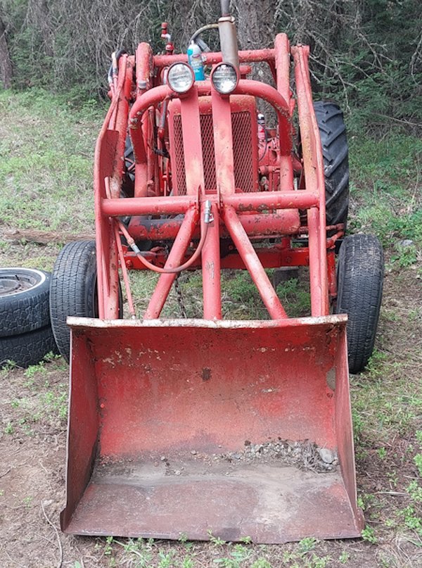

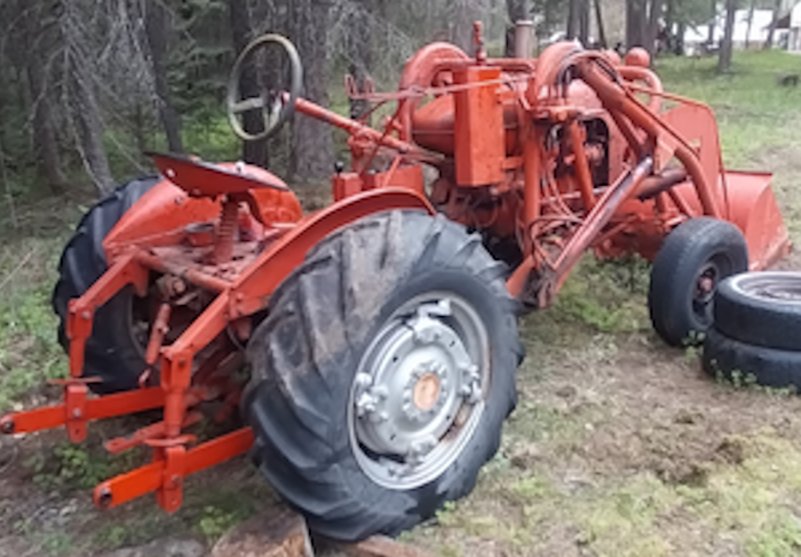

I have long coveted an Allis Model CA, this one sorta fell into my lap for cheap. Loader, aftermarket 3-Point.
The engine was lightly stuck but my 14 year old Grandson had it freed up the next day. The carburetor needs cleaned, etc. before trying to start.

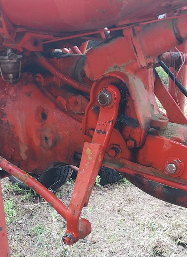

It has some issues with the steering box.

CA steering box arm normally points UP... Yours points DOWN like a model B.... maybe to get it away from the loader frame ?

Never seen a loader on a CA, neat find. Good luck with it and hope you get it going. The extra length arm is for extra leverage steering I’m assuming due to the extra weight of the loader?

Not sure on that, extra length on the drop arm would surely = less leverage?

Love the loader set up, that & the 3 point would come in super useful about now! (and bits of your carb haha!)

A loader on a CA: That's surely asking for steering gear issues. Whoever added that extra length has thing basswckwards. That lever needs to be shorter for extra leverage. If you plan on keeping the loaded on it, it looks to be a good place for a FarmerFix of a replacement power steering box from a car or light pickup.
 I suppose that the original front axle gave up from the abuse the loader added, since it was replace with a D12 axle, needing the arm to point down.
Not sure what this steering box came from but it has massive amounts of slop. I like the idea of finding a power steering box to scab in there.

No. That is a CA box farmerized to work with the D12 axle. The CA box is a little bit better than what B&C boxes are as the CA box has 2 pins to the B or C single pin, however not up to loader service by any means. The D10/12 box is only slightly better than a CA one and parts are next to impossible to find.

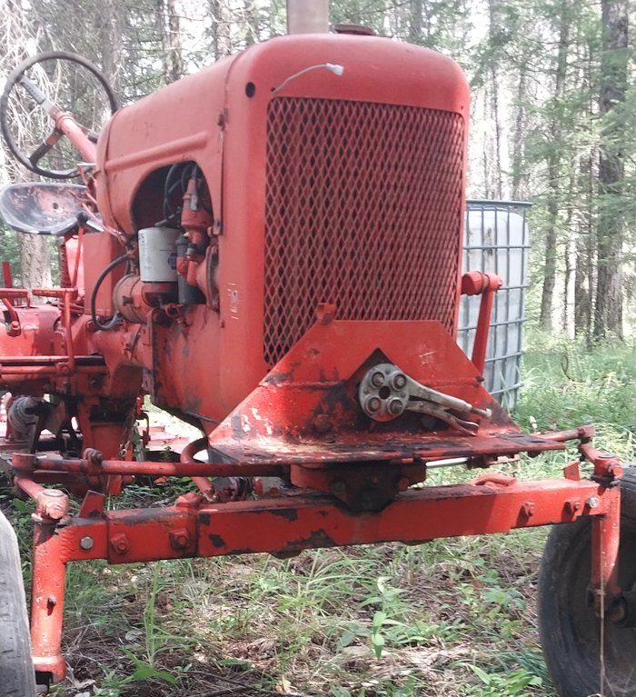

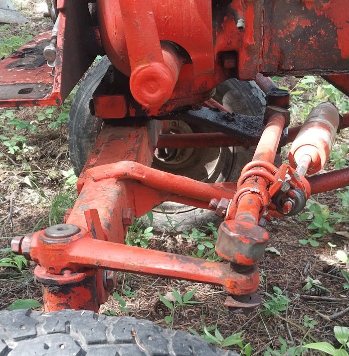

What are the distinguishing features that identify this as a D12 axle rather than a CA axle?
All of the tie rod ends are shot so I need to know exactly what I need for parts so as to fix that portion.

The D12 front axle has a single tie rod between both sides with a connection in the middle from the bellcrank bolted to the left side of the main tube. Also the front axle support will be a flat plate, similar to a B, will a fabricated radiator support like a B unless it is a casting from a series III
 The CA WFE will have 2 tie rods connected to the arm under the front casting. The CA front casting will have the cultivator support mounts that will protrude through the grill shroud.
  Show us some pictures of the front end with the loader raised.

We removed the loader, hope these photos can help identify what we have here so I can know what tie rod ends to order.
And a frontal view

I was mistaken, that is a CA wide Front. Is that a Power steering cylinder clamp to the tie rod or a steering stabilizer? In the first picture you posted at the beginning it looked like the drag ling connection there on the left side.
 A loader on a CA is not for heavy use by any means. A great recipe for a destroyed steering box.

I was mistaken, that is a CA wide Front. Is that a Power steering cylinder clamp to the tie rod or a steering stabilizer? ...
Thank you Paul; that gizmo is a steering stabilizer (shock absorber?). This loader will probably be set aside awaiting the future WD project.
