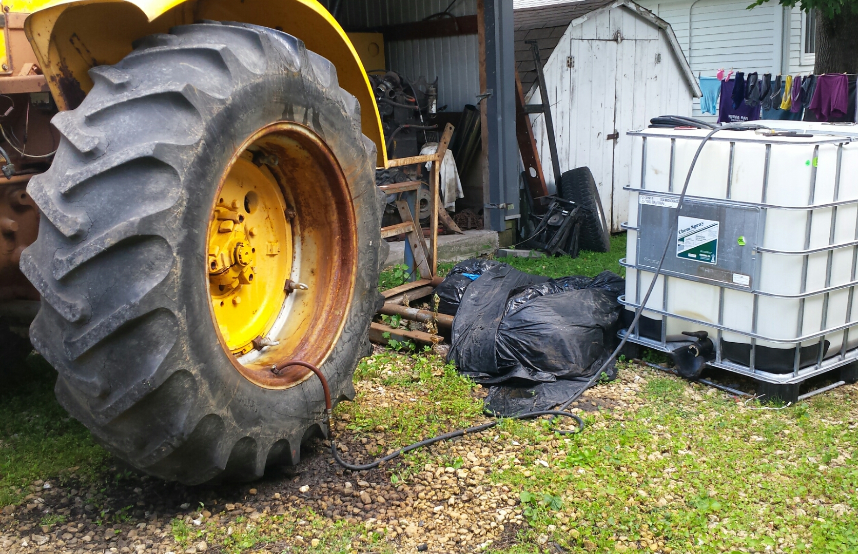

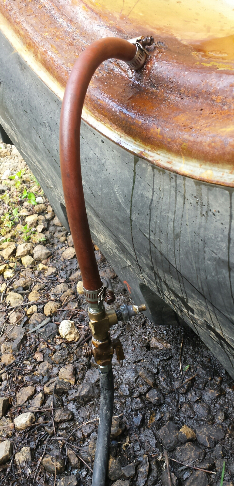

I rigged up my own little contraption to remove fluid by taking a T-fitting and putting a 3/8 nipple on one end and a valve with a nipple on the other end and a valve stem in the middle. Connect a short hose to the side without the vale and put a piece of 1/4 inch copper tubing about 18 inches long with a compression fitting collar into the hose 3 inches or so and clamp it with a hose clamp. The copper tube will fit in the tube after you remove the valve stem and the hose will snuggly fit over the threaded part of the tube,put another hose clamp on that also. Then use a long hose for the other end and put it in a container large enough to hold the fluid, I use 275 gallon bulk tanks I get from work. Close the valve and hook up the air to pressurize the tire,unhook the air and open the valve and the pressure forces the fluid into the tank. Repeat until empty. Its a little slow process but it works and if you do it right with the copper tube lenght inside the tube it will get all the fluid out. Take about an hour to empty an 18.4 34 tire. PS,tire is jacked up and valve stem at 12 o'clock when hooking this up ,6 o'clock to empty. I've done several different sized tires this way.

Its impossible to post proper sized pictures on here from my phone.

That's a good set up there Grinder. I bought the adapter to attach to a washing machine hose and used a 12 volt pump from HF to drain into plastic barrels then back into the tires later.
