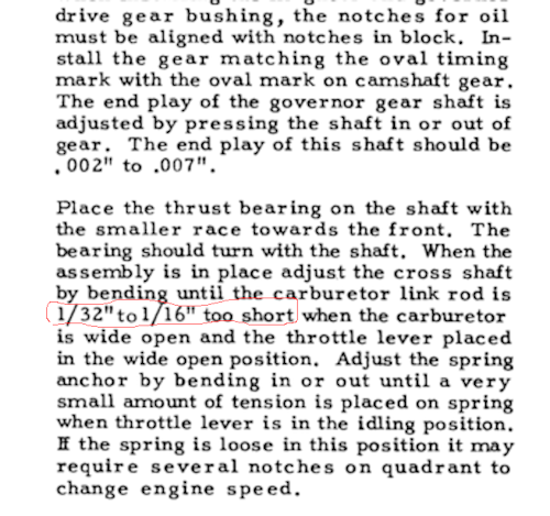

Except one factory manual says to bend the cross arm to shorten the carburetor rod, while another manual from a different year says bend the cross arm to lengthen the carburetor rod - the typos get confusing some times.  Anyway - it's running and moving on its own now without any fuss.

All small engine need to have the carburetor rod just a bit too short.
 All the Large (201-226) engines need to have the rod just a bit too long.
This is the discrepancy you are seeing and not fully grasping.
Les Kerf View Drop Down
Joined: 08 May 2020
Location: Idaho
Points: 1627
Post Options Post Options   Thanks (0) Thanks(0)   Quote Les Kerf Quote  Post ReplyReply Direct Link To This Post Posted: 04 Aug 2025 at 4:33pm
All small engine need to have the carburetor rod just a bit too short...
Well, I do believe that to be true, but I have two manuals that are indeed contradictory.
This first screen shot is from the I&T manual which is known to be unreliable; however, not everyone is aware of that.
This second screen shot is from another manual, possibly an official version?
I have been able to glean useful information from both manuals as sometimes one gives a more thorough explanation than the other.

On the whole the I&T (BUT FIRST) manuals should be trashed as much of the information is very general and not as specific as really needed. When in doubt go with what the OEM engineers published.

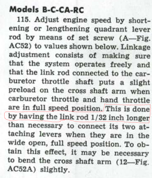

This is from the 1960 issue of the Allis Chalmers Shop Manual produced by Technical Publications Inc. and available in several places online.  You can see clearly it's for the B-C-CA-RC engine - not the WC-WD engine.  Also it says the carburetor connecting rod should be 1/32" longer than necessary.
This next one is from another AC shop manual - the provenance is unknown, but it does seem to originate with AC themselves - this is the correct instruction.  Confusing, no?
Points: 90618
Post Options Post Options   Thanks (0) Thanks(0)   Quote steve(ill) Quote  Post ReplyReply Direct Link To This Post Posted: 05 Aug 2025 at 1:28pm
that last sentence about having slight tension on the governor spring when the throttle lever is in the LO  IDLE positon .... i have fixed that by loosening the square set screw on the LEVER and sliding the throttle rod in or out  1/8 inch.... You would be suprised now much  effect, 1/16 inch will make in the carburetor rod or the throttle rod...
You can say that again!  I assumed that the settings were copacetic since nothing looked *too* far out of adjustment. Little did I know that these adjustments are far more critical than they are on small single-cylinder engines as found on garden tractors and lawn mowers.  I've prudently kept my mitts out of the governor in my big Kubota (my other favorite orange tractor) because it just works and it's buried in the high pressure pump.
