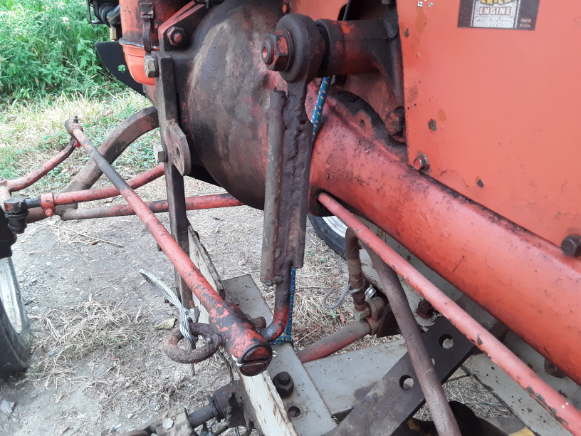

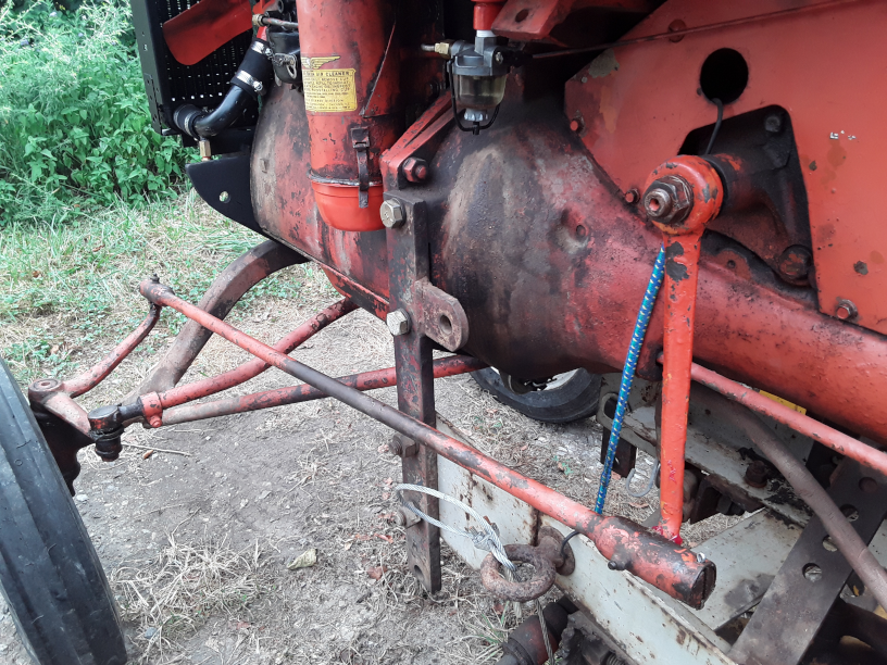

This goobered up steering arm made me sad.
I happened on a good one and immediately installed it once it got here.  Now I'm not so sad!

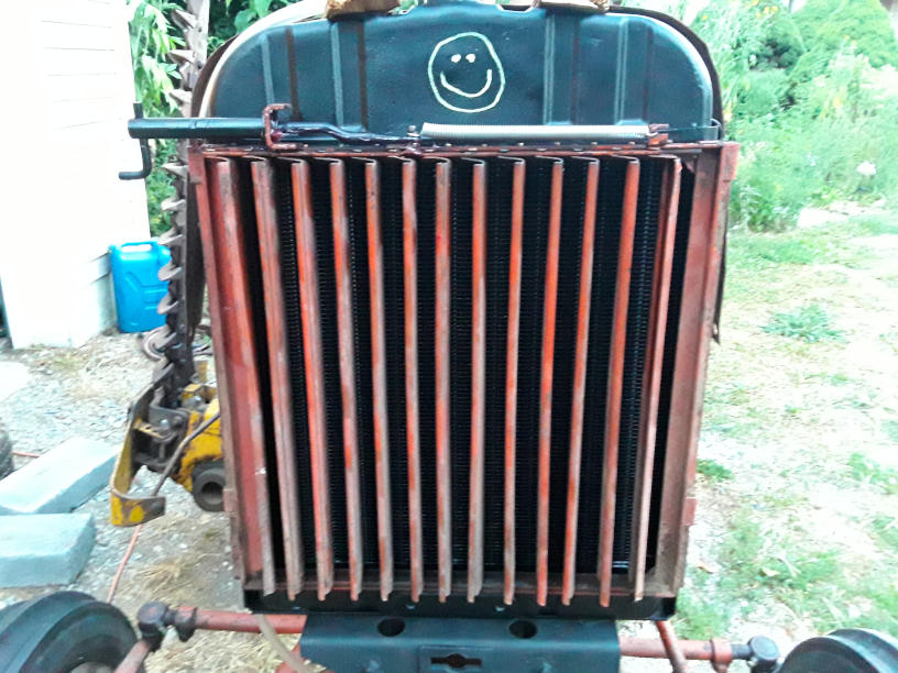

Post Options Post Options   Thanks (1) Thanks(1)   Quote Jay Tee Quote  Post ReplyReply Direct Link To This Post Posted: 12 Aug 2025 at 8:15pm
Small job - Installed the shutters, bent up a bit of 5/16" threaded rod, added a hardware store spring, a shutter crank I found online and a lot of grease. Next maybe fit the grille...

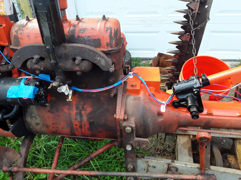

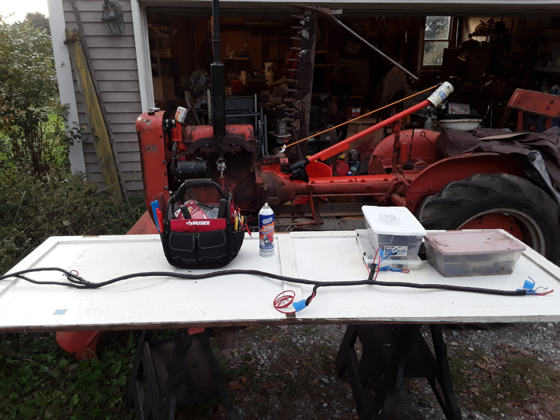

Finally got some time to spend on the Allis B - so I worked on the wiring
Here's the harness being laid out

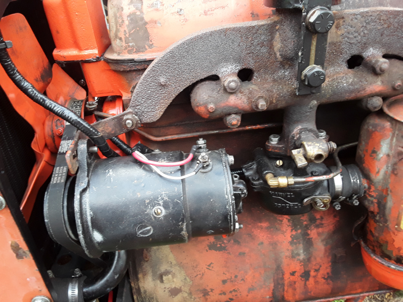

After laying it out I covered it with split loom and two layers of Scotch 33. I forgot that the wiring loom is run under a cover in the tool box, so the location here would have required a hole cut into that.  The regulator is now inside the tool box, using the same holes the previous installer had used to mount it to the outside.
Finally here's a start on wiring the generator
