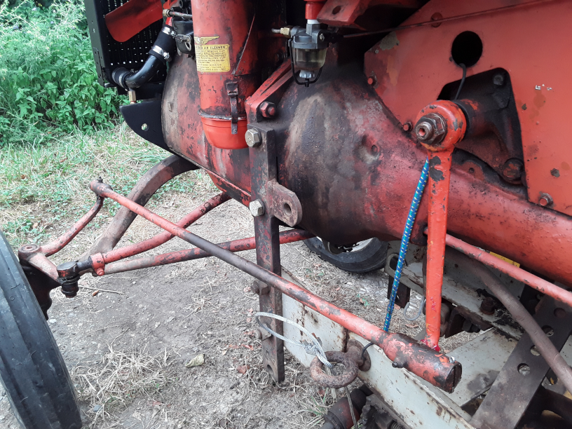

This goobered up steering arm made me sad.
I happened on a good one and immediately installed it once it got here.  Now I'm not so sad!
