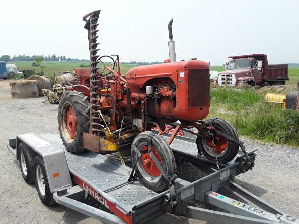

I just brought home a B that has lived a pretty hard life.  Some joker slapped a WD decal on there at some point - I'm not sure if it was for comedic effect.  I have no idea who manufactured the mower - it looks a lot more burly than the ones I've seen fitted to these small tractors in the past.

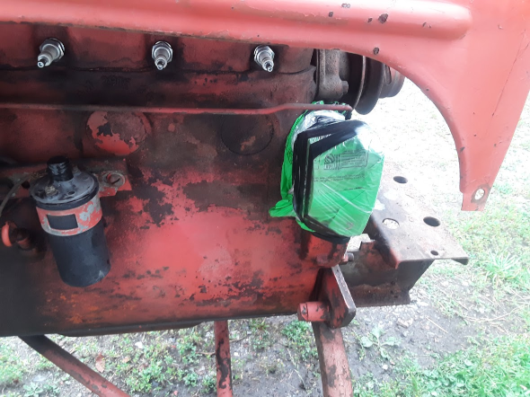

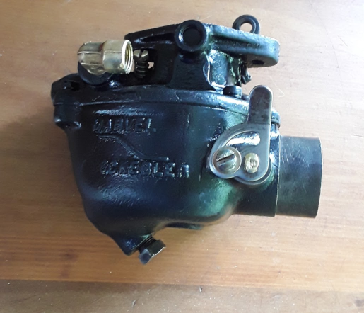

I bought it with the Marvel-Schebler TSX154 carburetor in bits - luckily I was able to rebuild it and get the tractor started so I could load it.

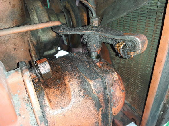

The big problems are
  • The governor doesn't do much if anything

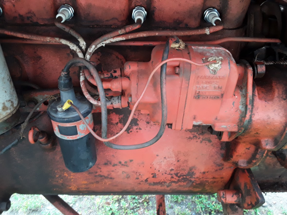

  • The magneto has been hacked into some kind of points distributor

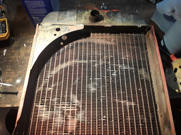

  • The cooling system leaks out of every hose and maybe even the water pump - hard to tell since there's so much coming out of it.

Governor problems...

Removed mag and governor between rain storms...

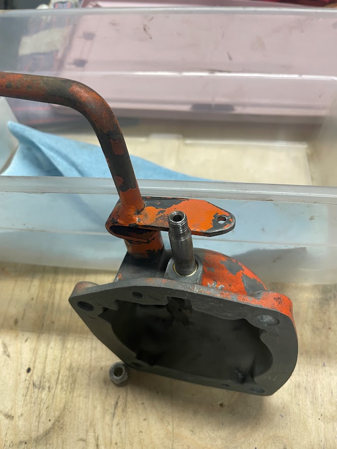

Post Options Post Options   Thanks (0) Thanks(0)   Quote Jay Tee Quote  Post ReplyReply Direct Link To This Post Posted: 13 Jun 2025 at 10:24am
Dropped the governor housing off with a friend who has an amazing machine shop in his basement. He recoiled when I said I would just glue the pivot post in with JB weld.  In the meantime, the radiator needs help.

I have an early non pressurized B radiator that may be fine as is, or at least need less work than yours.

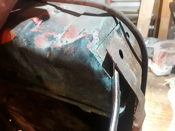

Post Options Post Options   Thanks (0) Thanks(0)   Quote Jay Tee Quote  Post ReplyReply Direct Link To This Post Posted: 18 Jun 2025 at 4:37pm
I gave up on that radiator - the core was full of leaks.  I found a reasonably priced new one which I just ordered.

Post Options Post Options   Thanks (0) Thanks(0)   Quote Jay Tee Quote  Post ReplyReply Direct Link To This Post Posted: 18 Jun 2025 at 4:40pm
My machinist friend fixed the loose pivot post on the governor housing. I'm really pleased with the result!

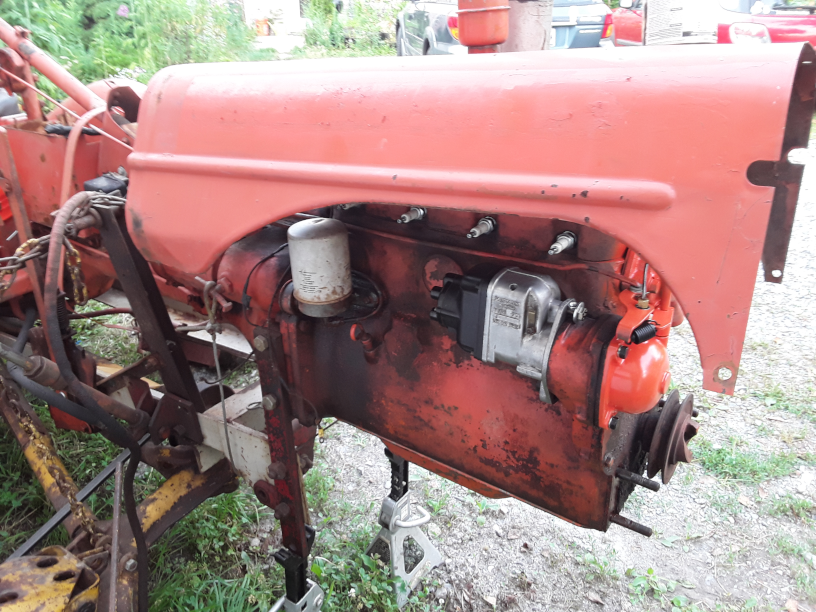

Post Options Post Options   Thanks (0) Thanks(0)   Quote Jay Tee Quote  Post ReplyReply Direct Link To This Post Posted: 06 Jul 2025 at 7:02pm
I was fitting the magneto I got from Phil48ACWC when I noticed the crank had a lot more end play than the 1-5 thousands specified by the book. More like 1/32".  I dropped the oil pan, removed the main caps and took a look at the crank, which seems fine to me.  Although there was some goo in the pan and the remains of the thrust bearings, everything looks pretty good in there as well.  So I'm thinking I might get away with just replacing the bearings.
The only marking on the bearings I see is a script FM with 2 51 underneath that.  This makes me think this is a stock crank since I don't see the usual 010, 020 etc. stamps in undersized bearings.  Is this assumption correct?

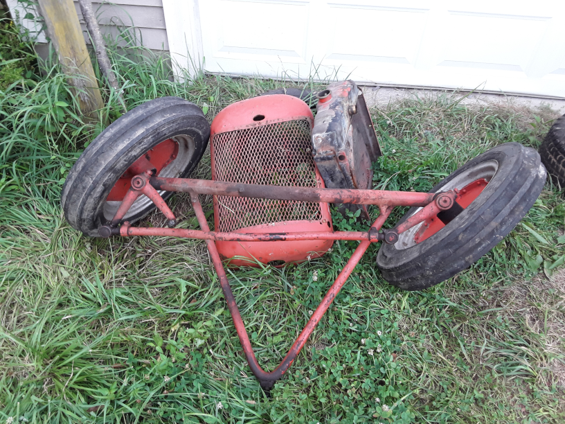

Post Options Post Options   Thanks (0) Thanks(0)   Quote Jay Tee Quote  Post ReplyReply Direct Link To This Post Posted: 07 Jul 2025 at 6:51pm
Removed the front end since the pivot bolt head blocked the pan just enough.

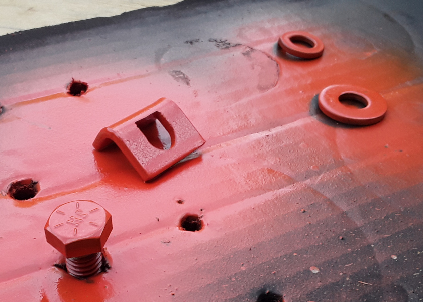

Post Options Post Options   Thanks (0) Thanks(0)   Quote Jay Tee Quote  Post ReplyReply Direct Link To This Post Posted: 13 Jul 2025 at 7:41pm
Had a little bit of time to make a magneto clamp out of 1" flat stock
