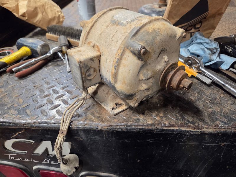

if the motor spins, the best way to test is just to plug it in... that will confirm real quick if you need to do more work.... iif it starts, you can listen and see if it needs greased and cleaned or new bearing... i dont see a start or run capacitor..  might be a small one inside the rear cover...if not, they do it all in the windings.... cant tell if the plug on the end is ready for 120v power or of all the wires are just hanging... should be a wire diagram inside the small elect box that shows which wires are connected together... it might be a reversible motor due to the multiple wires.

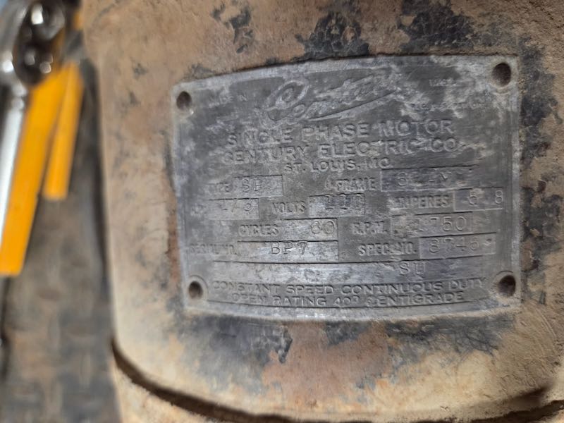

Thanks Steve. It's a split phase motor so that should explain the lack of capacitors. I presume the light load of a seed cleaner is no problem for startup.
You can't see in my picture but the bottom of the motor casing is open and it's filled with stuff, so I do want to clean that out first before I try to run it. From what I can tell this model just had top drip/debris protection.
I do agree it seems like there are an awful lot of wires coming out of the motor for what is labeled as a 110V. What is left of the plug appears to have been a 2-prong connection. I haven't gotten into the wiring box yet.

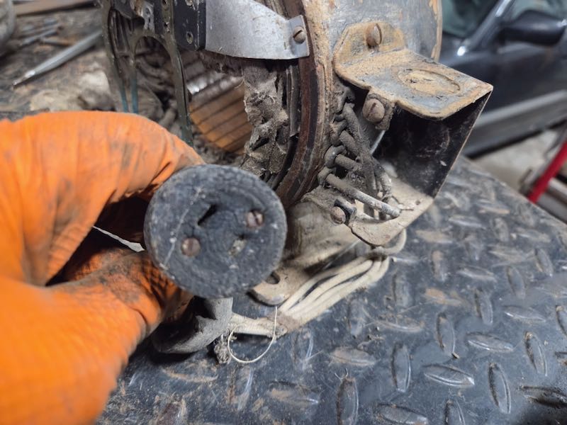

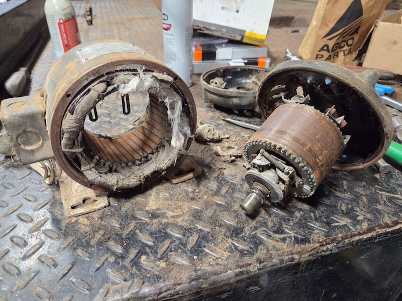

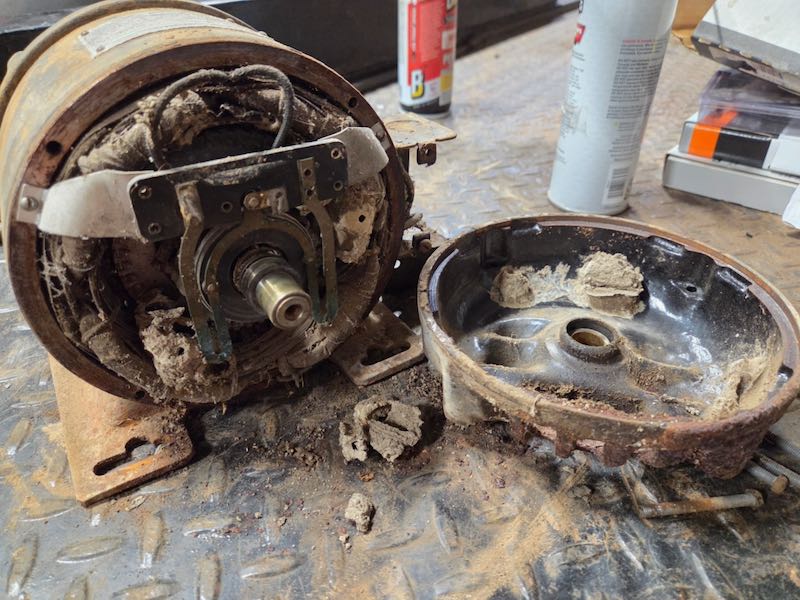

Finally had some time to tear it apart. I dinged up the shaft a little pulling the bushing off, but I can clean that up with a file and it should be okay. The bushings are plenty tight so things don't seem to be worn out. The inside looked like what I expected - mud dauber nests and cobwebs. I will get around to cleaning it up and inspecting it next.
The plug interesting - either the prongs disintegrated, or seems more likely it's female. I'm wondering if it's a pair of wires for each winding, basically?

Post Options Post Options   Thanks (0) Thanks(0)   Quote steve(ill) Quote  Post ReplyReply Direct Link To This Post Posted: 08 Jun 2025 at 1:05pm
sure looks like a plug from 1920 with NO GROUND WIRE !!!   Odd that it is female..
the centrifigual switch that DAVE mentioned can be seen in the first two photos... Make sure it "throws out" by pushing with your finger.... clean the POINTS or CONTACTS so that they do contact..
