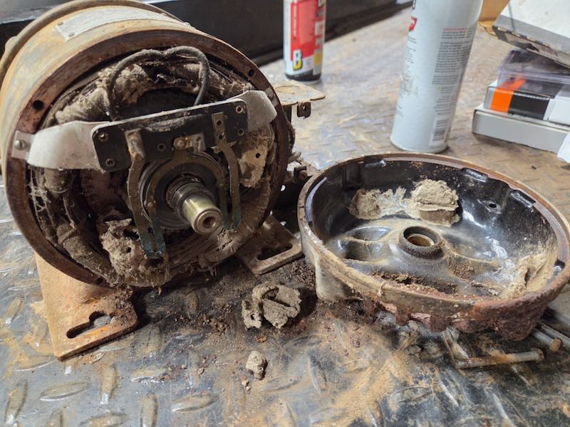

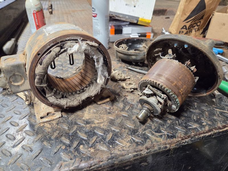

Finally had some time to tear it apart. I dinged up the shaft a little pulling the bushing off, but I can clean that up with a file and it should be okay. The bushings are plenty tight so things don't seem to be worn out. The inside looked like what I expected - mud dauber nests and cobwebs. I will get around to cleaning it up and inspecting it next.

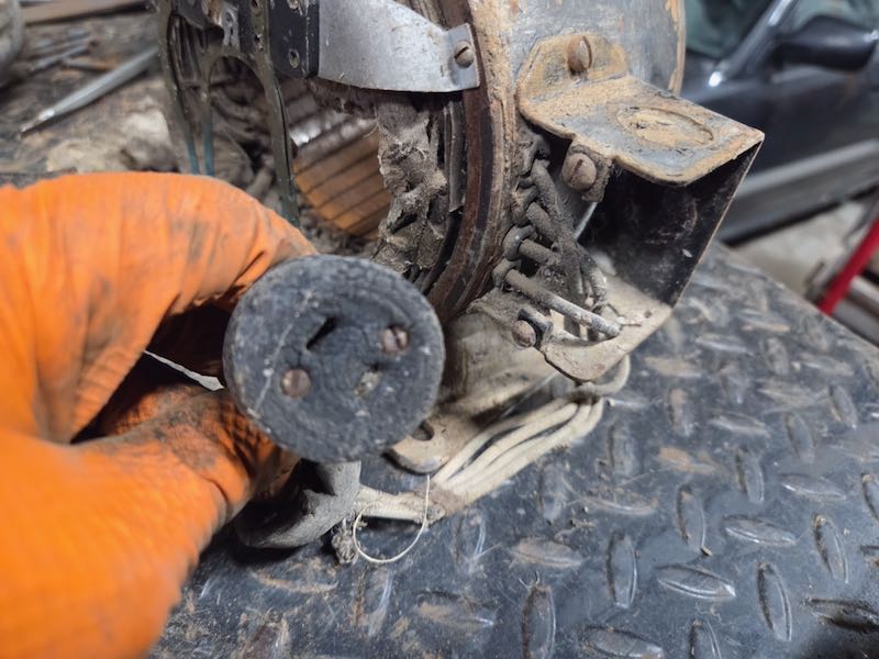

The plug interesting - either the prongs disintegrated, or seems more likely it's female. I'm wondering if it's a pair of wires for each winding, basically?

sure looks like a plug from 1920 with NO GROUND WIRE !!!   Odd that it is female..
the centrifigual switch that DAVE mentioned can be seen in the first two photos... Make sure it "throws out" by pushing with your finger.... clean the POINTS or CONTACTS so that they do contact..
