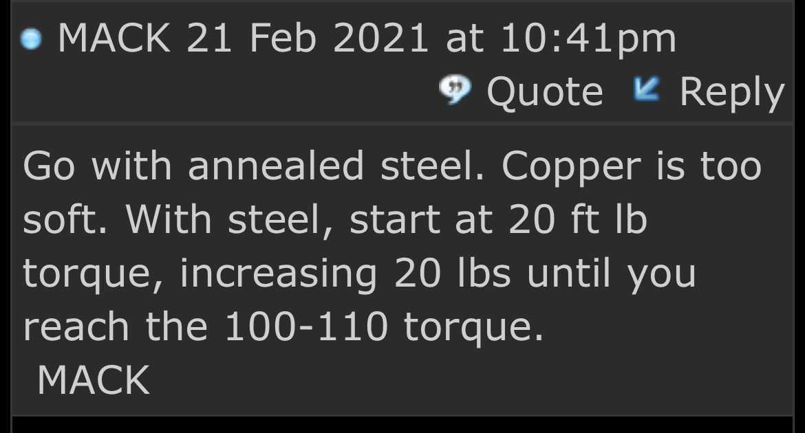

Post Options Post Options   Thanks (0) Thanks(0)   Quote 55allis Quote  Post ReplyReply Direct Link To This Post Posted: 02 Sep 2025 at 11:31pm
Here is some of his own words…
I’m not for sure if that’s what he made them all out of but we was dealing with a copper head gasket.
