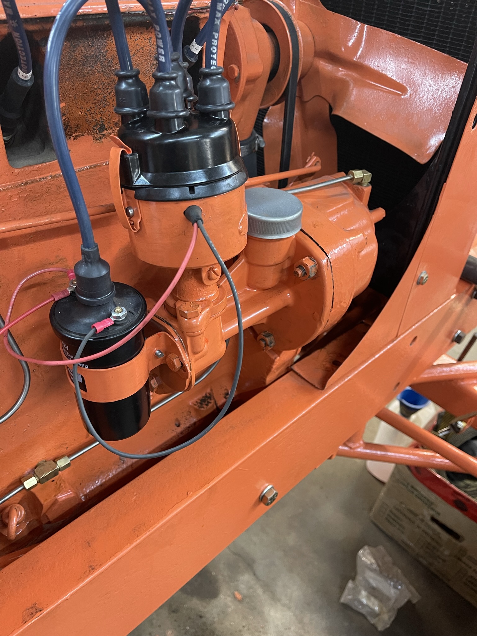

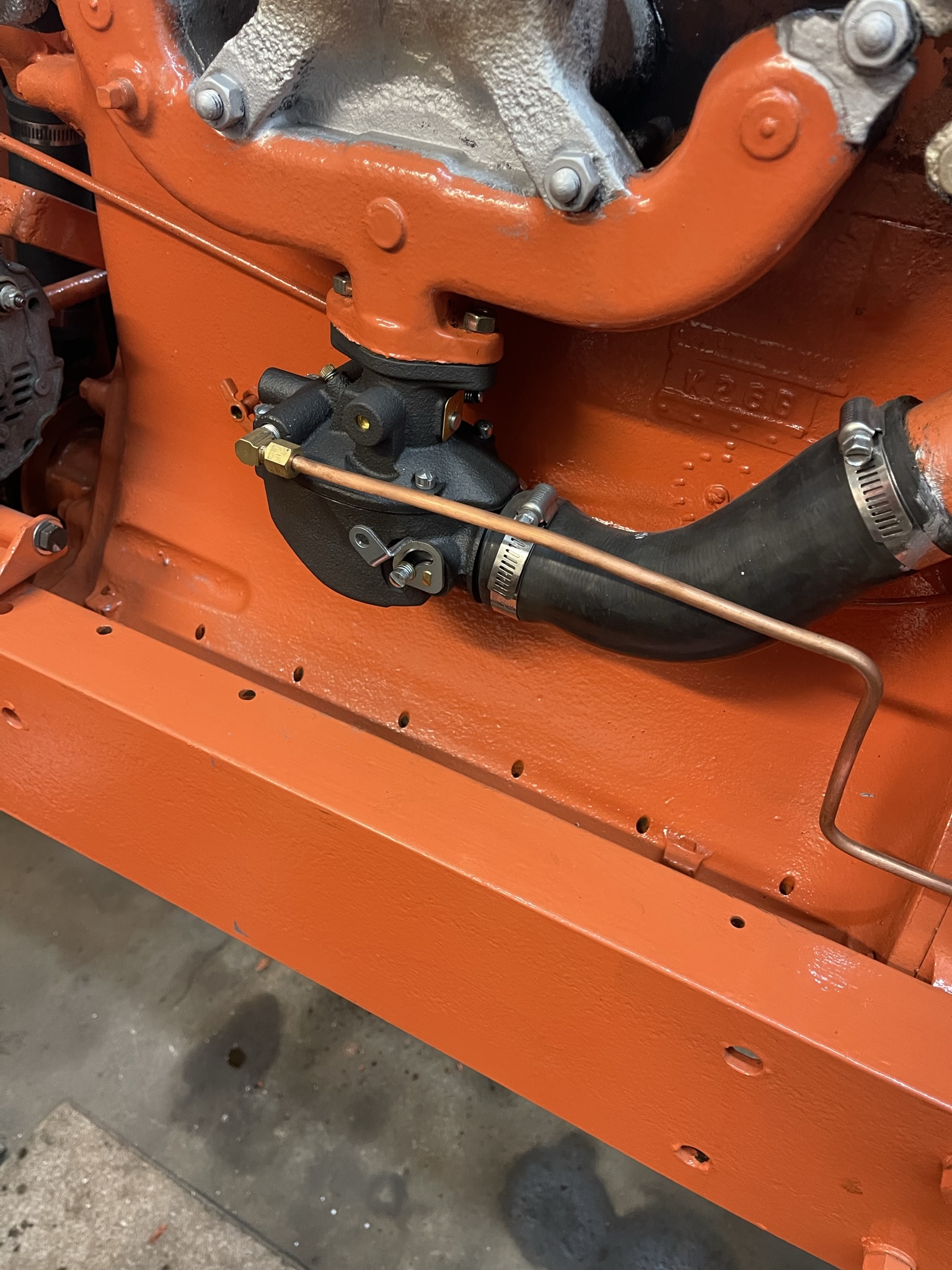

Hello all , i am so excited , i have change my carburator 2 week ago , and today put my new electronic distributor  ( bought from steve) , my tractor run very well and easy to start  , my only concern when i shut it down sometime he do a little back fire ? i pretty sure   it's timing related  , what the best way to do the fine tuning of  timming ? with a timing light ?
i am so happy to have my grand pa tractor

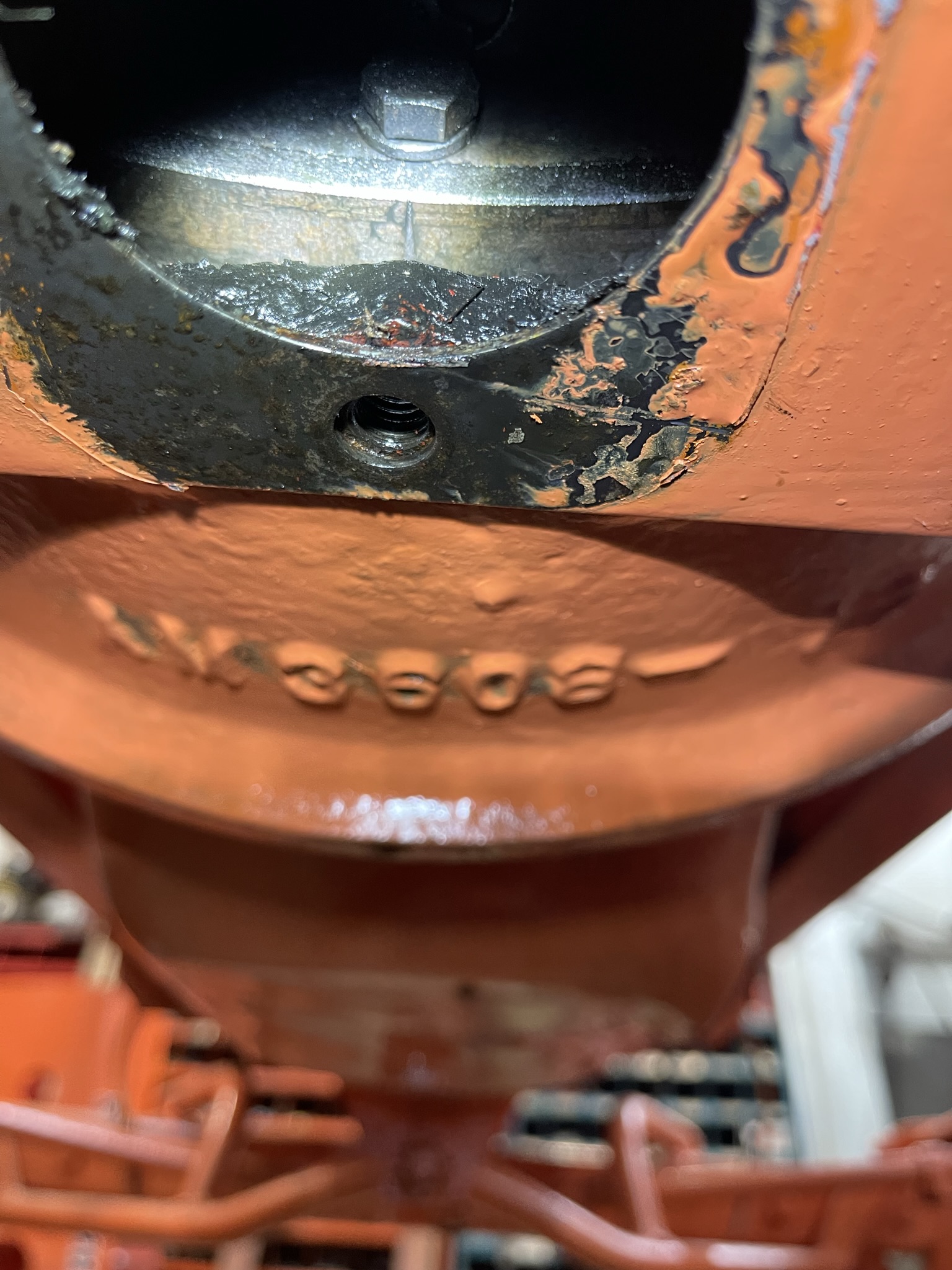

Time it with a light. Has to be timed at 3/4 throttle or more. Lay on your back and have a helper turn distributor up top. Time it to the "F" mark on the flywheel. It has to be straight down and line up with the little cast pointer in middle  of inspection hole. Smile

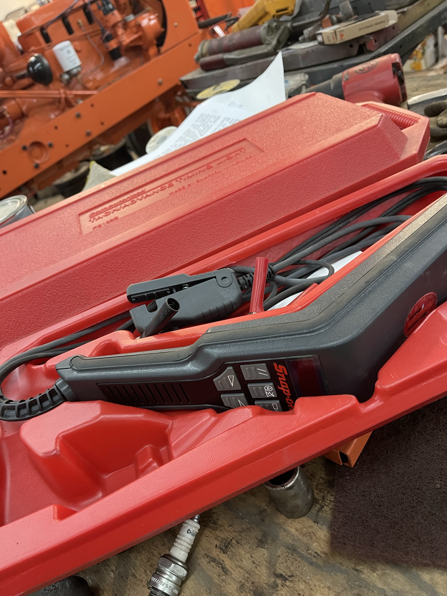

do you have a timing light (tool)?
assume you installed and timed ADVANCE at the FIRE mark ? ..... or just STATIC  before TDC ?

thanks all for your help , with the timing light i was able to align the F mark
the tractor run great !!!
