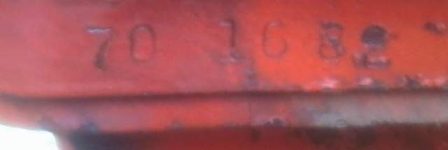

 A set of numbers I found above hydraulic sump on left side... Do other 170's have a number here or is this a build date?

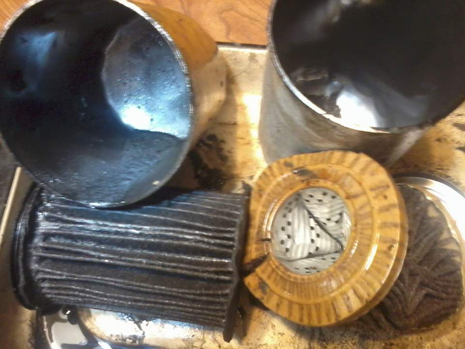

FF filters engine  and hydraulic. Look at engine filter, got metal in the pleats and definate metal where I laid it down to drain.  ... right filter is hydraulic, crushed in and can bottom extended from freezing.
Guess I will be dropping the pan to check rods and mains to see where the metal is coming from.

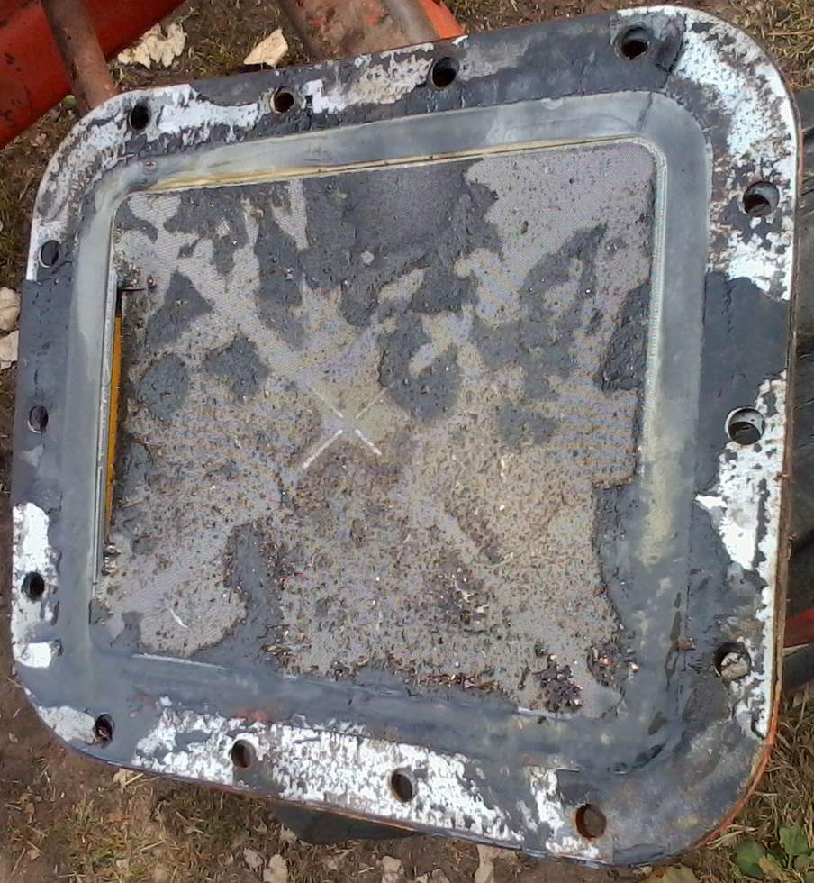

Here is the screen from the sump, must have really been plugged at one time. Notice the rip.

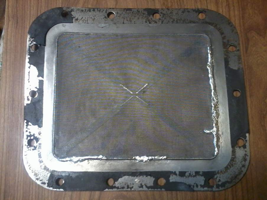

Screen now soldered. Wonder how much a new one costs?
 And the sump had what looks like heavy mud at the bottom. no picture... yet.

170s did not have build dates stamped on them.  Just the serial number stamped on the left flange of the torque tube.

I bought the fine mesh sump screen for my 220 over 30yrs ago and it was $200 then

Steve M., YIKES! Probably double that now if not NLA.
DSeries4...  Okay, I went out and checked our old 170 and that one has no numbers above the sump... so then it really makes me wonder what the 70  16 82  means.  I wouldn't think they did it just for fun. Ermm or maybe they did. LOL  ... but they are definitely stamped in there.
