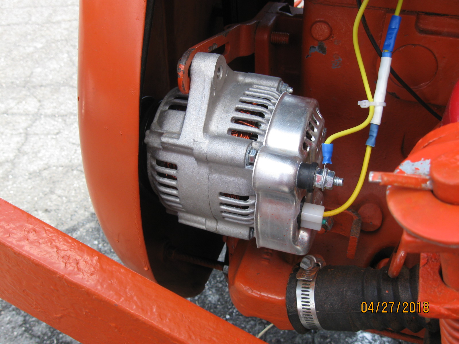

1. Will a small one wire alternator fit on a G without modification to sheet metal?

1, yes I was going to do that...
4, yes, all my D-14s are 'happy'

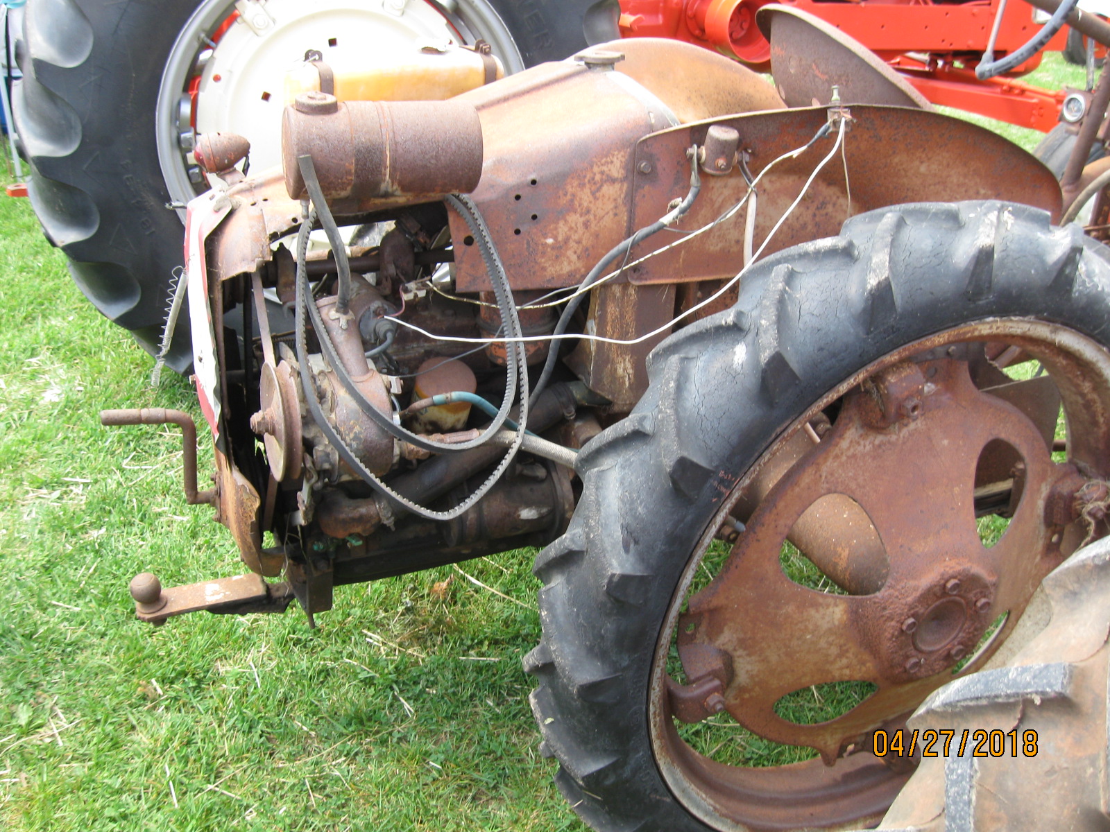

   You got to love this:
   These pictures are from the GOTO in Gray, TN..
   Ross.
