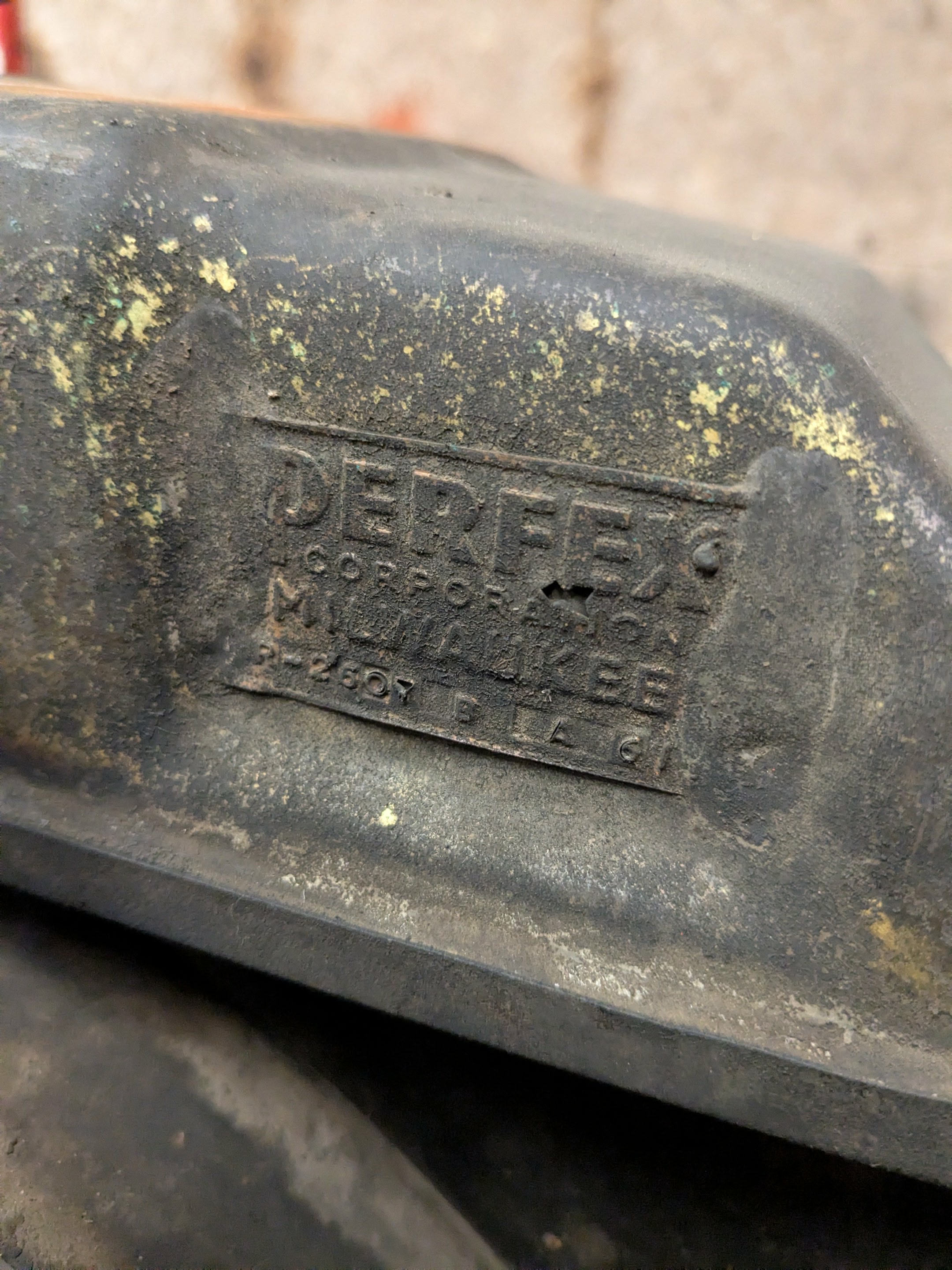

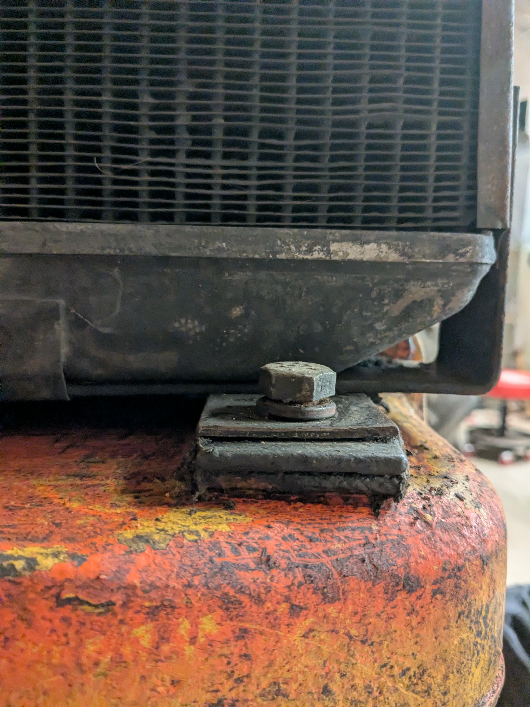

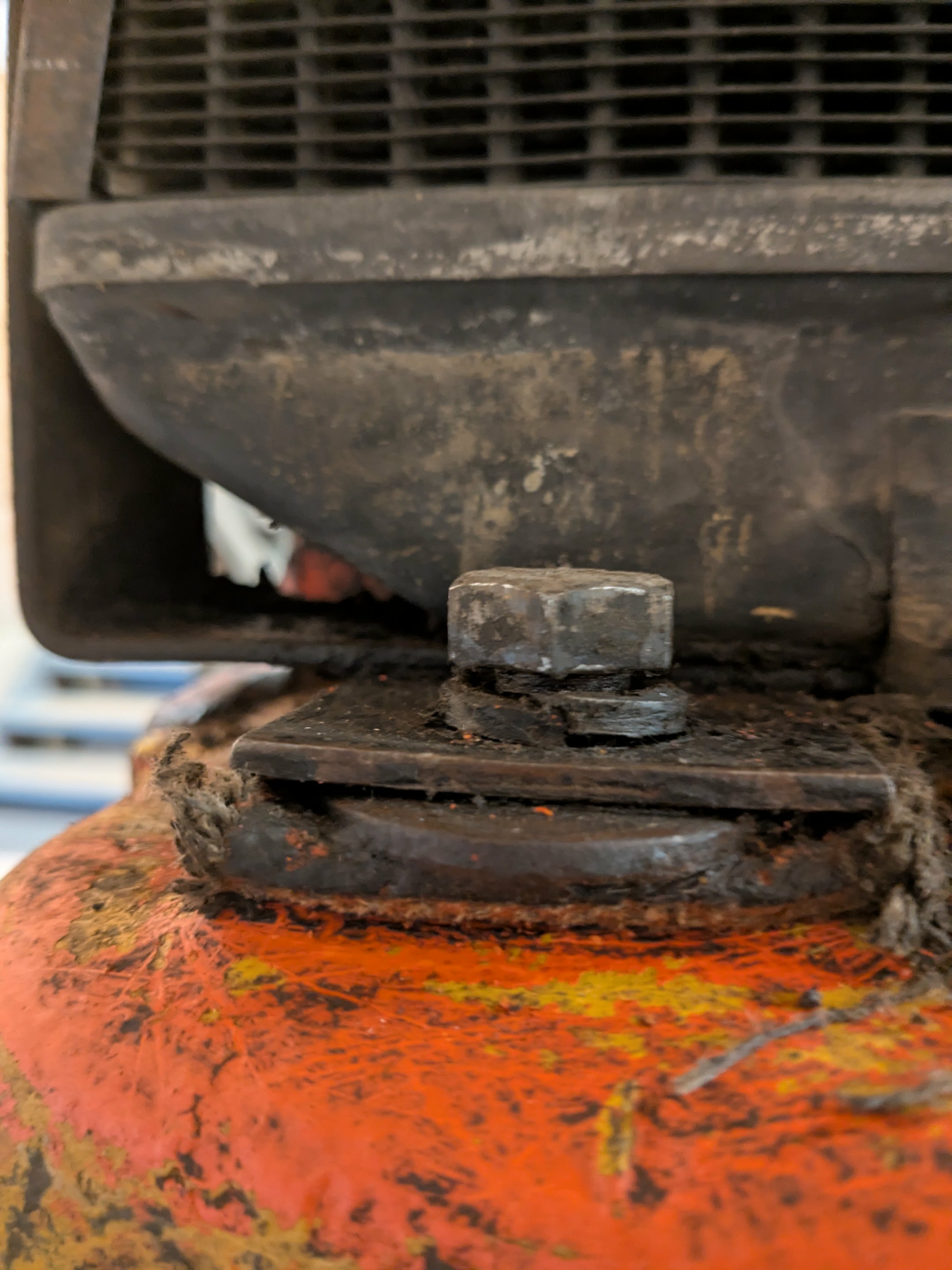

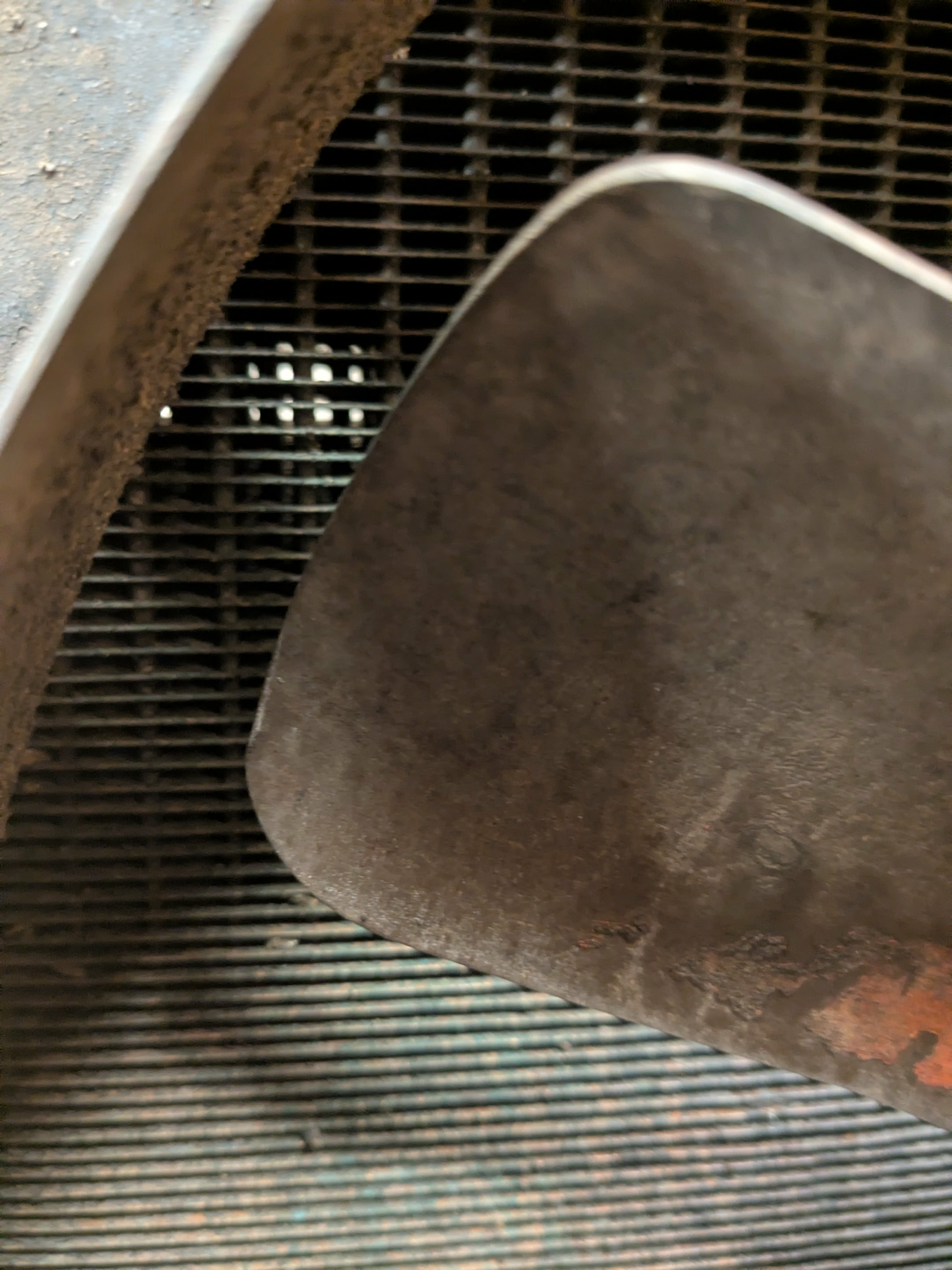

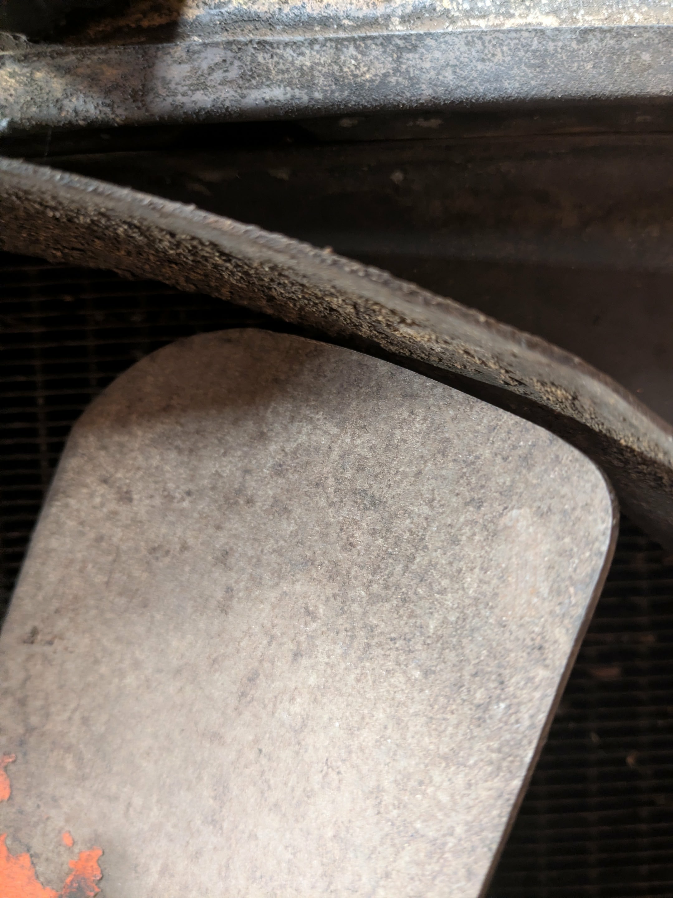

Got the new D15 diesel in the shop to make some repairs over the winter and came across something I have not seen before.  The fan is much closer to the radiator shroud on the right side compared to the left.  I can easily fit my index finger between the fan blade and shroud on the left side, but can barely fit a pen on the right side.  Same goes for the height of the rad - the previous owner put spacers under the mounts to raise it.  If they were not there, I suspect the fan would not be able to spin without causing damage.
Everything looks original:  Perfex brand radiator, 4 blade fan and appears to have the original water pump (brazed on one spot).
Would anyone have any insight on this problem?

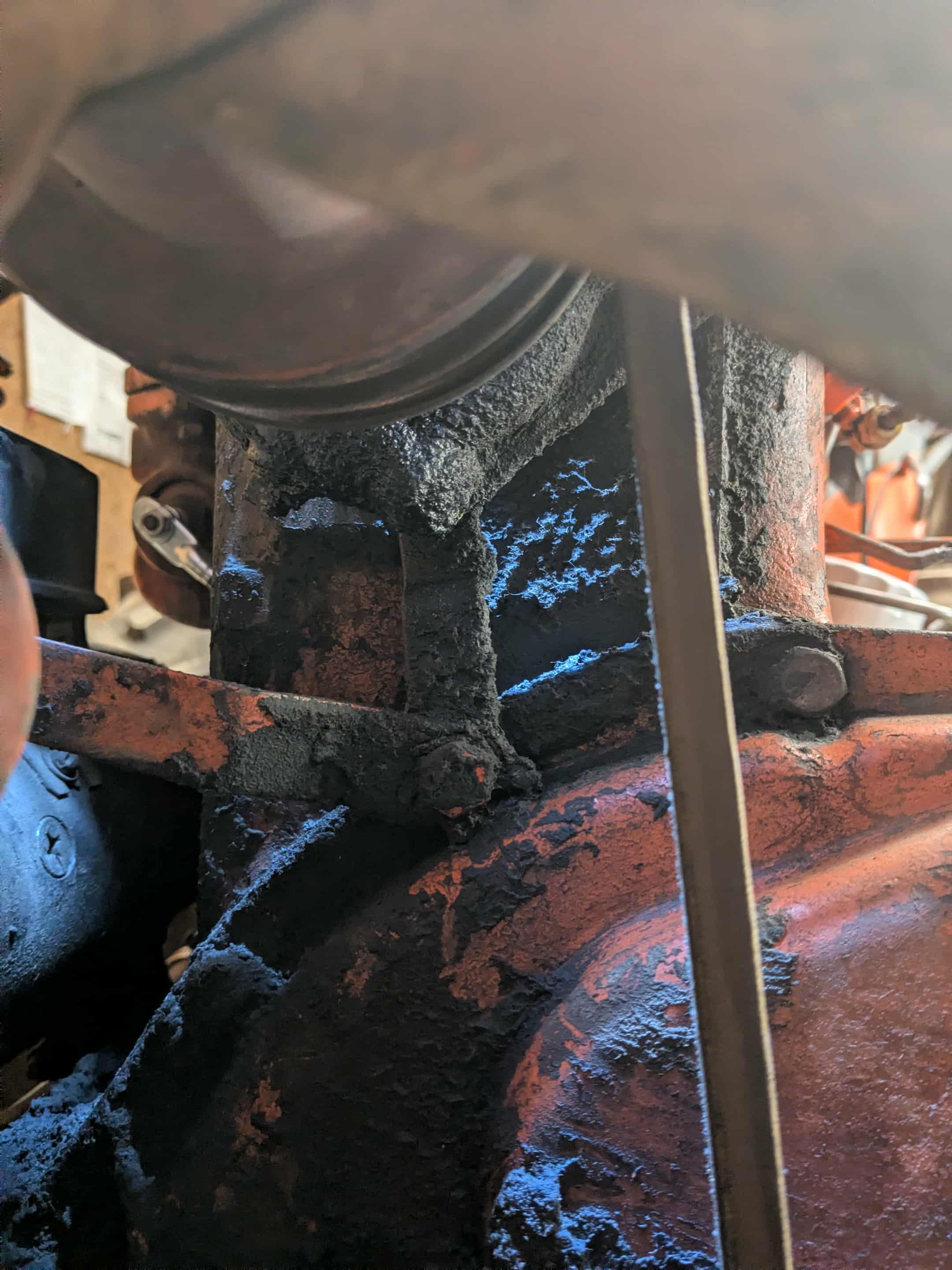

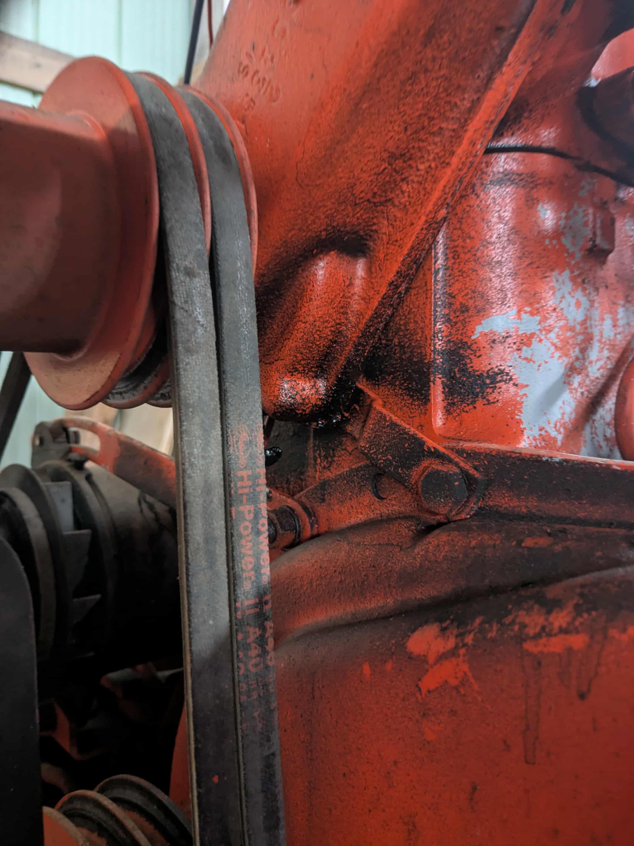

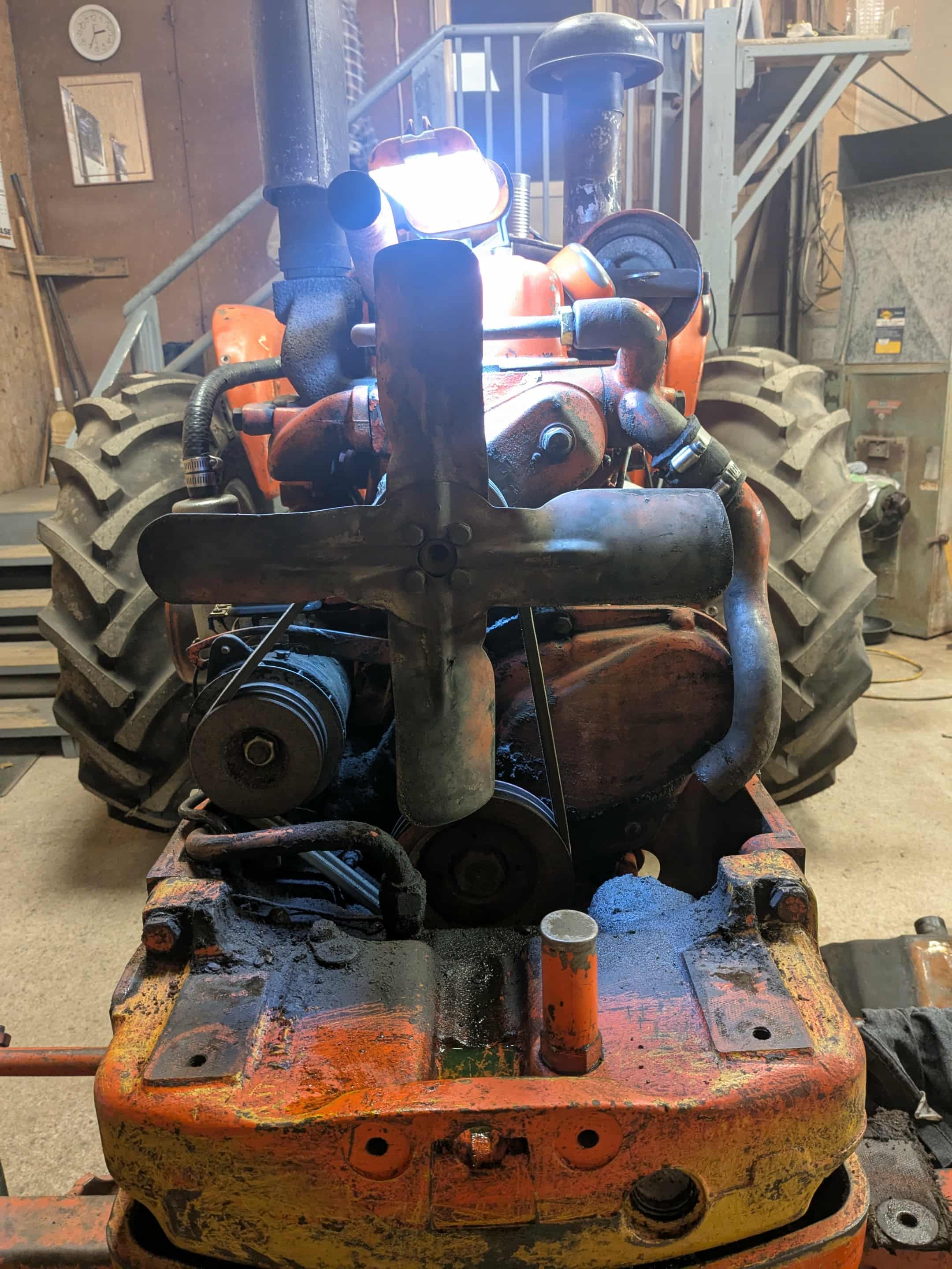

Problem solved!  Nothing wrong with the radiator.  It's the water pump!  The last person who put it on installed it incorrectly.  The bottom brace was secured to the wrong timing cover bolt, throwing off its location which caused the fan shaft to move up and to the right.  Who would have guessed?
I had to tear apart the front end of my other 15 diesel to figure it out, but it was worth it!  No major effort required to solve the problem!

Interesting, how to replace the leaking water pump, (I think) one would have to remove the radiator and grille shell to gain access to the water pump. So, after water pump replacement and upon reassembly of the radiator and grille shell, it doesn't fit the circle of the fan. The fix is to shim the radiator?? which used to be centered perfectly on the old water pump ??   Yeah. I guess that makes sense. Hope the tech went on to work at a Deere dealership.

Fortunately the guy didn't try running it.  The radiator could not even sit on the casting because the shroud would sit on the fan.
