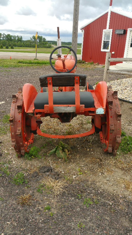

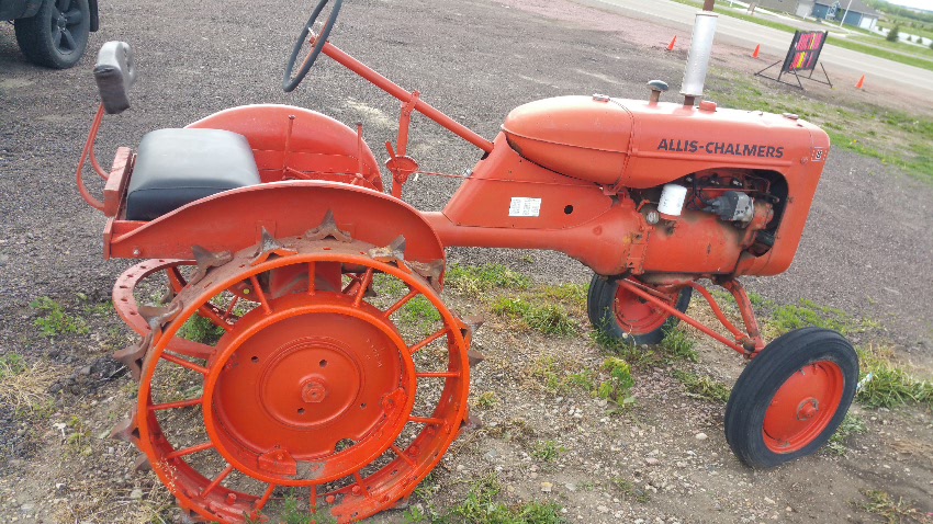

YEP... that would be pre- war. The wood on each side of the seat to space the fenders outward was not stock. You have hand brakes, no starter or generator, and the pre 1940 wheels on the front. Going by your SN, I think it really is a 1939.

Werent these suppose to have the big wide rear fenders? Do u think it came factory that way? The wood looks factory to me.

It looks like standard B fenders with steel rear wheels added afterward.... Those rims did not go with those fenders from the factory (  don't think).... unless the tractor was ordered special with steel wheels in 1939 (???) ......... that is not a "War B" with the wide fenders and steel wheels.

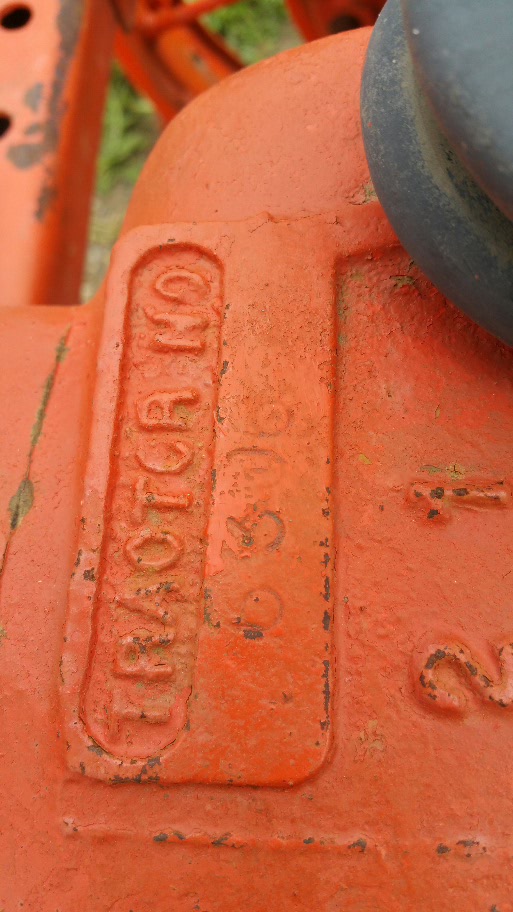

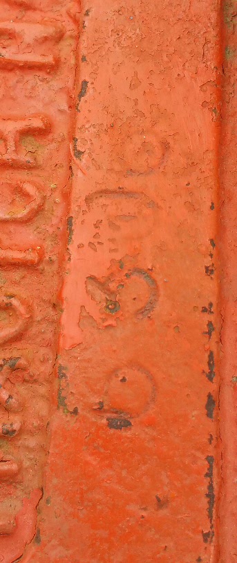

Hard to make out the s/n

I think a "war B" would look more like this ( not mine)... note the rear wheel hub design and the high air cleaner tube and wide fenders.

Yup thats what i think too. Must be something someone kind of pieced together.

6306 would be a 1938. Wood is definitely not factory.
Points: 87911
Post Options Post Options   Thanks (0) Thanks(0)   Quote steve(ill) Quote  Post ReplyReply Direct Link To This Post Posted: 23 May 2017 at 10:28pm
Lonnie is right.. almost 12,000 tractors were built in 1938.  Yours was one of them.

Steve (ill)
According to the 'Serial Number Reference' on this site -
the nearly 12,000 B's built was in 1938,not 1939, last serial 11,799.
6306 would be mid 1938.

Very interesting. So the conclusion here is that the wood is not factory, the rear steel wheels were added by someone, and the front wheels are correct? This unit would have came w rubber all the way around...

Lug nut hubs were added in mid 1939, around serial 24000, steel wheels were optional before the war.

It is entirely possible that this tractor was ordered and shipped with this wheel combination(steel rear/rubber front). However, the lack of the thicker rear cast hubs makes one think otherwise.

    More B trivia.   The rear wheel centers are 1938 vintage for rubber tires. 2 valve stem notches in a half moon shape, V shaped notches became standard in late 38 and most if not all 1939 Bs.
engine------ if cast in 38 the casting number should end in a 10.   The engine serial number 1n 1938  is hard to see stamped in rear of block. BExxxxx
   Seat back support straps are wide version Correct for 38
   a fabricated welded clutch peddle is correct  for all but very late 1938 Bs
  Steering wheel in not original 1938.    All black hard rubber covered all over would be 38
   Restoring a 38 back to original  using all 38 vintage parts is a serious  challenge
