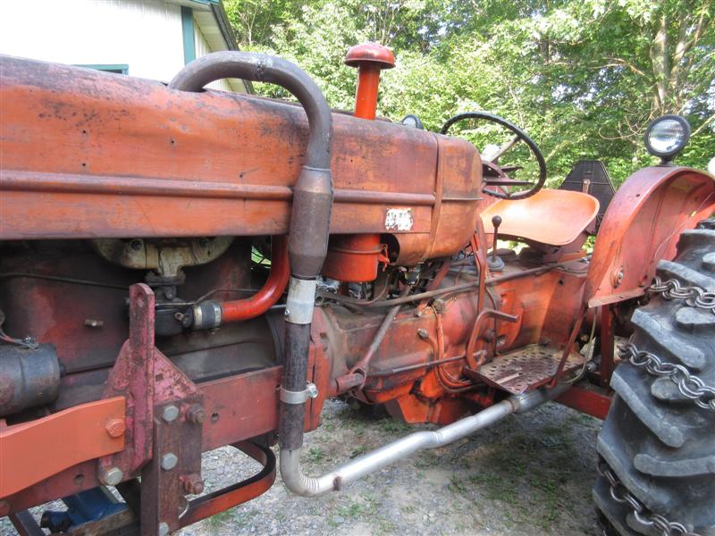

It ain't pretty but I ran the exhaust out the back on my series II D-17.
I had to get rid of the above hood muffler as I am always bush hogging under low hanging branches.
