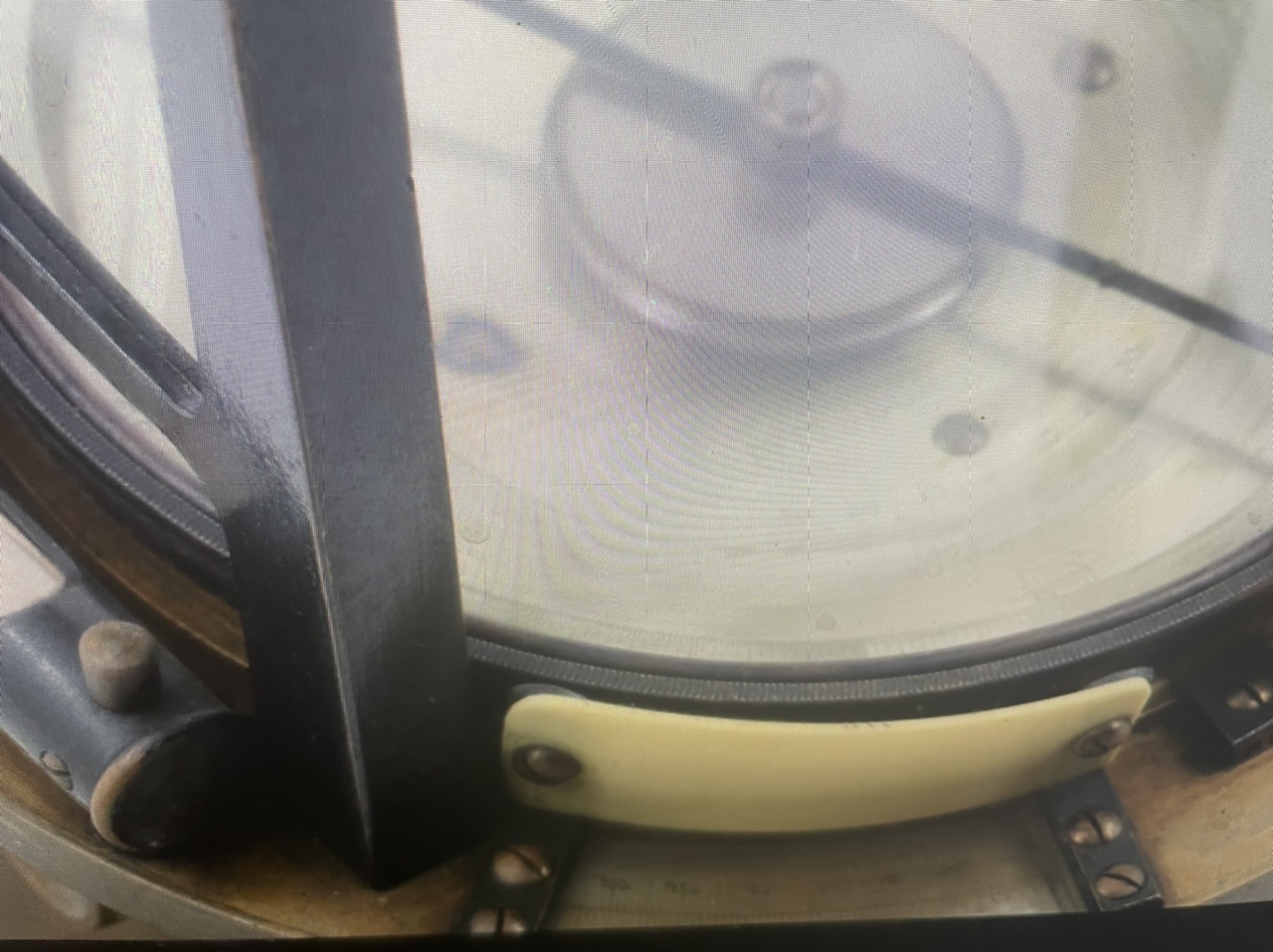

Maybe, just maybe you should look at a transit, then you'd understand how you can make a curve.Wink
I doubt this will help but hey it's worth a shot, this is the base of a fairly old vintage.  The confusing part would be one turns to the left on one side and one turns to the right on the other, but that starting point is still that same straight line.Wink

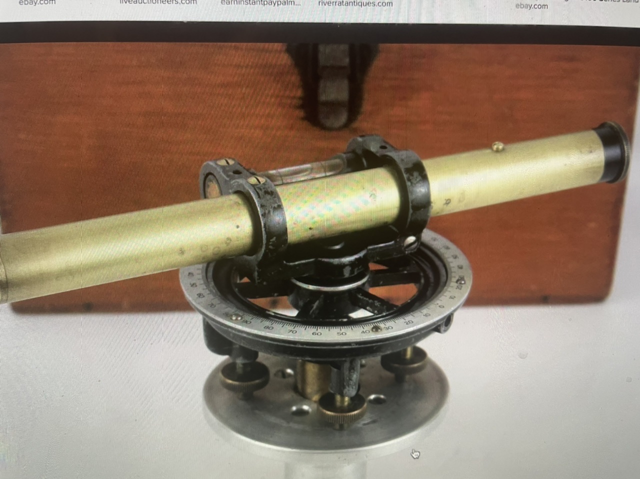

Here you go Freed, this is a much cheaper version of the same thing that would also make that same curve. This picture shows the obvious way it’s done with a transit. It’s all about those degrees, kinda like those minutes of angle on your rifle scope.
